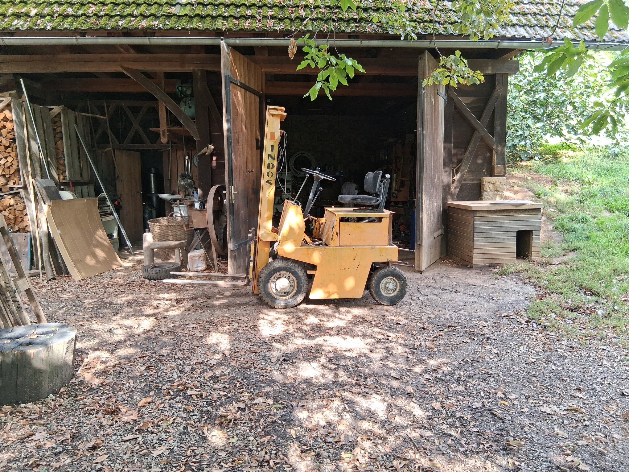

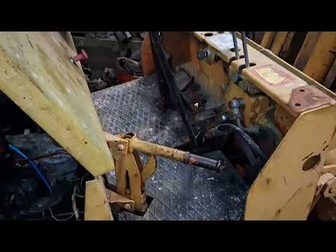

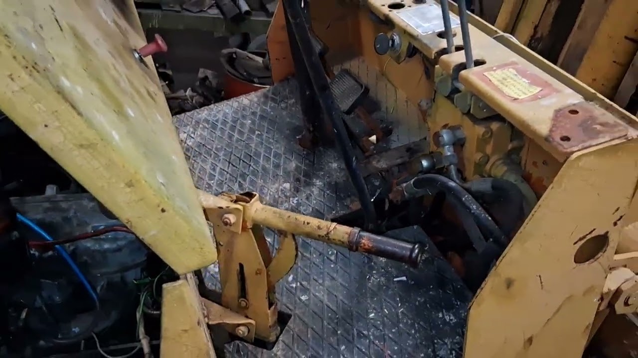

It’s a rainy week here too, so it’s perfect that I got time for this little forklift from 1976. It was necessary to "renew the brakes, clean the carburetor, adjust the ignition, … and many other things, … This is a Slovenian product, the gearbox is mechanical, the clutch is regular, the engine is a Fiat 1500 license made in Yugoslavia - the Zastava company. It has been standing for more than 20 years, but it started without major problems. The weight is missing at the back, which I did not install, I intend to install a different weight, …
Sorry for peeking at details but I couldn’t help noticing the wooden joints that you did not have to go to the hardware store to fasten. :joy:

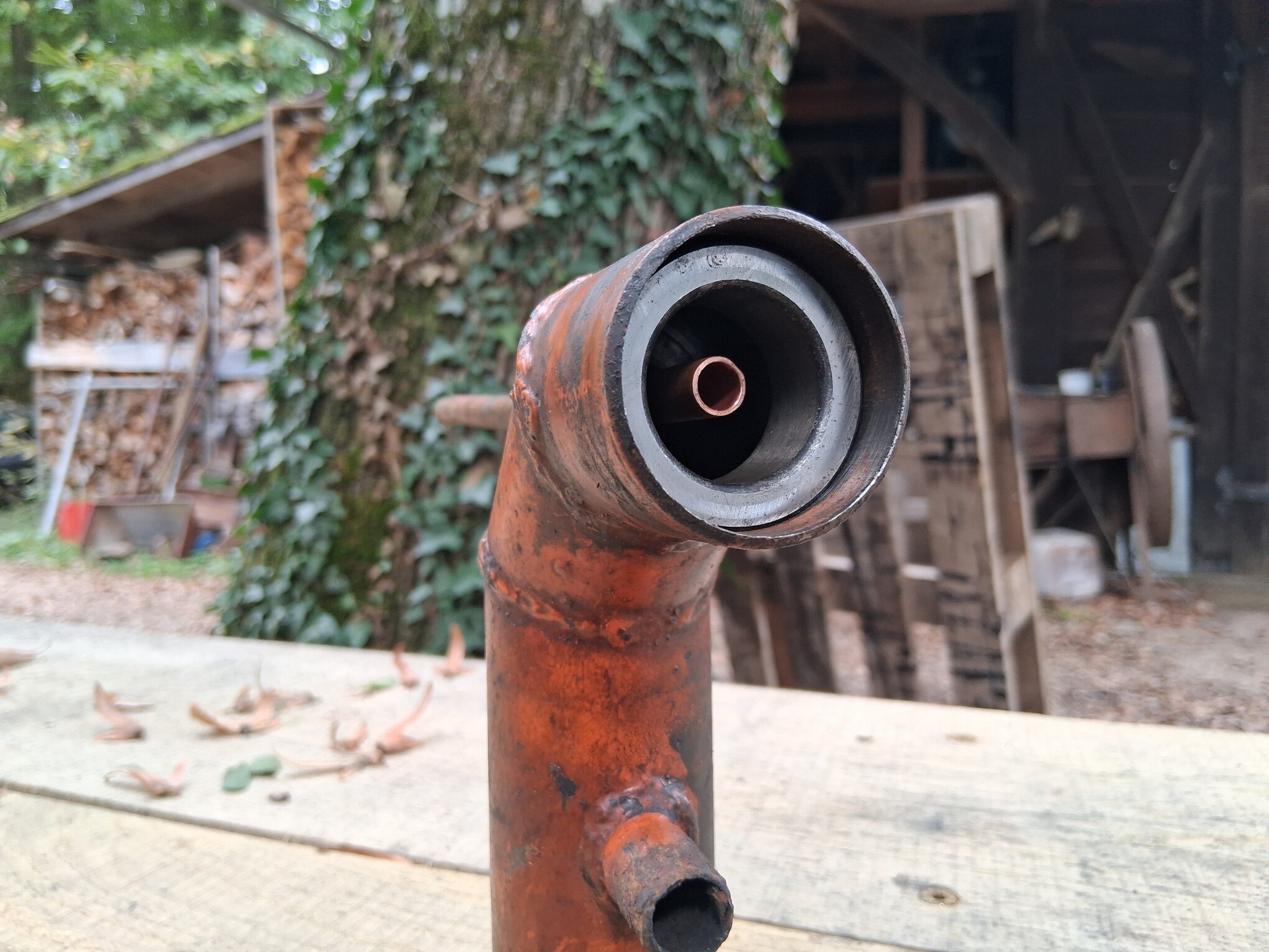

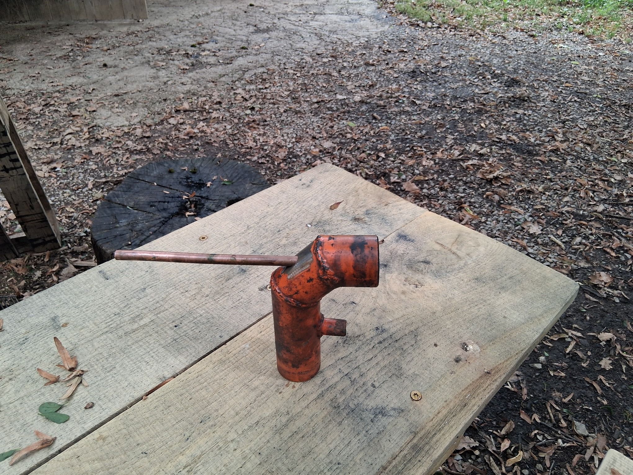

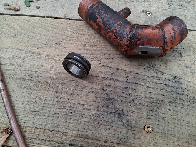

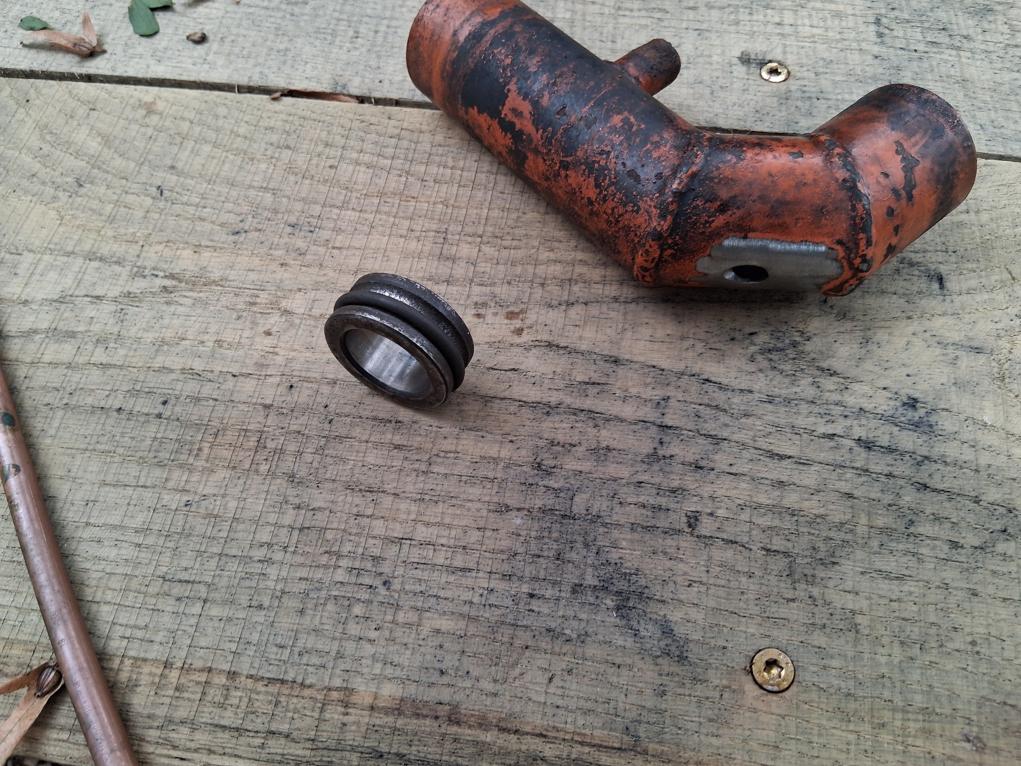

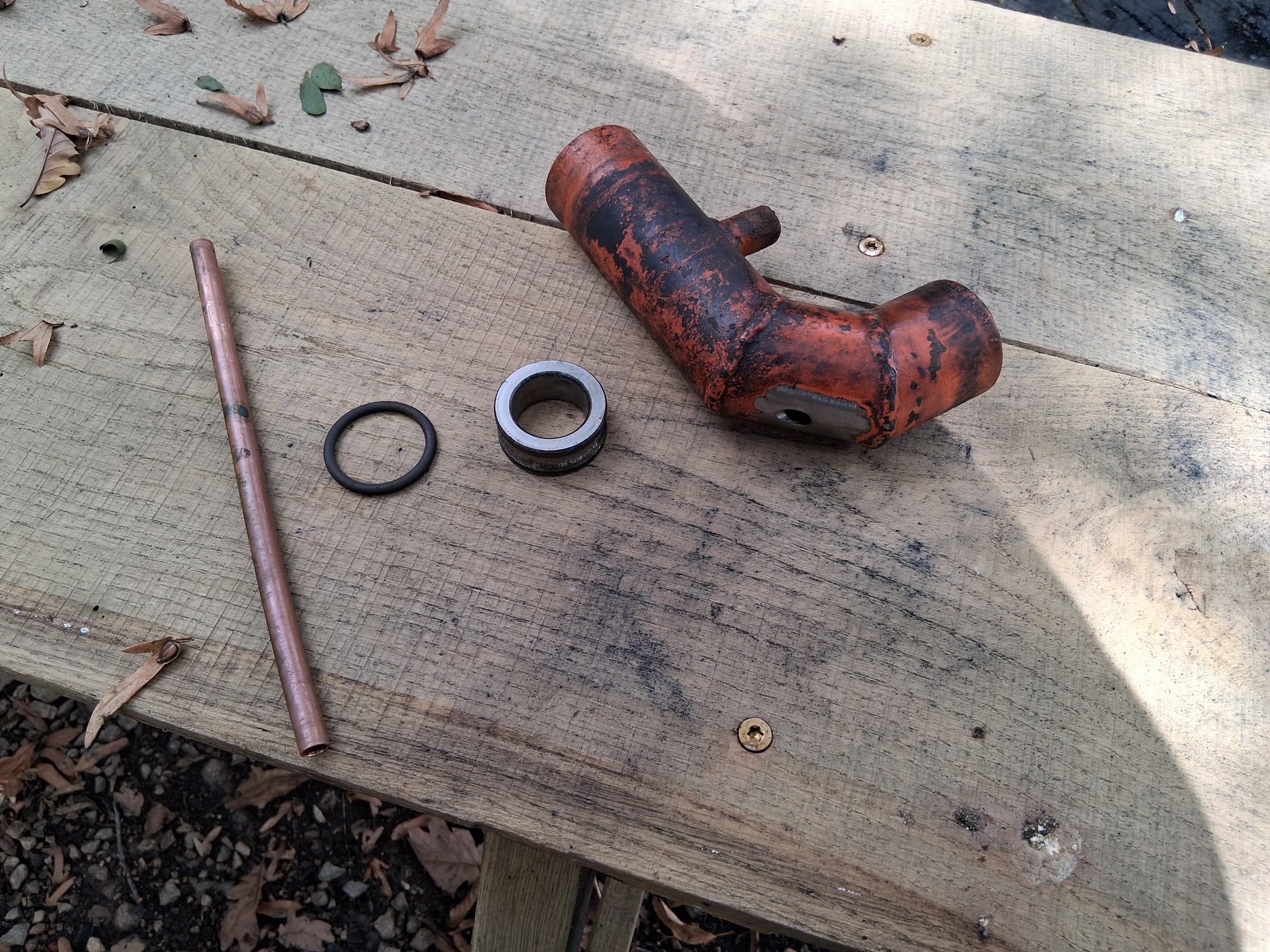

First, the propane mixer…
I used a 30mm inner bearing, an O-ring seal, an 8mm inner copper tube, a 1:15 mixing ratio…
Surprise. I thought it was a charcoal nozle
LPG, you make things looking easy😀
Joep, wood is next, I plan to build a gasifier on the back, there will be no need to save weight here, as it needs weighting.
This will be a rather interesting project, the cooler will be easy to install, it is easy to use the exhaust gas temperature, the gasifier will be mounted low - easy to fill and clean, there is relatively much space near the engine,…
I plan to expand the hydraulics, so that there will be another output to drive the log splitter, … well, in short, many plans, … I have to open a new topic,…
Well it likes that kind of gas. Now comes the charcoal gas from a gasifier.

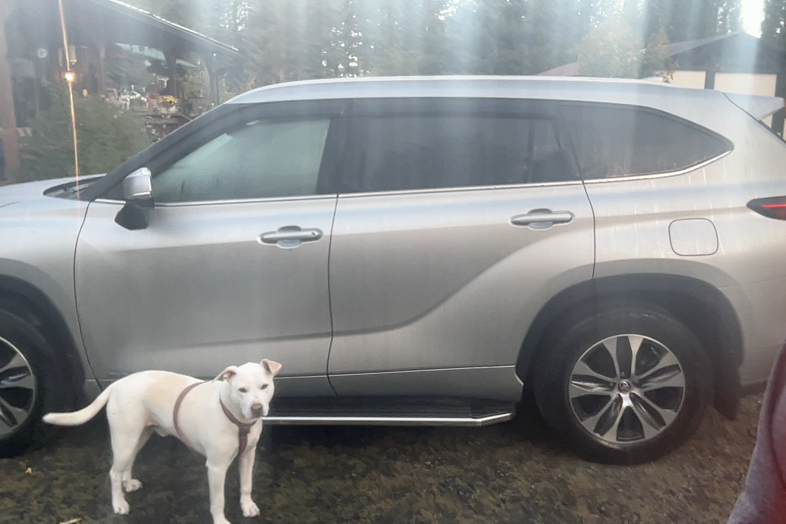

Ha! Ha! Here I will show you the ONLY Wife approved duct tape repair of mine in our 33 years of marriage:
The good undamaged side.

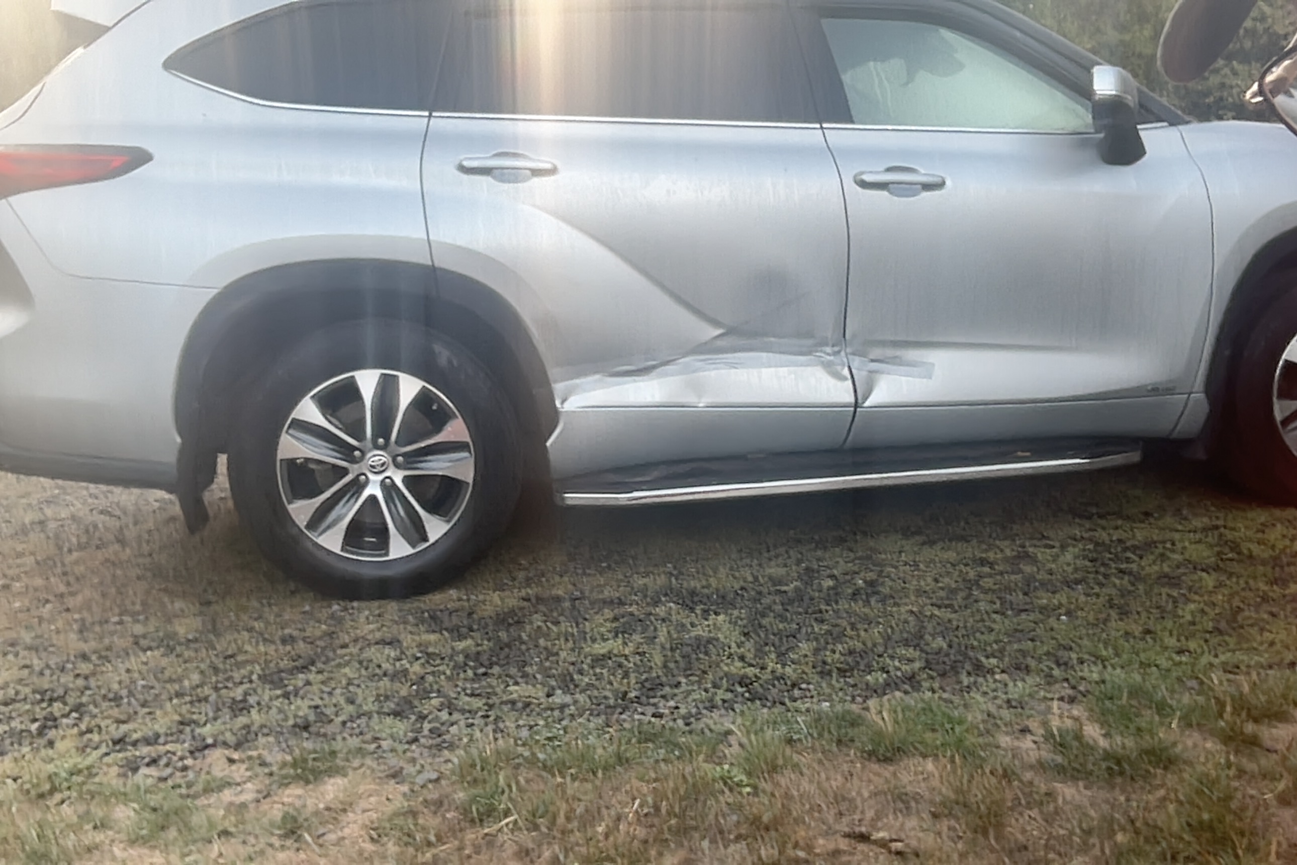

Then the side wife-darling creased split 11 month ago, two week after acquiring this vehicle; her miss-negotiating a tight fast-foods drive-through:
Yep. Yep. She over-focused avoiding a protruding sign on her left side and a ground mounted very stout sign on her right side reached out and bit her! She got Titanic’ed. At her next grocery store stop, when she saw the extent of the damage, she sat down and cried. Then puked.
I did a better job of this year taping/sealing. And used a better “Extreme All Weather” tape rated for “Exterior Projects”.
Why not get it repaired? She really, really should not run another claim through our Insurance company. Be the fifth in 10 years. It will tag her as a not-good-driver. And that will affect the rates on her own, mine and two other vehicles.
Plus she and I are abstinent, insistent that our vehicles are our working American Life tools. Not outward icons of our wealth and success’s.
Tools used, do wear and get used up. On road vehicles are for-sure your armor to protect you against all road hazards. Wear your nicks, scratched; dings and dents with honor.
