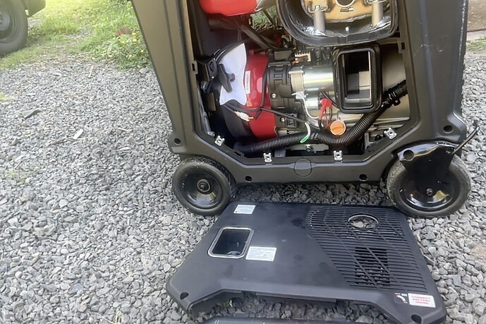

I finished up my stuffing a larger common group U-1 battery into our biggest inverter-generator finally today.
The small undersized more expensive motorcycle type one it came with, has died now in it’s 3 year.
I can pull start this unit barely on good gasoline once I modified it; dropping the pull handle down to the engine for a longer full torso-twist pull:
The wife must have the electric starting. I’ll need that too when operated on woodgas also.
Lots of plastic had to be cut away and pieces removed; to make room for the U-1 as the 2nd picture shows. No way to make the bigger U-1 internal hidden. I tried and tried. Had to extend outwards.
Then a careful cut and knife shaving job to get the sound and directed cooling flow cover back on:
It’s actually now tied down and plastics cut in for a tight, stable fit.
One thing on these enclosed quiet inverter units is the outer cases and panels must restrict and direct most of the drawn in air flow first past the inverter-electronic package.
Operate open; and the wattages you are asking worked, you then will overheat the inverter. it will fail sooner, versus later.
I like how tidy it came out, but curiosity has me: why not a cable connection through the side cover and a remote battery? Just to keep that critical airflow moving correctly, seems it would have been easier to gasket a bulkhead connecter
Yeah. Building an external front mounted battery box would be the more sensible way to go alright. What I’d recommend now.
Donno . . . I had convinced myself that I COULD remount it internally. Then once I started carving way plastic . . . you know . . . stuffing a small block Chevy V-8 into a small Toyota pick up, eh.
A fever or a fervor I guess. Some of the red on the cardboard is knuckle blood spots.
I think I can. I think I can. I DID IT! (Kinda, sorta’).
Paint the top half of the battery red but as it is looks pretty factory to me. Nice job.
Ha! Ha!
Instead I will be making the red plastic side panel more black.
I am not happy with the positive and negative battery terminals, outside, naked. This makes me afraid. The wife with metal broom handles . . . The two still squirrelly, 10 and 11 yo girls . . .
So I’ll be farming out a crescent section from a tire side wall and riveting on as a liftable (for jumping access) rain-flap safety/bump-guard down over the batteries top.
Also I am still looking for brass wing-nuts; or finger-able knurled nuts for the terminals bolts.
I really want to paint the whole thing a mottled flat dirt brown. Ugly-fi it; for theft prevention. This is actually half the wife’s bought and paid for. She takes unkindly my “improving”, make-disappear ideas.
