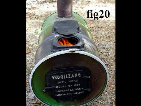

Question about SECONDARY BURN. I have made charcoal with a TLUD 55 gal drum. I put two pieces of rebar on the drum and sat a hollow drum on top to increase SECONDARY BURN. So I have seen it, and done it, but I donāt understand it. So maybe to avoid long dissertations on theory Iāll get right to the question.
I have an old used double 55 gal drum wood furnace / burner. I am thinking about rebuilding it with new barrels. You know how one barrel sits on top of the other and the two are connected with a short piece of 6" stove pipe. If I put holes in the 6" pipe can I get a secondary burn in the top barrel?. TomC
Tom, the bottom barrel might have too much air. But maybeā¦
So you are saying this only works with incomplete combustion? If I see smoke coming out of the chimney does that mean I have incomplete combustion. If I add holes in the connecting tube will it ignite automatically from the lower burn or do I have to add ignition to the secondary air? Sorry, but I just havenāt gotten my mind wrapped around secondary burning.TomC
PS Also having trouble with ārocket furnacesā not ārocket stovesā Later subject.

This build is still very confusing to me. They put in a smaller burn chamber and then they insulated all around it, I presume to keep the smoke hotter until it gets to the secondary air. And then the chimney is so close to the secondary air that it seems to me the heat would go right up the chimney, with very little contact with the top of the larger barrel.
With the old burn barrel system, you had a larger burn chamber and heat would flow through the walls of the burn chamber. I believe we get a lot closer to complete combustion in the first burn chamber ( for this new way to work you have to hold back on air and create partial combustion in the small barrel ). The second barrel of a two barrel, is just taking heat off the exhaust that would have gone up the chimney.
Thanks again. I am always interested in new ways but my ābullā head gets me to pass on some that I probably should have given a better chance.
Tom, I think he is storing some heat in the sand and maybe easier on the barrels. He also builds a smaller fire. He also said you can add the second barrel on top. Also two places to cook on.
I gotta go plow snow nowā¦
Tom, I would call that more of a continued burn as well as a secondary burn. The air in a TLUD comes from the bottom and is limited so that it it creates an oxidation zone that moves farther and farther down the barrel and gets used up in that process so there is not enough oxygen left to burn up the charcoal that remains near the top of the barrel. The unburned products of combustion rise through the glowing charcoal and exit at the top and would rise uncombusted unless the top barrel is there with added oxygen and heat containment which completes the burn and produces no or little smoke.
If you lay that on its side in the case of the barrel stove, the fire will migrate to the loading door and burn everything up as it goes toward the chimney pipe. If you add air holes back there you might not do any more than reduce the draft. I tried that once with mine by opening a one inch bung hole in the back upper barrel that happened to be located right by the 6 inch barrel connecting pipe. I thought I might see some secondary burn there but there was not enough energy left in the smoke to burn again. Thatās my 2 cents worth and maybe thatās all it is worth:grinning:
