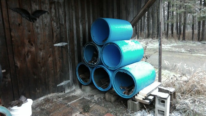

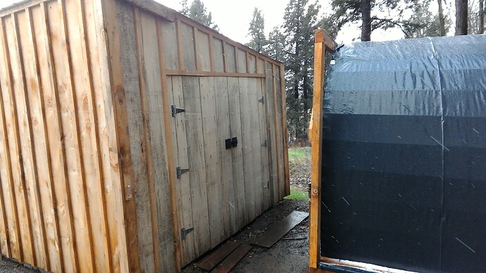

Got my first 55 gallon storage rack built ! ! Snow tends to blow into the barrels. Any ideas for doors?

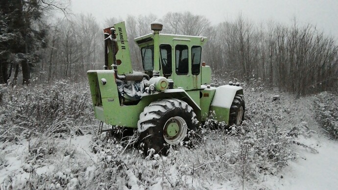

Jeff that looks like you will be busy for a few minutes. Reminds me of my case 5240 i need to split and rebuild the transmission. Between the two of us we have one good tractor as my Cummings motor still purrs line a kitten. Not sure but I think mine is a spring project. I still have a pile of logs to saw and a barn to repair so the cows are out of the wind this winter… tomorrow I hope to do the cement block work on my barn we are still getting some warmer days and not snow that has stayed yet…

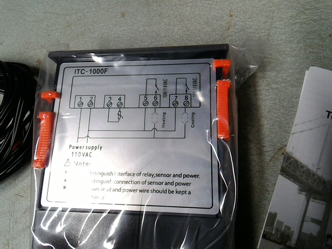

Brother Jeff, I would like to know more about your $12 controller setup. Perhaps a link and diagram?
It is an inkbird. Rather common, no PID circuit just △T. I’ll post more later.
Here is a link.
http://www.ink-bird.com/products-temperature-controller-itc1000f.html

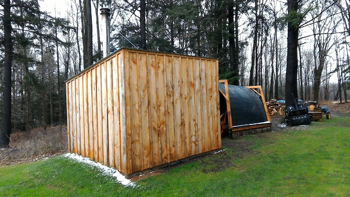

For open end covering these I’d just use one-two plywood panels propped up with some Tee-posts angled out.
10 years or more ago I started buying 4x8xthree-ply green-treated ground burial plywood sheets. Bit expensive. But they never de-laminate. None in ground contact has edge rotted yet.
I’ve turned these in to many screw-gunned togather temp projects. Wedding temp dance floor! Yard wedding wheelchair walkways. Shade cover for the chickens. Snow and rain covers for the chickens. Wood stack coverings.
Actuality hurts my poor cheapskate heart to cut one up for a permanent install usage.
And even year around left out wet soaked heavier, I am able to trundle these around for another needs re-use.
I also stocked up on some re-useable aluminum Tee-post fence corner/building clips. Also spendy buggers. $1.35x3 to make a single joint.
Ha! Four green-plywood sheets and some slammed-in Tee-post clipped togather and you’d have a temp weather cover for your equipment repair. Enough screw made edge of panel holes now to quick electric fence wire the panels onto the Tee-posts, held into place.

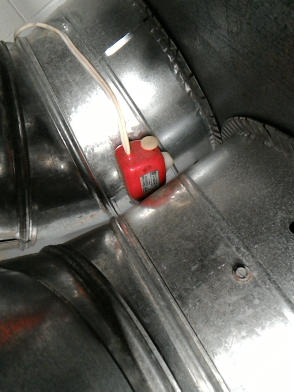

I installed another inkbird in the basement to monitor over temp warning last year for the old boiler but still kept it for the new one. I used an old viberscribe layed on the return duct for the buzzer. The air duct transmits noise somewhat through the house.

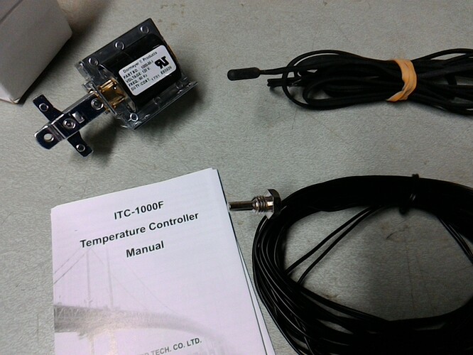

Inkbird comes with a button style probe but didn’t work well when taped or insulated with rag onto the pex tubing but worked when taped and wrapped with tin foil. This is for alarm.
Getting back to the boiler. Wiring diagram on inkbird.
As a side note I plan to use an inkbird to monitor the temperature of an alternator for my super capacitor inverter generator, when I can get back to that project.
I was going to make a well for the button style probe to insert into the boiler water but found the small well screw in style on Amazon. I think it is 8mm bolt thread so I drilled and tapped a pipe plug. The inside of the plug I drilled at a larger diameter to allow more water near tiny probe. Made seal washer and also taped threads. Theo the item is the solenoid that lifts the flapper that is an exhaust rain cap.
According to the specs inkbird might have handled the current draw but I installed a relay just for the heck of it.

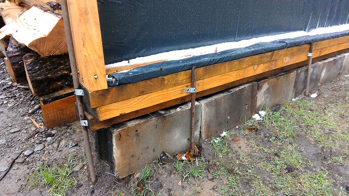

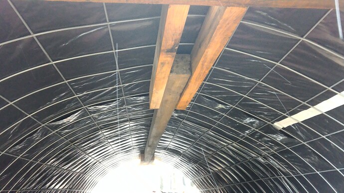

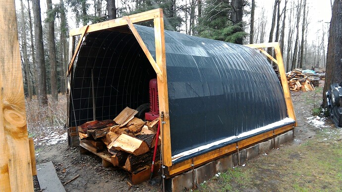

I gave Dad my three cattle panels and the idea of using blocks and a stack of 2x6 for the foundation. I think He did good. Store a lift of wood and tractor in front of heat but.
He thought I was nuts when I mentioned cattle panels!
I guess that is about it.

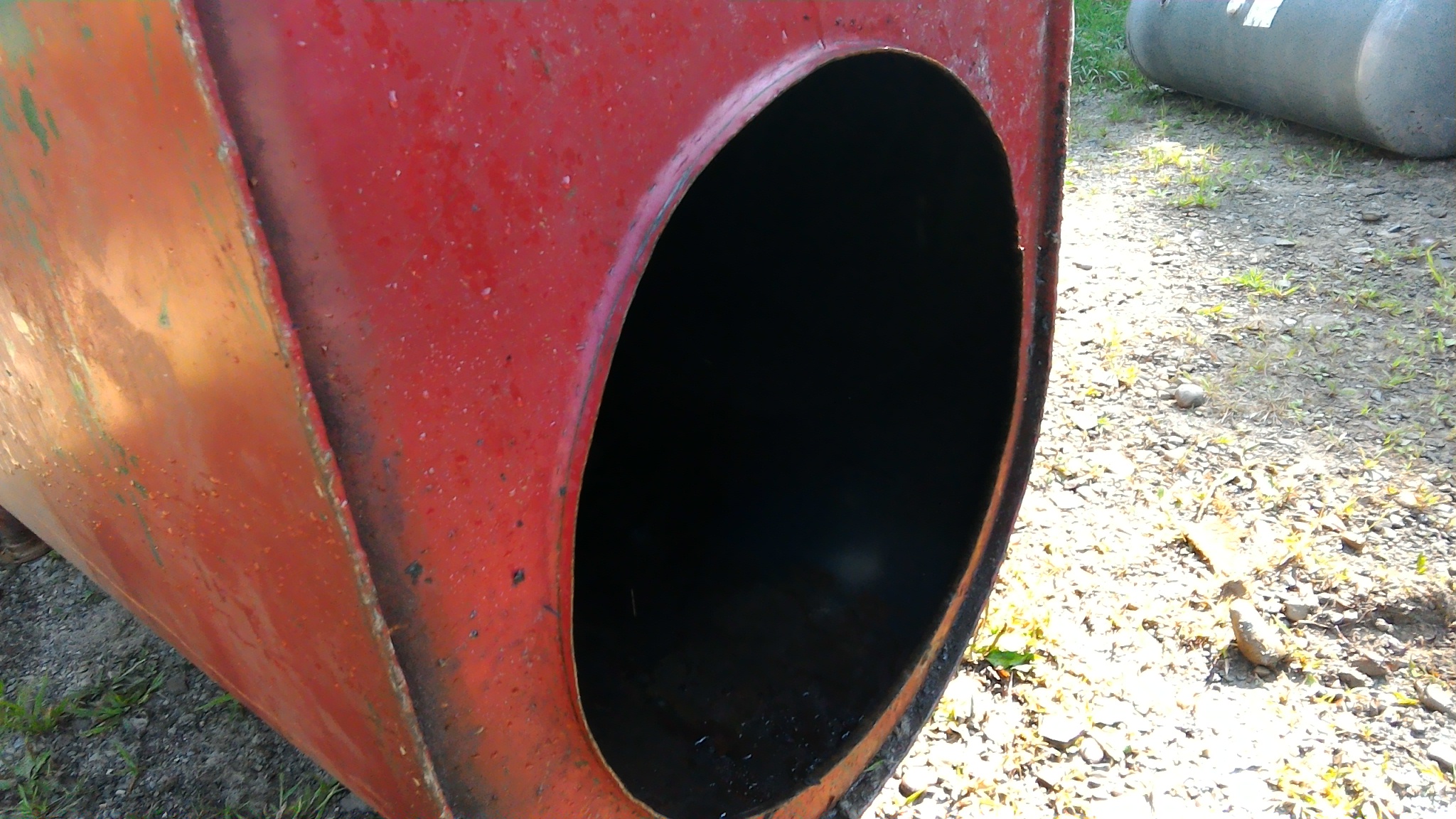

No, not the end. I forgot my welding trick. I need to dig up a photo later.
When I cut the holes in the fuel tank to allow the water tank (where the fire is) to slide in, I cut the holes about 1/4" smaller. Next bent that extra material out thus forming a lip. This lip allowed adjusting the hole diameter to the inside tank diameter and gave more metal to weld to.
That is about it.
