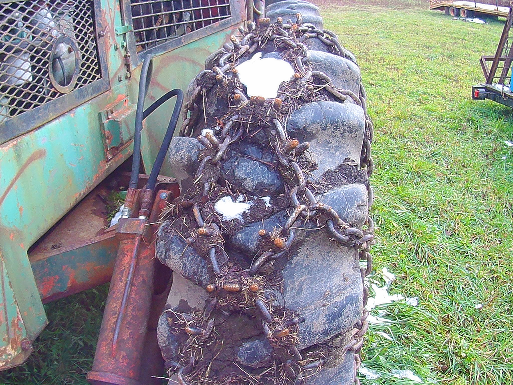

Invest in lots of sand? I actually would have thought those metal cross bars would have been sharp enough to bite in. I haven’t worked with tracks but around here we use 4wd and Canadian ring chains.
https://canadianchainsusa.com/Gallery/Category/1325/
Maybe you could weld on some angle iron spikes based on the first photo in that link? Those chains will climb through anything including pavement…

@Jan, these are considered ice chains in North America.
And check these out.

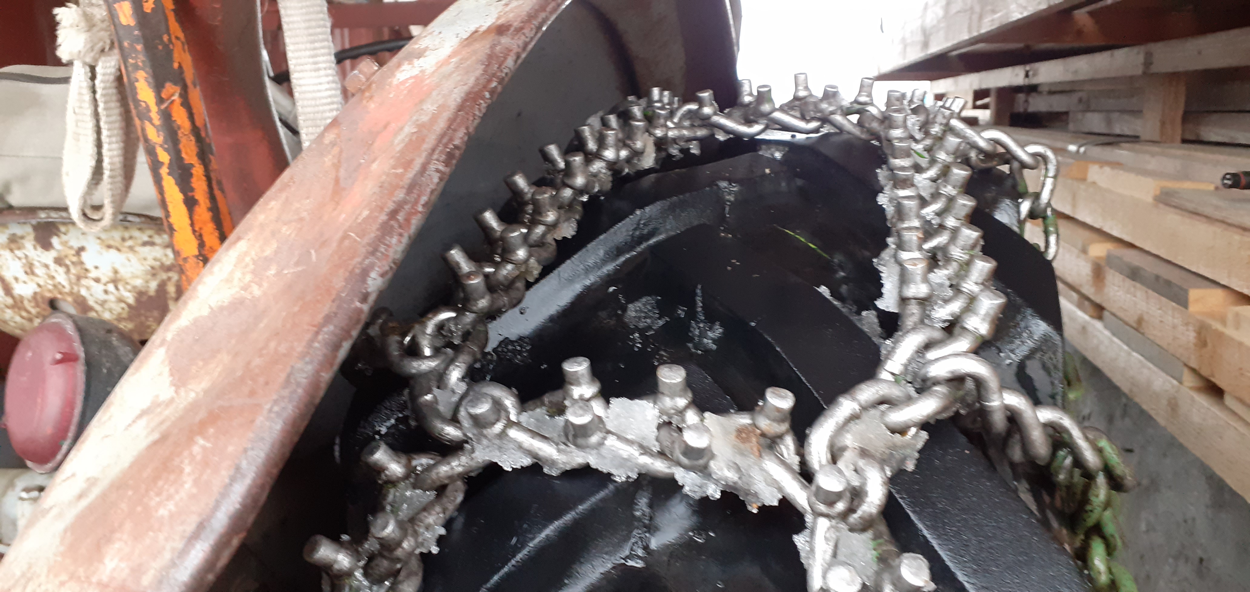

@Jeff these are considered ice chains in the Nordic countries :smile:
