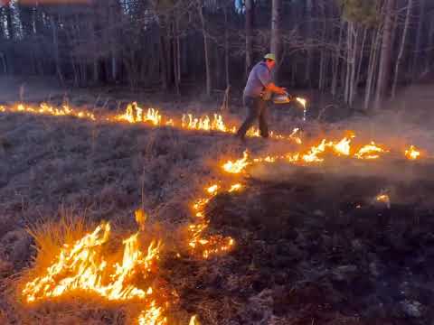

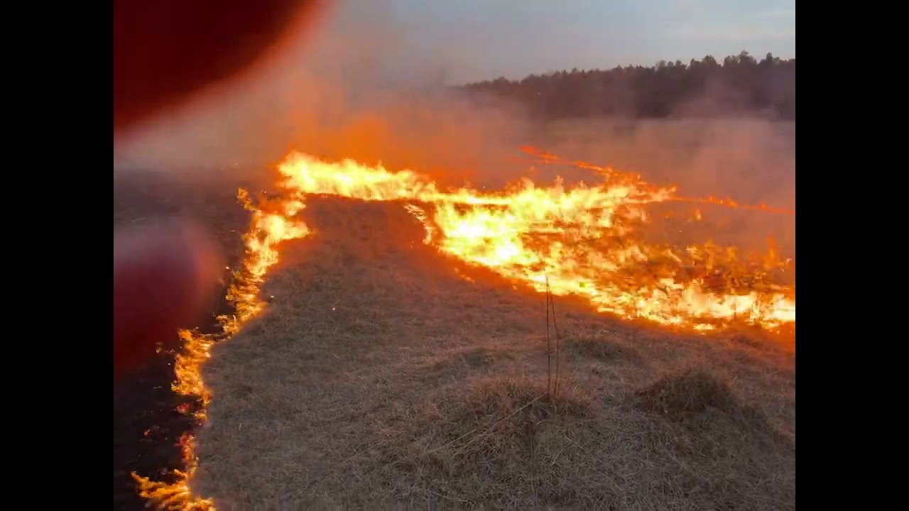

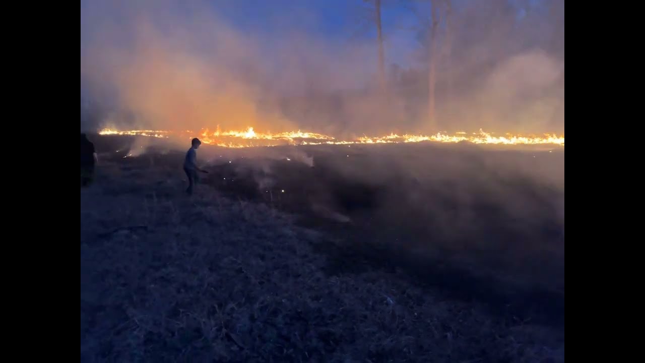

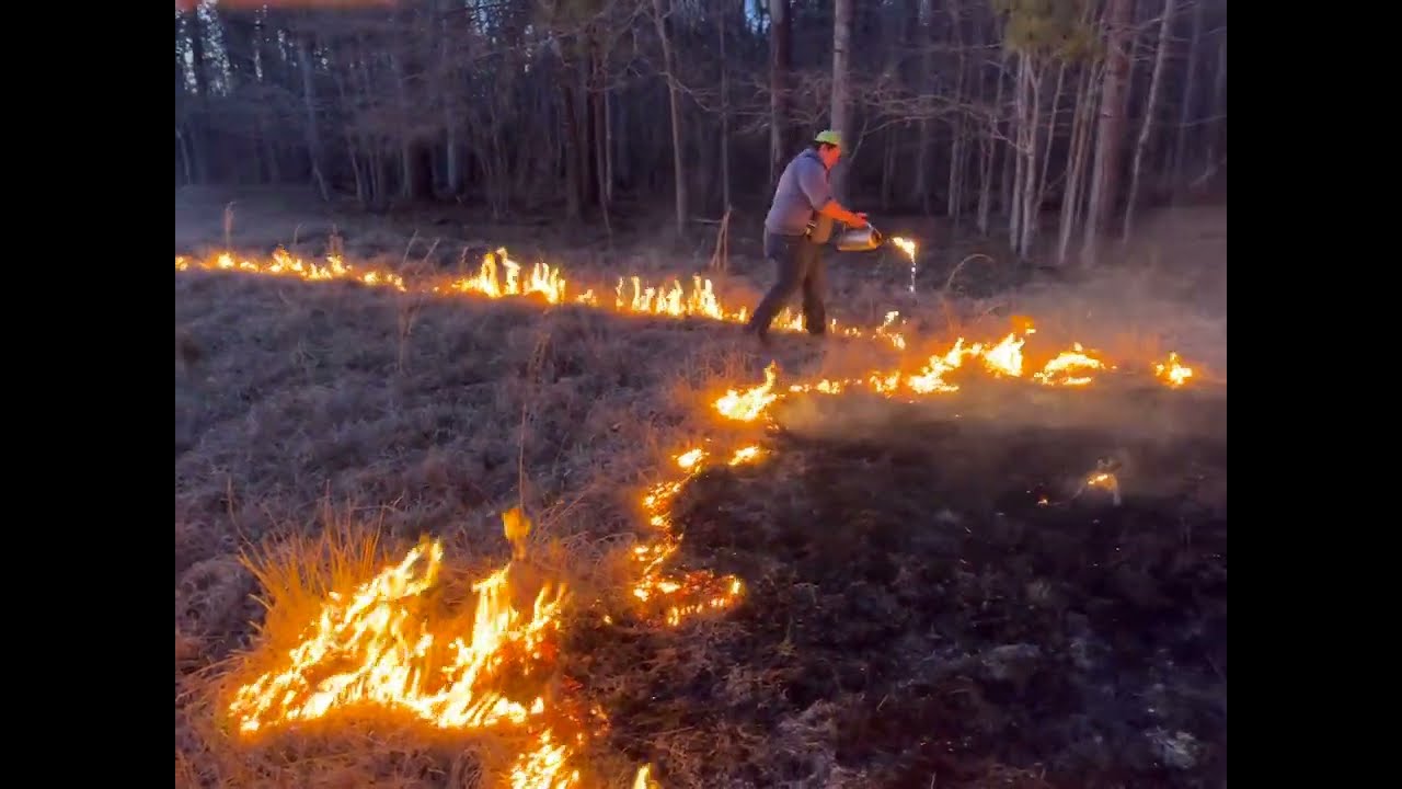

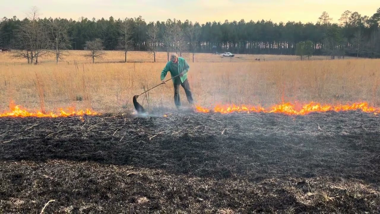

Establishing fire breaks so I can burn off my pasture .
My son showed me how to use the heat to create a chimney effect and draw air in at the outer base of the fire for easy control making the fire break.
Very easy to stomp or whip out the perimeter while the inter part of the fire will quickly burn the fuel leaving a 20 foot fire break .
After the break is made we strip burned it which quickly makes the brakes wider .
