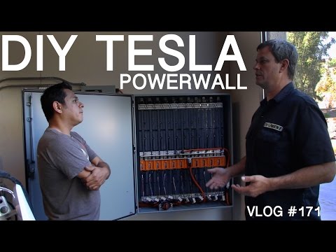

In the video below they used tesla packs to build a storage bank. The coolest thing is they use a standard inverter to charge them.

Thanks for the link I have watched him with great interest.

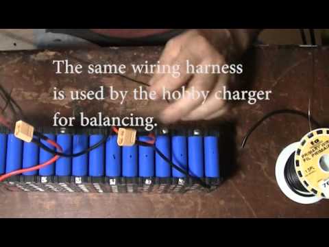

I have built a battery back from “dead laptop batteries” normally the circuit board in the thing is dead or one battery dies and the BMS then stop the operation.
I started looking into “dead” laptop batteries just the other day. I was just wondering how you have done at locating batteries and what do you think your typical cost per cell out of pocket cash not time and effort actually is? I have a few different things I would like to try both small and larger scale and I don’t know how to estimate the cost. Right now money is tight and I want to focus my efforts where I will see the most return.
The first thing you do is goto local computer shops and ask if they have any dead laptop batteries. I took a couple plants that I grow over to a guy who did and I got 30 batteries. I also told all my friends that I am looking for them.

This is the group in the video I posted. Once you watch the video you will know as much as I do about them. But the list tesla packs with low mileage.
