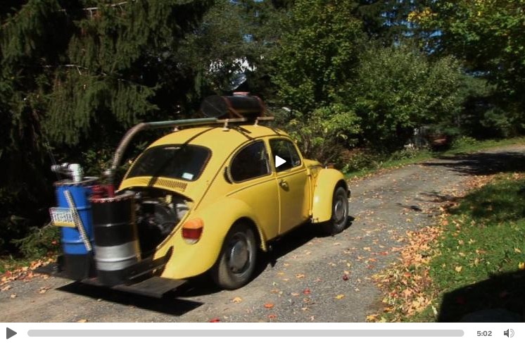

Take your VW and mount a Gary Gilmore Simplifier on the back. That would be a 20 gal grease barrel with a intake in the bottom and an out port in the top. You load the barrel with charcoal and your are good to go. You can make it more sophisticated by running the exhaust to the intake port for a controlled burn and a simple filter for longevity of life on the engine. Done deal. TomC
Something like this?
yes, this is a picture i had in my mind! :heart_eyes:
It isn’t that i can’t build it - just getting a museum started in one year doesn’t give me the luxury of time to build things like this. Hence my interest in buying/loaning.
It should be noted that one needs REALLY high quality charcoal for engine applications. Stuff out of a bag, even the “cowboy”/lump stuff might have some residual tars/unburned wood in it that can gum up an engine.
Gordon Ooghe ran a VW engine with his wood gasifier. Yes, it’s a big unit for a VW car, especially when the engine is in the rear. The possibility of powering machinery with this engine setup is there, however and would be a good demonstration to spark the enthusiasm for gasification. Check out his run here:
Pepe
This was my initial thought too when I first read about the “simplified” method. I’m sure it has its appropriate place, but I wouldn’t dare use it especially as a first build.
Building both a “SimpleFire” and a quality charcoal kiln are both far easier and less complicated than building a single raw-wood gasifier that makes appropriate clean gas.
For this reason, charcoal gasifiers ARE generally the first step one takes.
The main catch is that one loses a fair amount of BTUs of energy converting wood to charcoal. One either makes a way to make use of that “lost” heat (hot water, pizza ovens, etc.), or counts the loss.
