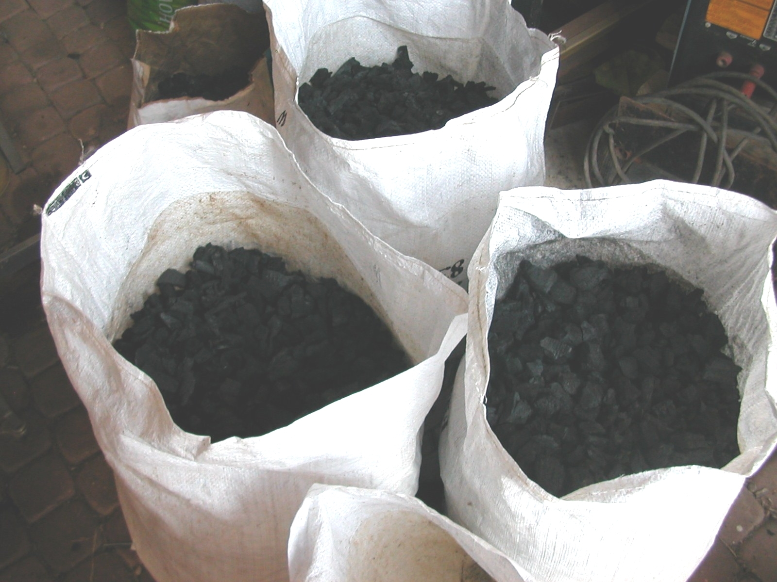

For immediate use, getting the char wet would not work. In my case, we have had years of drought and very hot weather so once the charcoal is sorted, screened, dried, and run through a charcoal grinder, and then stored for years, it doesn’t seem to know it was once wet. My daughter was here last week for a visit, and was amazed at the amount of charcoal in bags in my barn. (Yesterday I was loading my 182nd 55 gallon drum with dead limbs to be made into charcoal.) I store the finished engine grade charcoal in sealed barrels, and on very dry, low humidity days I remove the barrel lids (and leave them off for a while) to see if any water vapor wants to escape. A freshly loaded barrel will have some condensation on the bottom side of the lid. Most of the white plastic feed bags in storage contain sorted/sifted but unground charcoal. Most of the bags have a note inside with the date and type of wood, such as Mesquite, Oak, or Mixed. Here is a photo taken about 3 1/2 years ago.
Wow Ray, I quit counting back when you were at 150 some barrels. You are a mini OPEC (or CPEC):grin:
