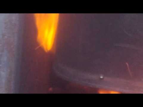

well with the heating season upon us I decided to give more effort to using a retort/ stove combination for heating and charcoal making. I have used small boxes in my inside stove but I want to be able to make larger batches so that means a bigger stove so therefore outdoors. early days but here is a short video.

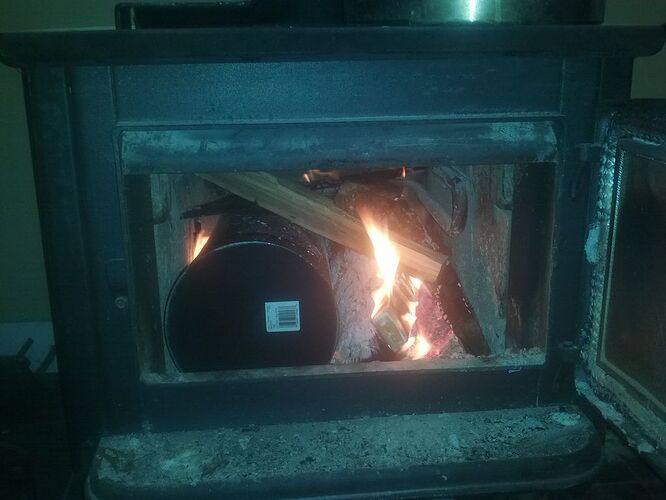

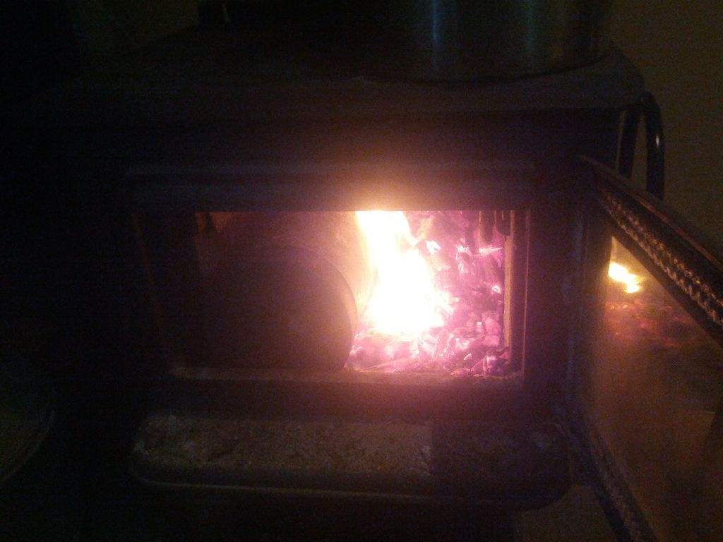

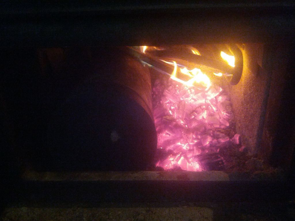

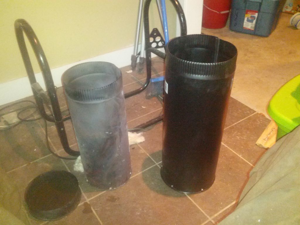

I’m trying out the new retort today. A continuation of my off the shelf nature this is two 7" stove pipe caps and an 18" section of stove pipe. One end is tap screwed on the other removable via the factory crimped end. 5 1/4" holes for aimed venting. I had to shorten the pipe by an inch for best fit. It is filled with maple split into 2x2 widths. Ignited about 20 minutes after I put it in. Went back after 1 hour still burning. After 2 its out. Will see how it did tomorrow. I could easily do 6 of these a day if I was home and needed the heat. Only -8c today so this one will do me until tonight. First shot just in, second shot full burn approx 1 hour, third shot 2 hours won’t flare any more…

A couple years back I tried making charcoal in this “retort”. Made good charcoal, but one spark left in the mix can light up the entire batch. I never did pursue this all winter as I had planned to. Uh, too lazy. comes to mind, lol.
Pepe
It’s almost impossible to see the spark in this video, but’s it’s there under my left (not right as I state in the vid) index finger. It’s only a second, but if you can view frame by frame you’ll see it.

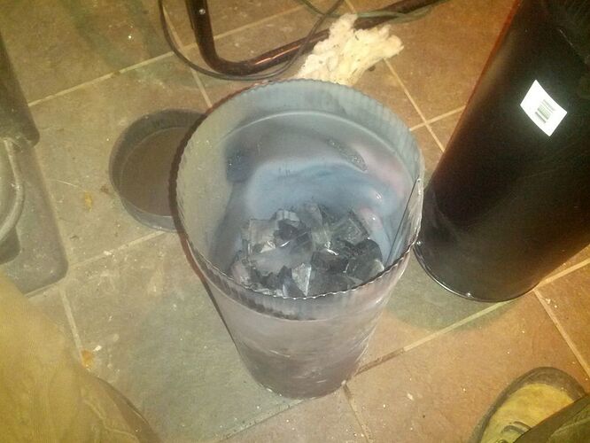

The charcoal lighting back up is a real concern for me as well. I’ve decided to entomb the retort for 12 hours in an 8 inch chimney box… Of course I got impatient so cracked this one open. Amazing looking charcoal; no brands (underdone) and no ash (overdone),no lost heat in the making, engine fuel as a byproduct what is not to love…

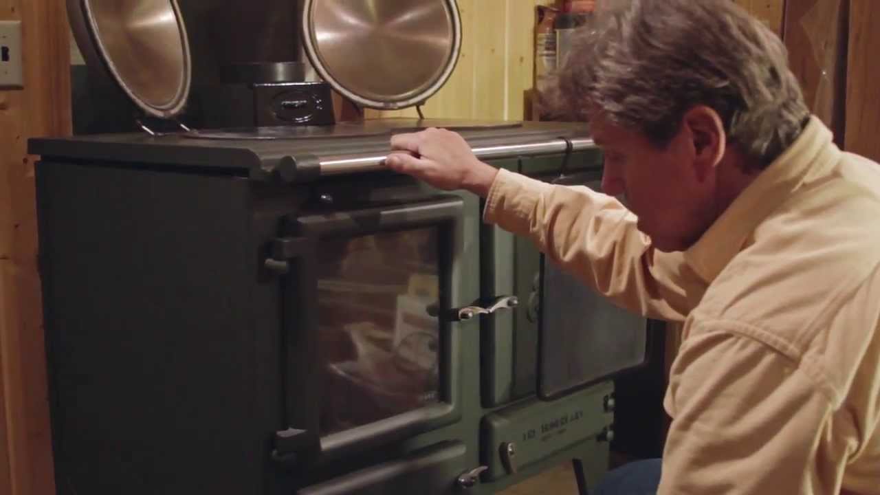

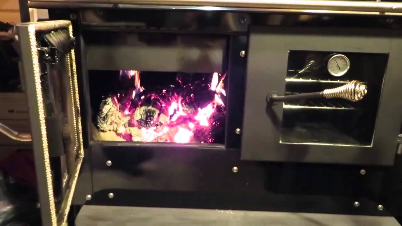

The kitchen stove video actual use evealuations were being done by a Montana USA seller called Obadiah’s:
Some comparisons of some very high end modern kitchen stoves that shows the importance of “devil in the details” when solid wood is the fuel.

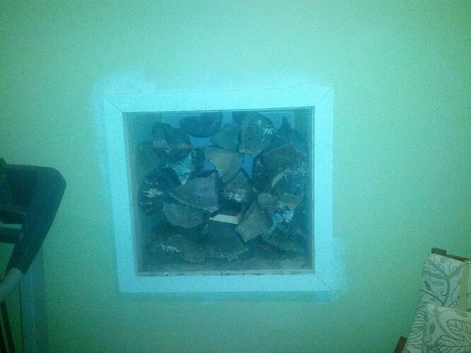

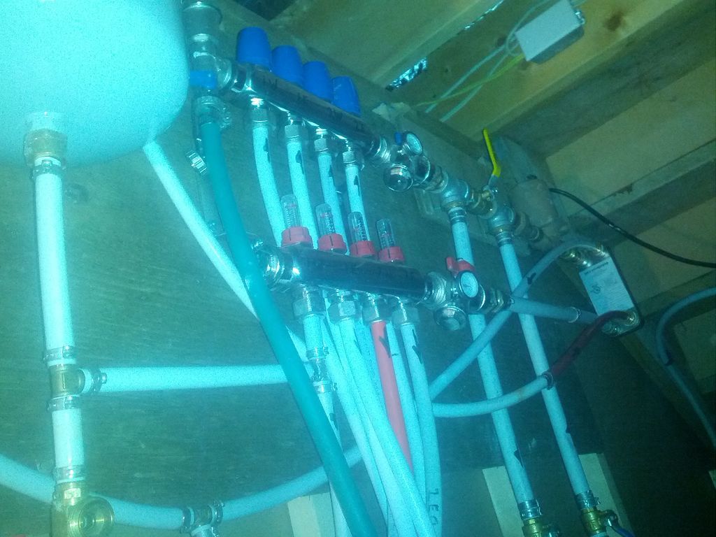

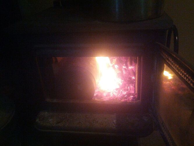

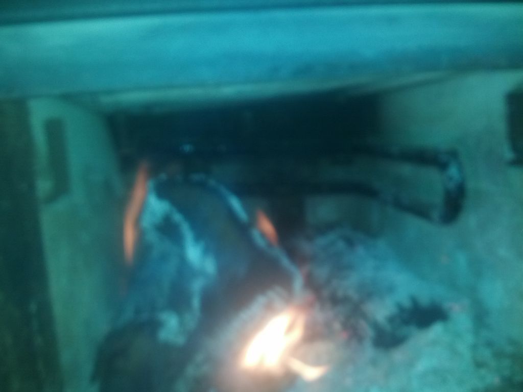

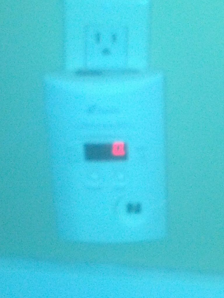

Celebrating batch 20 on this retort. It is showing some wear and tear; metal delaminating along the vent holes. The end caps are intact though. I have recently scored some stainless 7" pipe for the main body of the next retort. I will use the same end caps. Thought I would share a few pics of the stove/ radiant setup. Pic 1 is the new through the wall wood box. 24x26 inches it holds about 1.5-2 days of wood. Pic 2 is the stove during a lull; you can make out the water coil built into it. Pic3 is the radiant manifold that pushes about 6 litres into the floor per minute; it adds 5-7000 btu per hour to the house. its good at distributing heat to the far corners. Pic 4 is a must; a CO detector with a readout. 20 batches so far, about 25 gallons of really nice hardwood charcoal. I would have loved to be going non stop but I landed an inside project; rare in cottage country in winter time.
