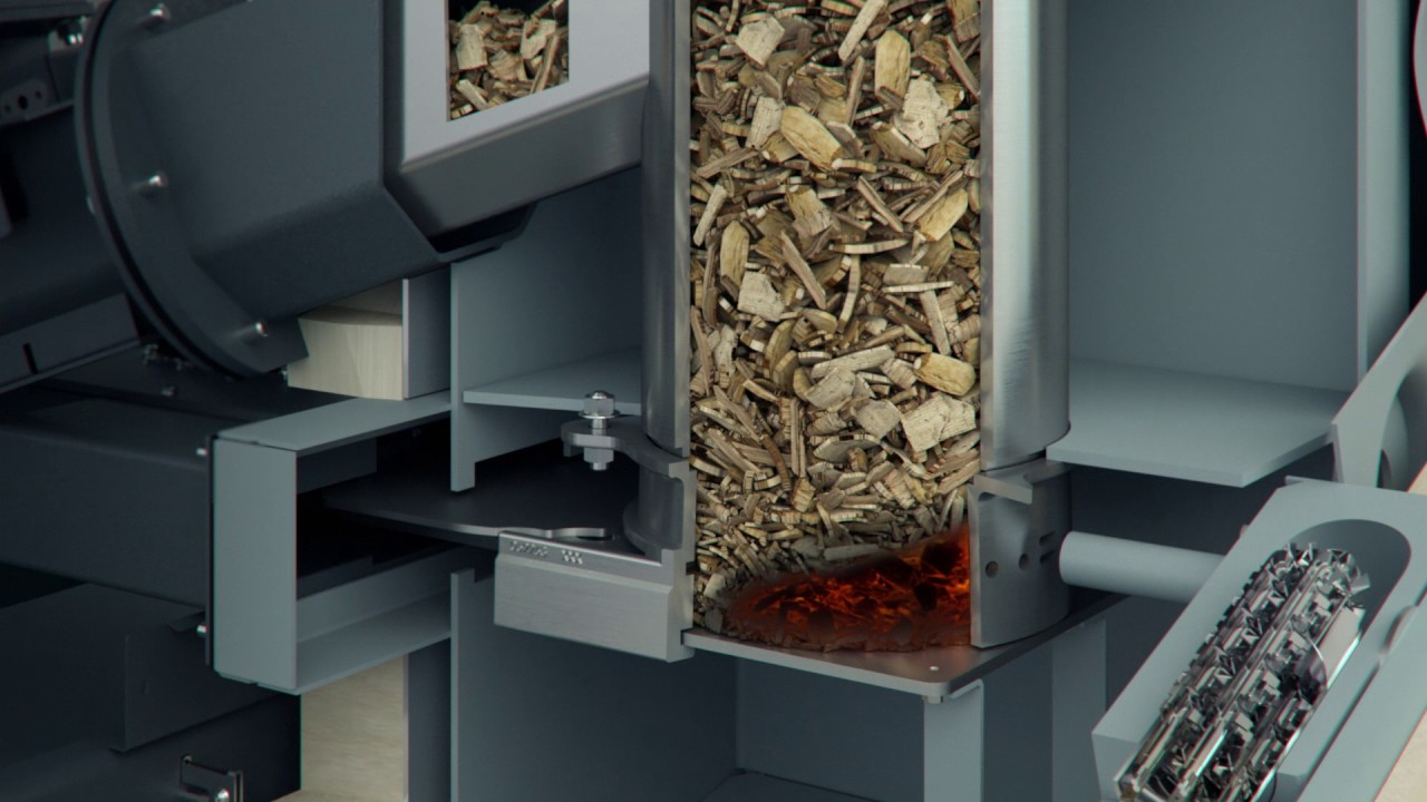

This looks like it could be a great way to make charcoal if altered slightly before it turns to ash, and use the gasses for something else .
That concept looks like it would be easily modified to produce both char and syngas for CHP.
There’s this system, a similar idea.

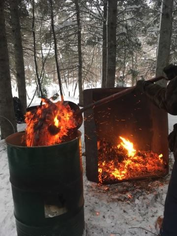

Hi friends! Things are very hard in Venezuela and internet in the woods where I live is intermitent and we have had several total blackouts with cero power. It´s been very tough for us. Thats why I have been absent s long. I´m posting 2 videos of our method in barrel (the first eficcient) and the second one we baptised "THE BEAST. I posted it in another chat. We have had very good results with both and no need to wet (I don`t recomend it). Here they are
We have been doing it for agricultural purpuses for some years.
I hope you like it!

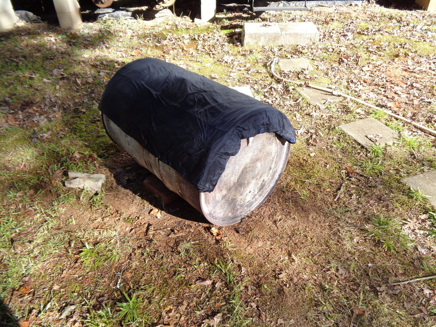

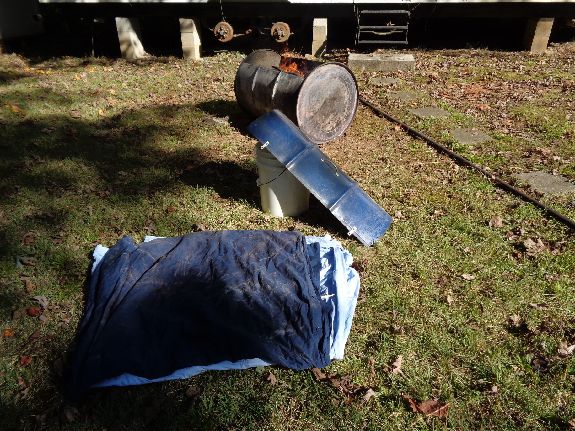

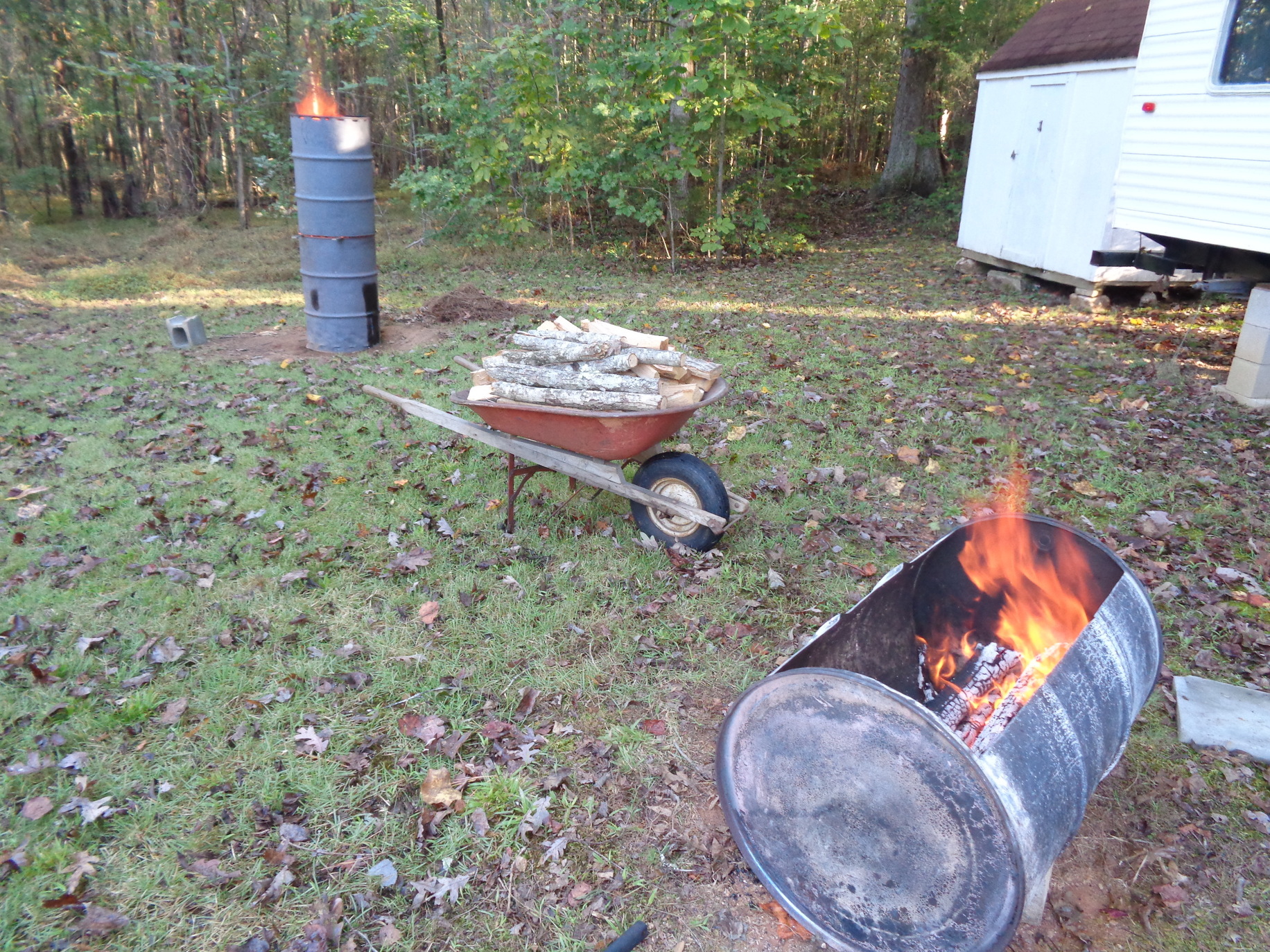

This past week I finally got around to making charcoal using the horizontal barrel method shown in the link with post 276 of this topic. The idea I had of putting the cut out part back over the hole and covering it all with wet blankets and keeping them wet, worked to seal off the hole at the end of the burn. I think I lost more to ash using this method because I should have put on wood more frequently. Adding wood throughout the burn allowed me to make probably 2-1/2 times the volume I would get from the fixed batch size, vertical barrel you see going in the background. I could also monitor the burn more closely. There is smoke with this method, however: a little bit between adding wood, but mostly when putting on additional wood.
This week I made what will probably be a 6-month supply. I still have about 1/2 of what I made last spring. Time to go riding and smiling.
