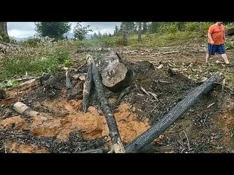

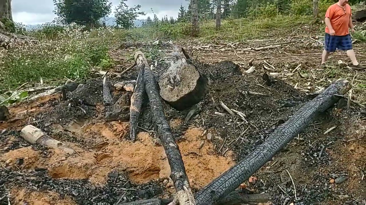

We had a slash pile, that was supposedly extinguished in April, re-ignite in September. It had been checked multiple times and had no evidence of life. We discovered in during the Camp Creek fire which was four miles from the house here in Oregon.
I don’t know what the lesson is, but it seems like there should be one.
