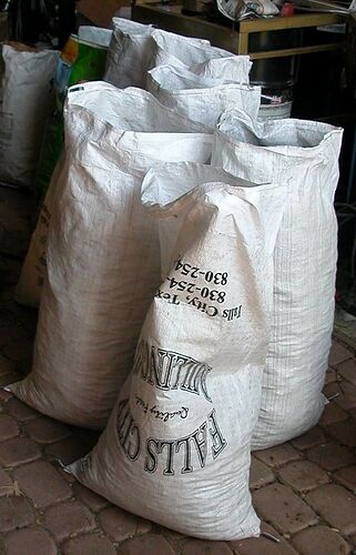

Ray, I can’t remember if you ever said how you store your charcoal. After 74 barrels I am sure you have some method. How much of it is crushed and graded or is it in in the same form as it comes out of the retort barrel? Do you separate it or is it all in one place?

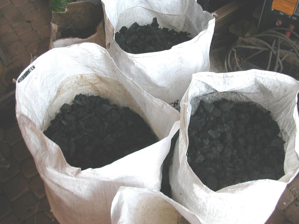

Hi Don. I have a large very cluttered barn (84’ X 56’), and now I have bags of charcoal stashed all over. Attached is a photo of the bags that a friend gets from a horse racing farm. Each one of them holds four 5 gallon buckets of charcoal. At first I was using deer corn bags, range cube sacks, chicken and dog food sacks, but I really like these white horse feed bags. (They have the same feel as sandbags, but if you filled one of these with sand, nobody could lift it.) All the charcoal in the white bags has been sifted and graded, and represents my very best charcoal. The smallest stuff is 3/16th", and the largest is walnut and pecan sized. I don’t do much crushing, but more “breaking” with gloved hands. Anything that is not breakable either goes back into the barrel, or is saved for use as cooking fuel in TLUD stoves. Likewise with any piece of wood that is not black. (We do most of our cooking outside on the patio.) As you know, the TLUD stoves make char, so once I run the unfinished chunks through the stove, they are much smaller, and are usually good charcoal, so they go back through the sorting wagon. I have put the raw output from the barrels into tubs and covered them with tin sheet to save until I get more time to sort and grade, but now I have used up all the raw stuff. I have been thinking about moving some of the bags to a different outbuilding, in case of fire. The first charcoal I made, that was stored in the paper and plastic feed bags was not so good, so as time permits, I have been re-sorting/grading it, and then it goes into the white bags. I am always surprised to find a 1/4-20 four inch bolt in what I thought was graded charcoal! No more stones or clay clumps or cow pies because I have learned to dump this stuff on clean tin. I am making progress on the motorcycle sidecar attachment for a 250cc Honda Twin. That engine should not have a large appetite for bags and bags of charcoal, like the large van with attached trailer. I estimate a three pound coffee can of charcoal will get me to town. (12 miles)

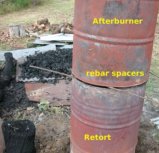

It looks like a pretty solid design, but i didn’t see where it let O2 in at the bottom of the after burner.
I know what you are saying about the dry wood. :slight_smile: I think I am going to try and dry out the old stuff anyway. It will make a good test, against the green stuff that is already cut n split and drying. :slight_smile:
Sean and Gary, regarding air in at the bottom of the afterburner..I tried just putting one barrel on top of the other, with no inlet for secondary air, but got some smoke, so I raised the chimney up on the two pieces of 1/2" rebar, figuring I could remove or insert them if needed. That stops any smoking, but makes lots of flame in the chimney (afterburner). Usually I just leave the rebar in, but in theory, it would probably be better to have the chimney sucking vacuum on the bottom holes. I just came in from manually splitting wood that has been in an 8 foot high pile for several years. There are some partially composted pieces in there that will be used to make the heat for future loads of charcoal, once the burn ban is lifted. I knocked down the pile with the front-end loader, and the stuff at the bottom of the pile is turning to carbon dioxide..If I get a big enough mess in the yard with the split pieces of wood, I’m hoping dear wife will stack it.
Below is a photo of the rebar spacers.
24.5 # per 20 gallon feedsack
Ray, I’ve been meaning to tell you, I weighed the big feed sack I got off with, it was full to the max, and weighed 24.5#. I’m sure it was about as dry as it is going to get, having been in your barn then out in the sun at my house for a few days. So, we have a conversion factor, 1.225#/gallon. I believe you said most of this was mesquite charcoal.

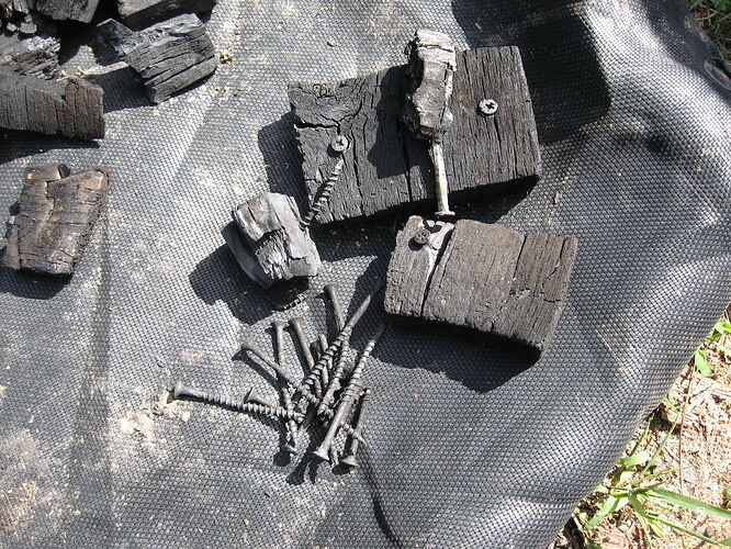

Nails in wood and charcoal.
If you have some lumber, that is loaded with nails, it may be worth while to char the wood, remove the nails and use the charcoal for fuel. I recently tore the back deck off and a lot of the wood screws snapped off. These unpainted scraps were put in a retort and charred. The char was then spread on a tarp to a depth of two inches. A strong magnet attached to a steel rod was run back and forth through the char. Several passes were made back and forth, up and down and at 45 degree angle to the oringinal sweep. Yes, it takes time but I have yet to run into any fuel that doesn’t take some preparation. Here are a few pictures.
Gary in PA

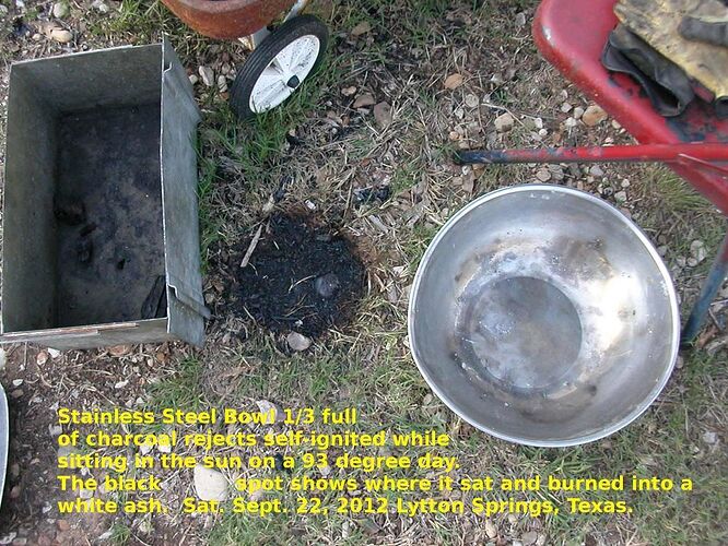

Careful with the Sun and Charcoal! I needed a plastic bucket, so I dumped a small amount of damp “reject”
charcoal pieces into a large stainless bowl. When I sort/sift the
charcoal, these are the little pieces that are not quite converted
into charcoal. Either they show some color other than pure black, or
they have some raw wood, or they are so hard they cannot be easily
broken with the gloved hands.
This evening, I went out to sort a bit, and was astonished to find a
bowl of completely white ash! Under the bowl was a very black spot
burned into the dirt/gravel driveway. My sorting spot is under a
tree, but apparently the afternoon sun was focused by the sides of the
bowl onto the charcoal, and was hot enough to light it.
The first photo shows the bowl and the black

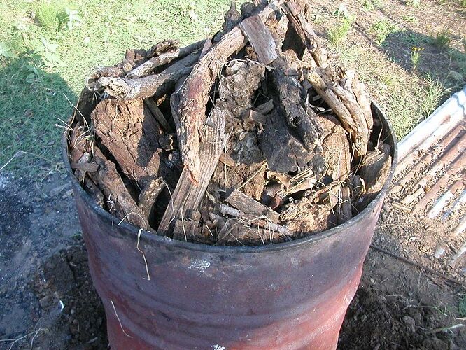

spot. The second photo shows the oak I have been splitting. Some of
these chunks are half rotten, or are "Y’s) or simply won’t split.
These are being used to make more charcoal..I have made 4 fifty-five
gallon drums this week, and the next one will be number 80.
