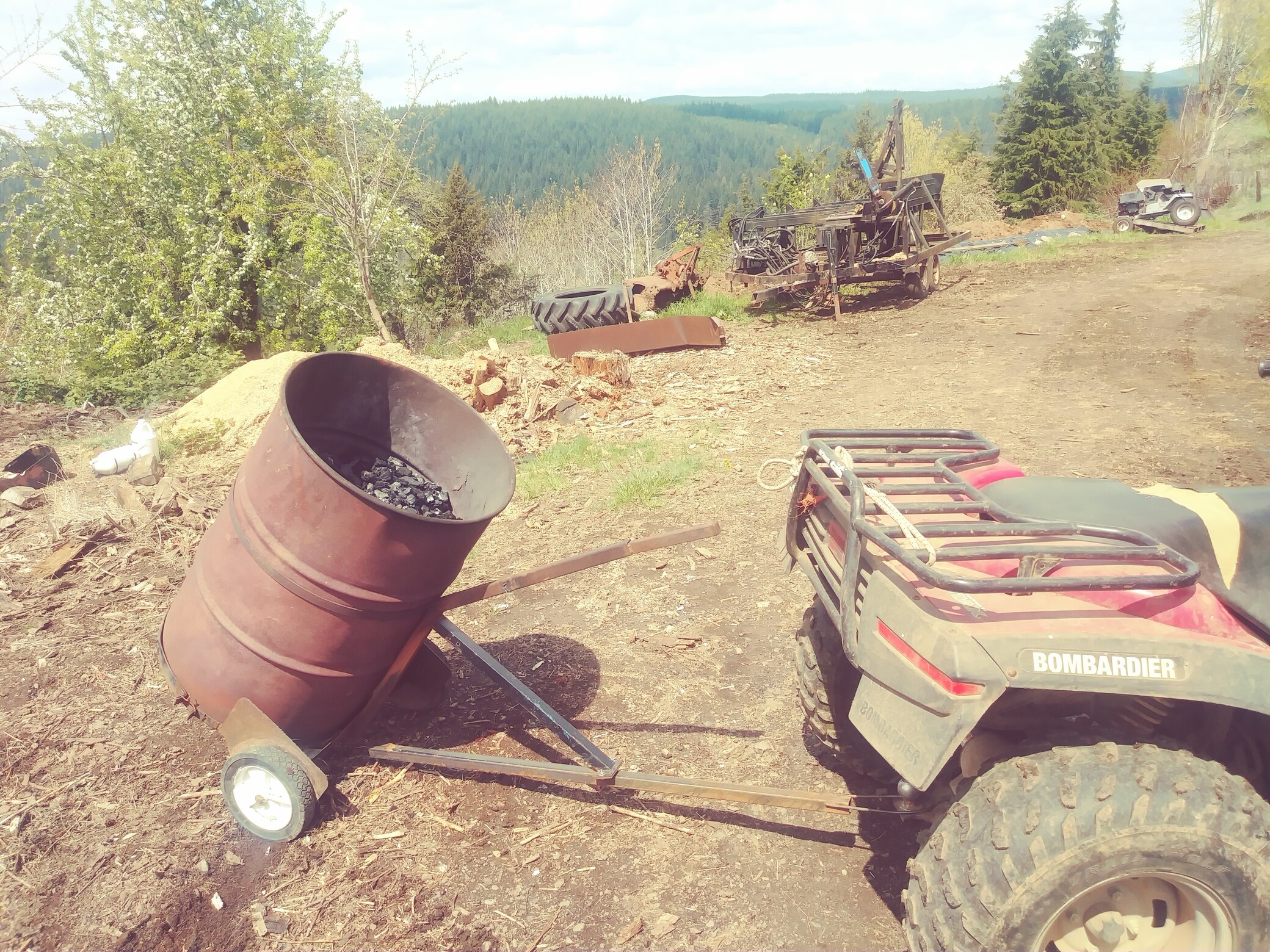

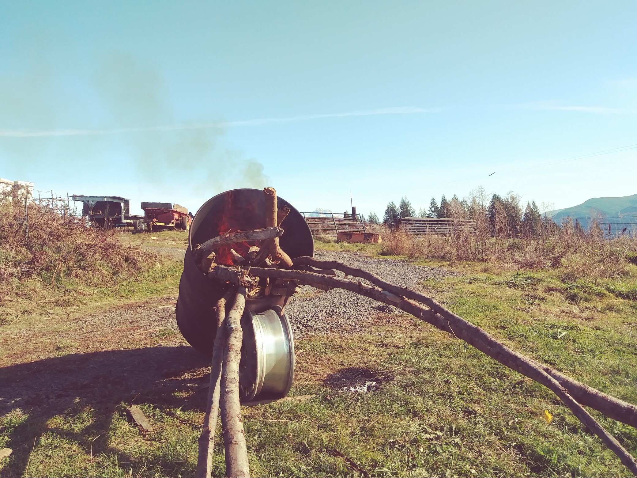

The drum burner works well behind an ATV.
55 gal drums are cheap and ubiquitous.
No holes, no welding, no modification of any kind means you are up and producing as soon as you get it home.
No holes means the drum itself lasts longer.
The angle is not critical, there is no special technique to master.
Operating with no visible smoke is entirely possible.
Oxygen starving the charcoal instead of water quenching it is very convenient for gasification.
Having tried a lot of fussy and expensive methods to get useful quantities of engine grade charcoal, I’m convinced this method has a lot of potential.
Chuck from Sandy, Oregon

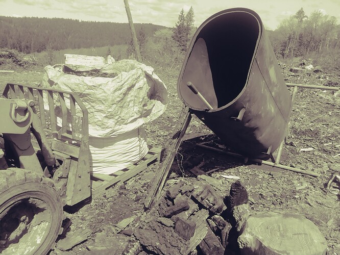

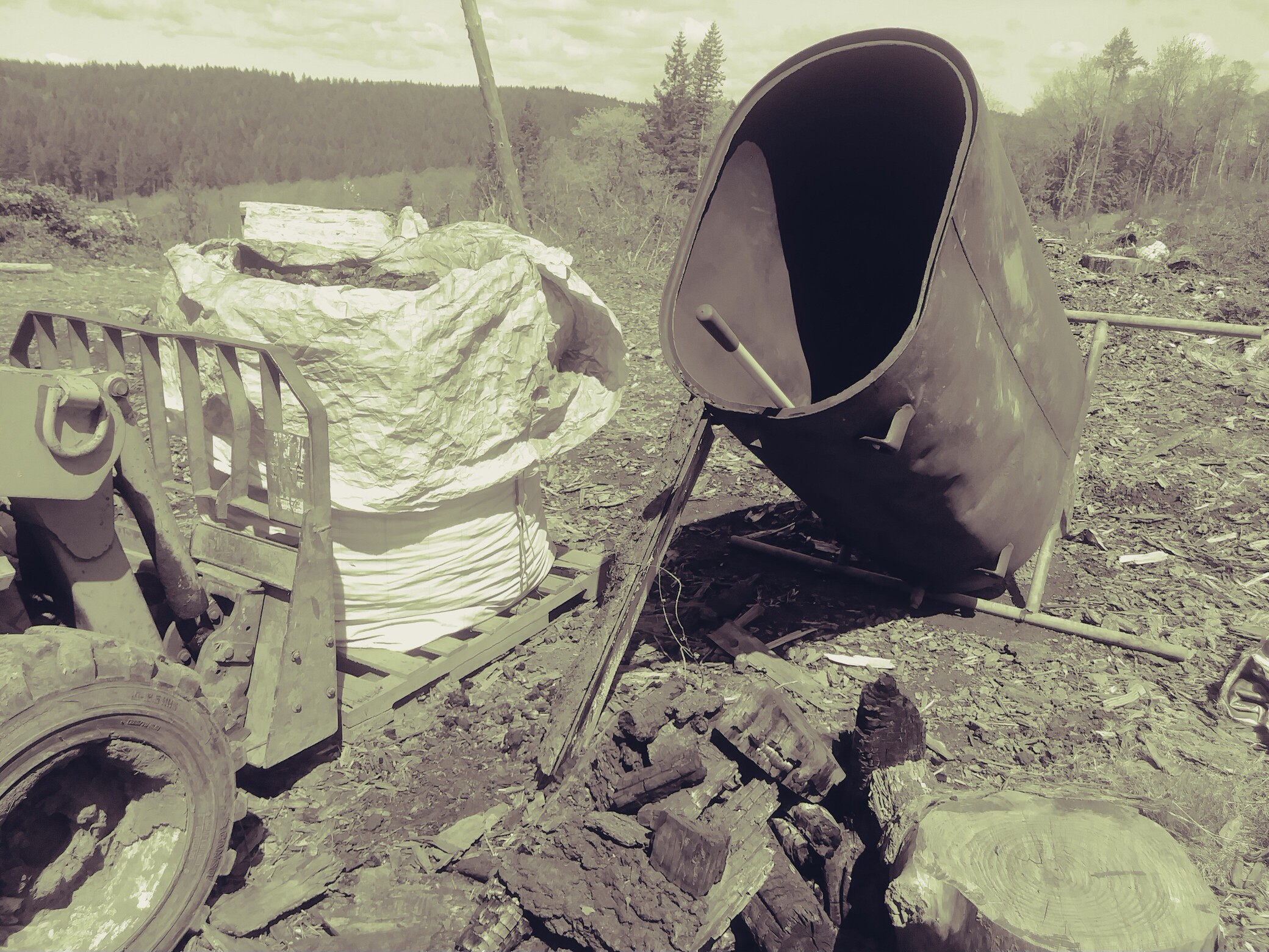

The economies of scale apply to charcoal burning; it is about the same amount of work to make 120 gallons of charcoal using the larger burner as it is to make 40 gallons in a 55gal drum.
All you are doing is throwing a few pieces of wood in the burner every 10-15 minutes.
Mostly it’s about the interruptions to whatever else you are doing.
It takes a few seconds more to feed the bigger burner. There is an optimal scale for a one man operation I suppose. Without machinery, I’d say you could make 500 gallons in a day if you had three burners, without working too hard.
You could probably cut a few cord of firewood at the same time.
Assuming you had the brush to burn, replacing 50 gallons of gasoline in an easy day isn’t bad.
Letting the fire do the work of reducing the wood raises the convenience factor.
Long pieces get progressively shorter without sawing or grinding.
Oversize pieces can be thrown in to be charred through successive batches.
Because of the huge quantity of surplus heat, once you have a hot bed of coals, these burners will char very wet wood (which will smoke).
Never underestimate the importance of convenience when advancing new techniques. :wink:

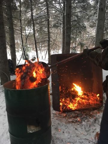

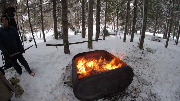

I often make charcoal this way In an old oil tank just lying

On your fire pit idea , why bother pushing soil around the fire ? once you start pushing soil into the fire it will bake it into hard lumps that will get mixed into your charcoal fuel , if your having a open burn then just lay some tin sheets on the ground and build fire on top and as they burn down to charcoal use a shovel to fill a 55 gall drum up , Trigaux has the best idea if its simple easy contained fire then just use a open drum of as large a size u can find and burn baby burn while warming and cooking and afterwards just shovel them coals into the drum too cool down .

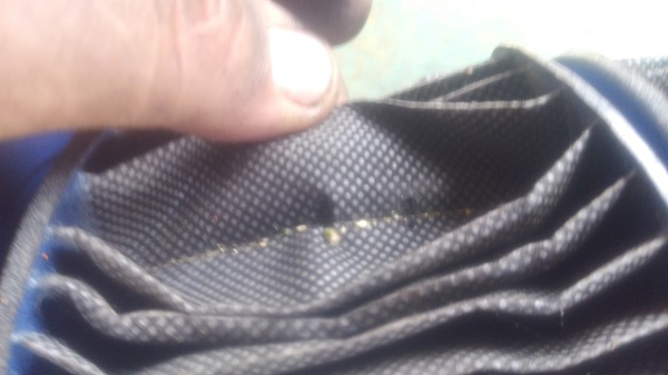

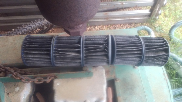

I started out with a sock filter on my generator. Now I am using swimming pool filters they work very well and are washable. The sock filter for me would plug up after about 4 hrs of running. I can run it on the pool filters for a couple days without washing, but I tend to wash it once a day . Keep in mind this is on woodgas that has already been through a hay filter and a set of cooling rails. this is just a final filter to take out the little bit of soot that makes it there. Still I think as long as the gas was not hot they would work on a char gasifier quite well.
What does your pool filter look like, Jacob?
Is it one of those mesh screen filters or the foam filters?
This is a picture of the five I have connected together for the generator. they are made out of this very fine mesh with some foam in them as well.

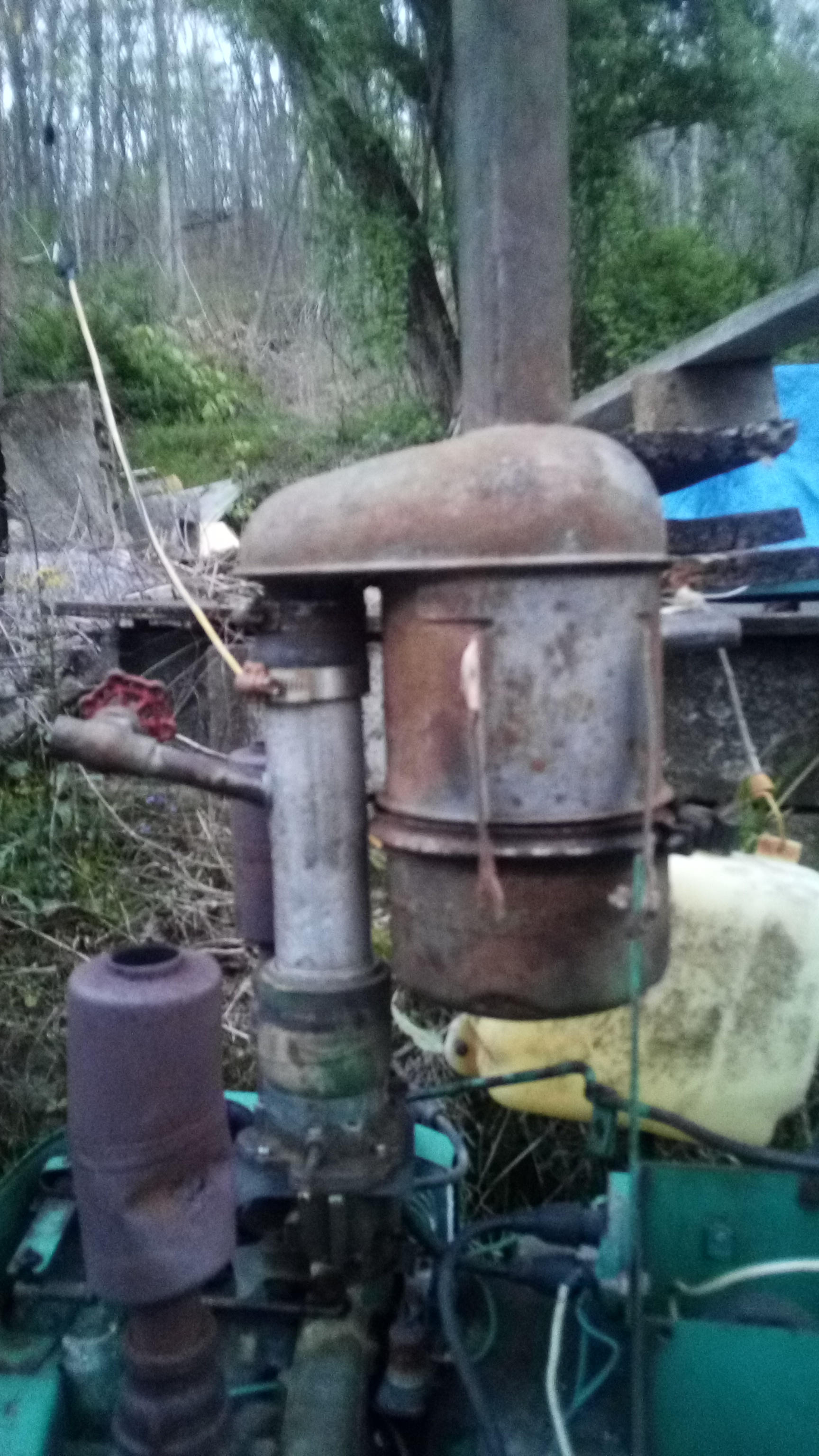

im useing a tractor oil bath filter but i cant get my onan to run right on gas i think maybe the carb is flat wore out i dunno its been a fickle thing im hesitant to try and fool with running on charcoal with it running poor on gas
