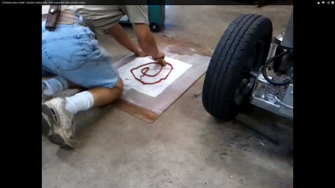

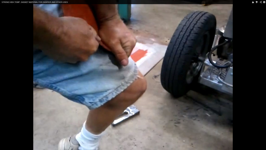

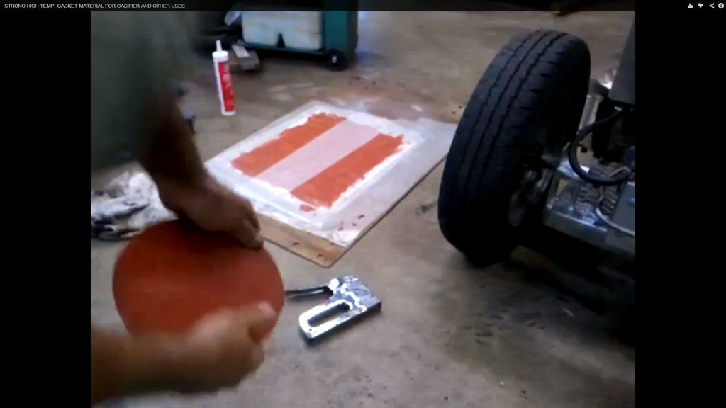

This is a short video on how to make very strong high temp. gasket material. This is in sheet form and great for flange gaskets or anywhere requiring a flat high temp. gasket. I made these after just using silicone by itself and having to replace it with new everytime I took the parts apart. This gasket material is very strong and reusable. Hope it will help solve some of your gasket problems. Dan C. http://youtu.be/vNWsOJbn-ME

Hi David S.; Yes, after it is dry, although I never tried it wet. I take the pipe or bushing or whatever hollow tube I use and sharpen the outer edge a little then pound her through. I do this with metal underneath for clean cut, but it does not make the punch last very long. : )

Room Temperature Vulcanize. And I’m wondering how long it takes to vulcanize inside that wax paper? My experience with red RTV is it is s-l-o-w in air. I’m glad it works Danny. I will give it a try soon. It looks like fiberglass “mesh” is different then woven?? Part # 488 or 499??

So what is the “dry to use” time on one of these gaskets? I know some others here are forming and drying gaskets made solely out of red RTV (no fiberglass mat). I know Sean F. has and I am sure others have followed suit. Maybe they could input some on what thickness they are forming solid RTV and how long they need to dry to use.

David, I will remove wax paper tonight , let dry a few hours on each side.If needed I will add more high temp. to underside.Will flip back and forth occasionally for a couple of days and they should be ready to cut,punch and mount. Keep in mind it’s hot here. Dan
