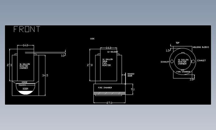

haha no sorry about that, we only meet on thursdays for 3 hours so the amount we get done is limited however we did finish a rough sketch of it. Obviously this is nothing as extreme as some made by professionals please keep in mind, we are only amateurs looking to create a basic gasifier to create a combustible gas. It is unlikely we will be able to use the gases for a motor but more likely have it end with a pipe and hopefully combustible gases coming out of it. Attached is our CAD drawing in jpg form. I appreciate the comments and have looked into some of the resources supplied. Everything has been helpful so far and I will try to get on more often for commenting. Thanks!
the outside drum ideally will be a 55 gallon drum i believe
