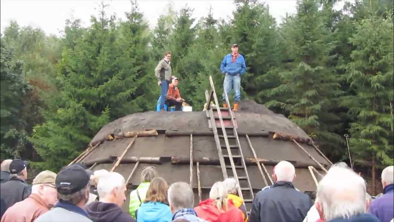

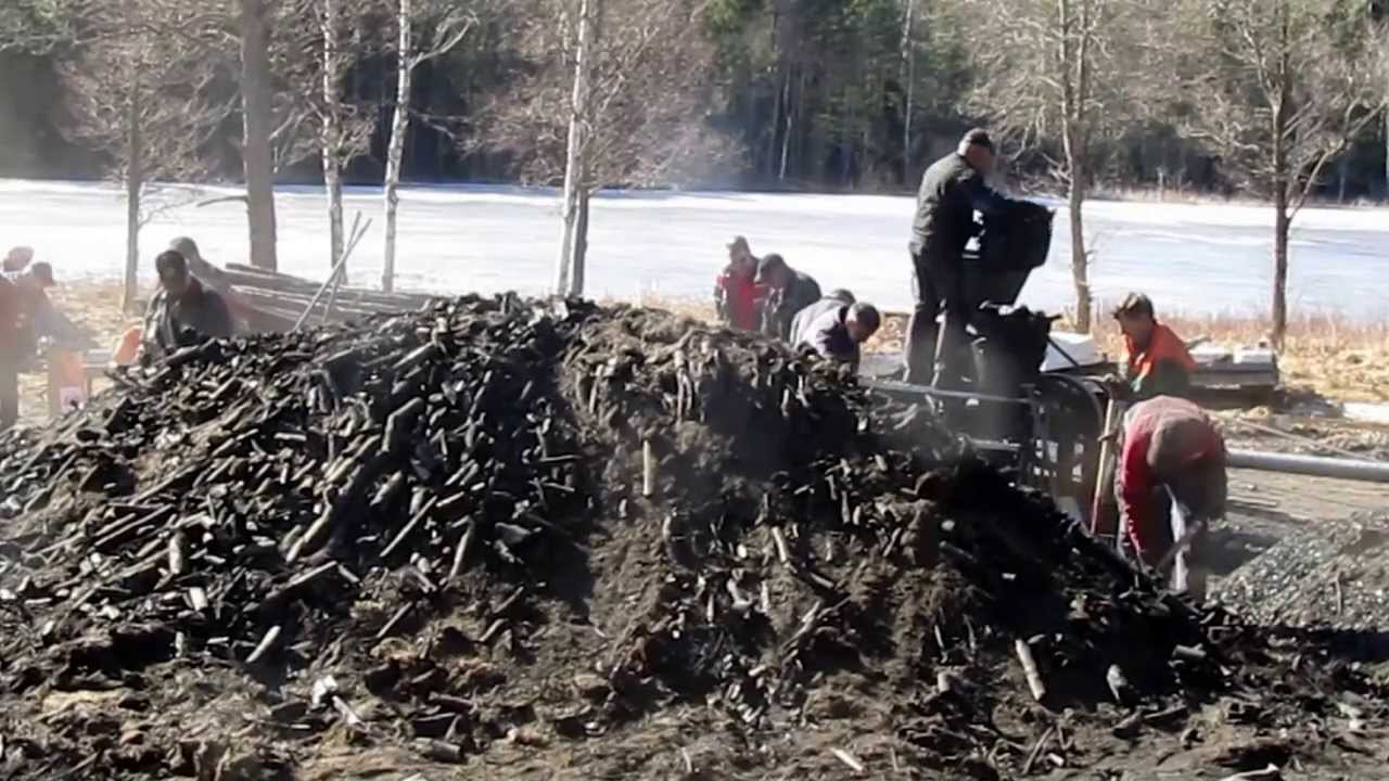

Kristijan, maybe you should start thinking about lighting a big stack ones a year. In the woods around here there are still traces of stacks from WW2 charcoal production. This video shows a bunch enthusiasts tearing down a stack, grinding and sacking.

As I understand the wood is not allowed to burn once the wood stack is properly lit in the center. Requires constant attention for several days. Any flame that pops up is banged on and/or covered with more dirt and even watered.
This is the stack they started off with. You should get suggestions of better videos of how the stack is built up or search for ā€œkolmilaā€ - if you want Swedish charcoal stacks :smile:
Such sistems are traditional here too. Its interasting however that the char in the video ā€œringsā€. This indicates a wery high internal temperature, hard to acheave just with smoldering. Thats why l thod there is something more to it.
Perhaps it has something to do with the mass of it? I mean the pile is HUGE!
One thing they never show is how the char is cooled down in such a stalk. In my experiances, a big enough mass of char with just traces of air will slowly burn like forever.
I know they quenched it in water here, dried on the sun later. But that was blacksmith charcoal, not so picky on moisture…
The couple of thing i did notice were the flames coming from the charcoal on the BBQ’s and the very little dust that was coming from the grinder/shredder means that i wont be able to sneak into the Forrest for free engine fuel as i think it may be a bit too tarry for me , but i bet it makes amazing grilled steaks .

Dave one part of the video shows a guy putting ā€œwoodā€ into the BBQ. That is where that flame was coming from TomC
