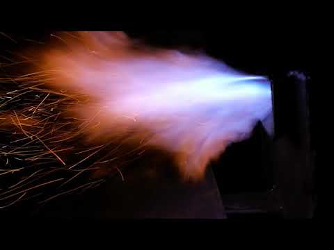

Don, right. This is nearly maximum the system can handle. To tell the truth l didnt think it wuld make this much gas, its so tiny…
I wuld guess this is about the amount needed to push the car around 50mph.
Dave, yes, but it seems wet char has a drawback, it sparks like crazy. I hope l dont end up with too much dust in the system.
Bob, you culdnt see it but the gas kept burning inside the gas port thus lighting on starting the shopvac.

Nice Christmas flare, Kristijan!
