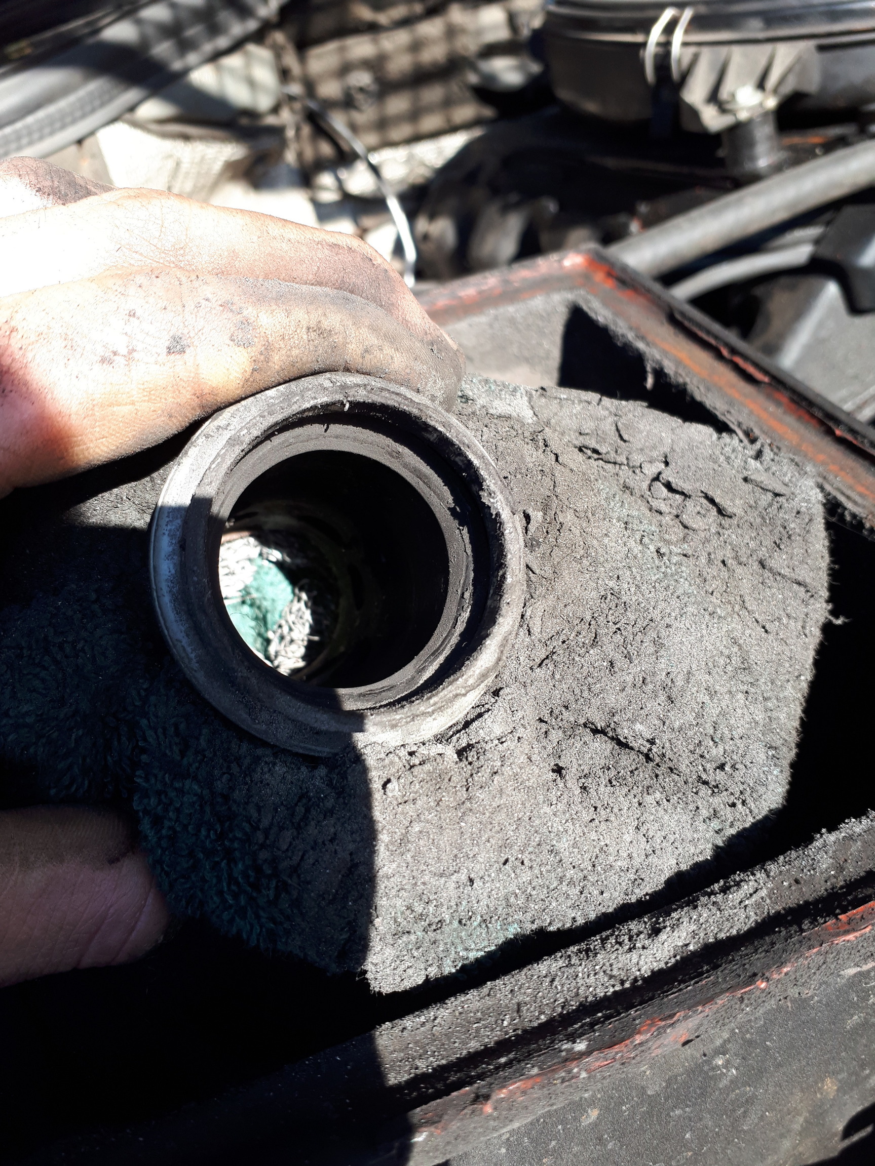

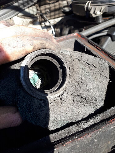

Now for the woodgas part. Prior to the 80 mile roundtrip l emptyed the ashpit, shook the grate and cleaned the filter.
Here you can see inside the towel sack. A thick lair of dust over it but the inside is still clean and dust free.
I toped up with 50/50 mix of charcoal/wood. With the system all clean and breathable l can open the air mixer valve 100% and still run a bit rich.

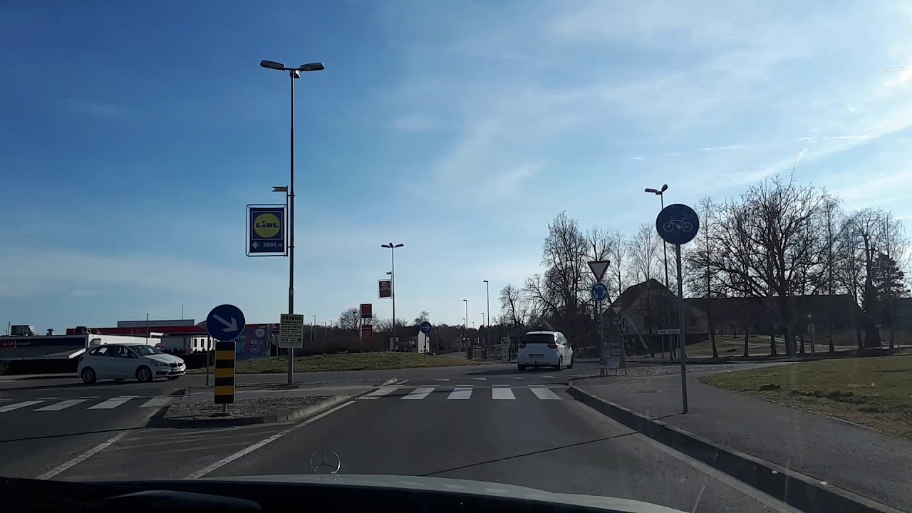

This was the first real highway drive. One video is in my previous post, it was shot soon after joining the highway.
I never intended this system to be a highway machine. Top speed of 50mph is what l amed for when building it, rest l planed to top up with petrol. But l decided to see whats the top most power the system can produce so l went fifth gear and WOT, for a while top speed was constant 90-95kmh (58mph) like you can see in the video. Keep in mind my speedometer shows 7-10 kmh too litle.
But then something weird append. The car just kept pulling and pulling and l reached 110kmh on pure woodgas! And that was not just temporary power, it maintained it for about 20miles. Hopper vacuum rised, hopper temp stayed at working temp (60c).

Wow, very impressive Kristijan, the remote grate shaker will make a difference for sure. Your gasifier is working great. The long all metal cooling system is doing its job. And the filtering box with the towel sack is keep char soot out of the engine intake. My hat is off to you in what you have achieved with your 50% wood, 50% charcoal fuel gasifier. And not to forget to mention the stealth when you fueled it up and driving on the highway and in town.

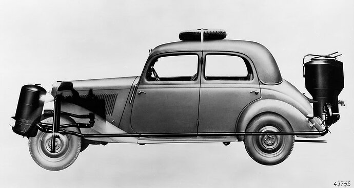

Hi Kristijan,

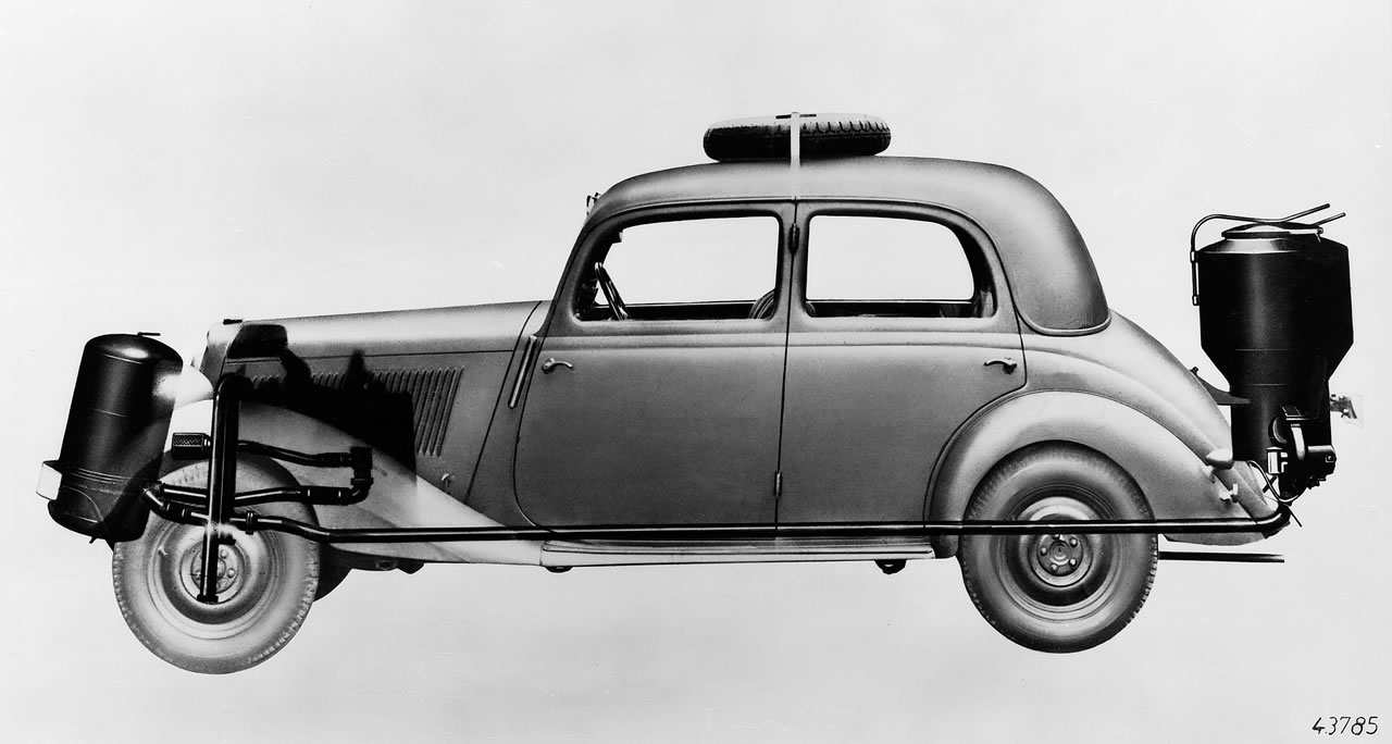

you probably already know or it is no big surprise that Mercedes-Benz built a charcoal-gasifier car (a version of the model 170 V) during WW2.
I found this picture
It is a crossdraft-gasifier at the backside and a sack-filter at the front. No EGR or water. Nozzle was a quite massive cast-iron piece that still had to be replaced frfom time to time.
Not very stealth compared to yours ![]()
