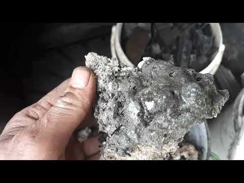

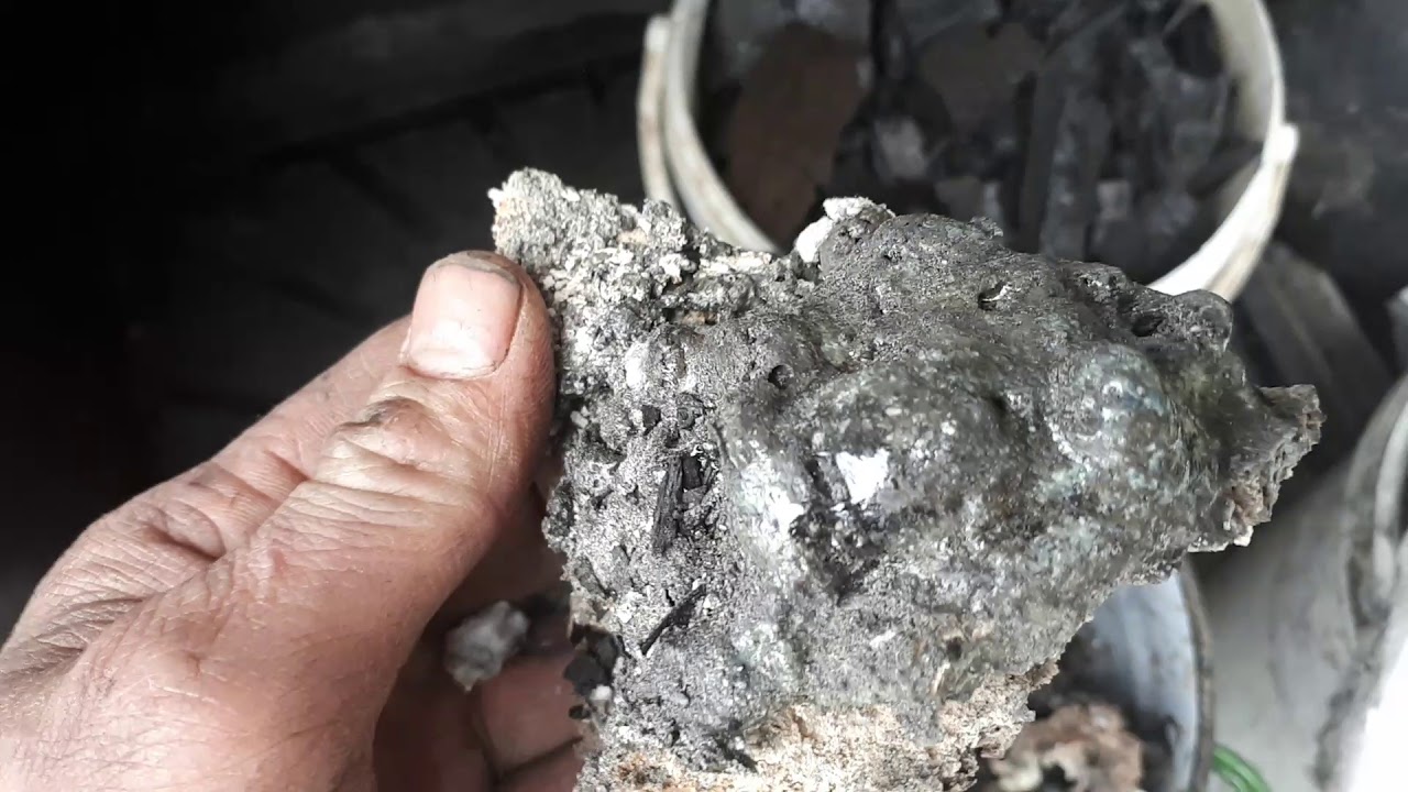

This is a video l forgot to upload. I wanted to see what the gasifier looked like inside afrer tortureing it on the highway the other day. My oh my what a surprice!
This tells me l shuld either put more wood to it if l plan on highway drive, or not push it so much.

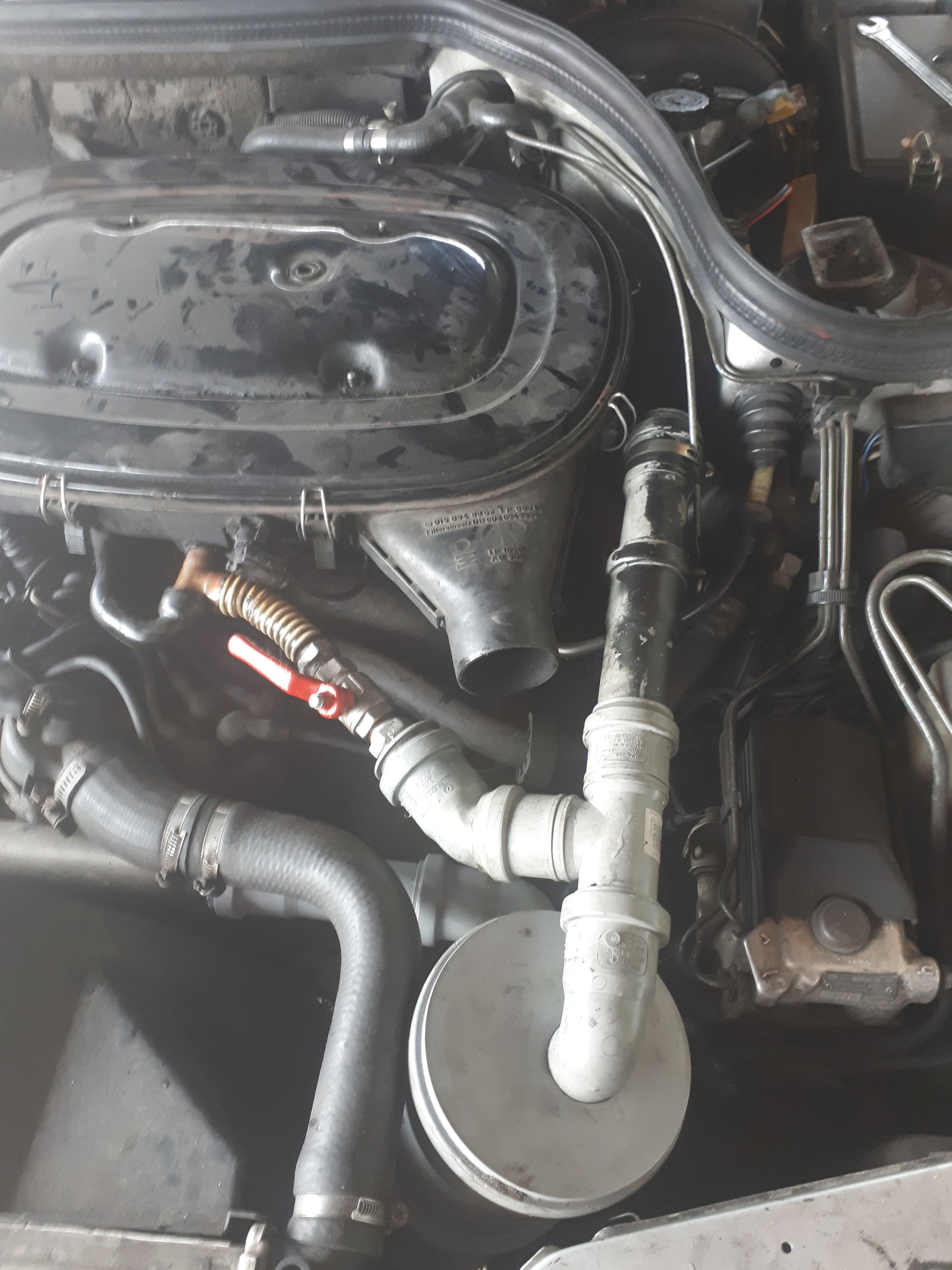

I installed a new component, final safety filter
For now, this is just a empty vessel. I havent yet decided on what kind of a filter media l will put in. I am weighing a few options. Oil filter, paper/canvas filter, open cell foam… any ideas? The container is roughly 5" dia 1 foot long.

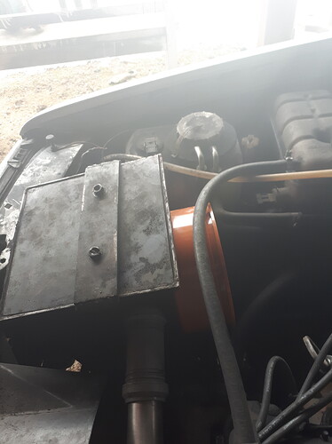

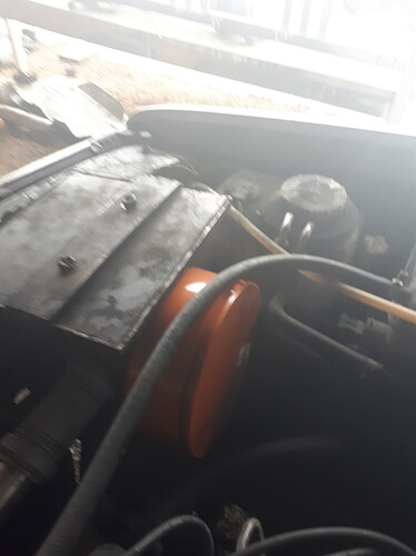

Second, l found a good place for the automixer. It will be screwed on the primary filter.
I found this 2 sturdy plastic pipe caps that fit one in to other tightly with space for a thin film between, for the membrane. Easy to fix if rips or something.
