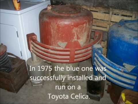

Look at page 195 of the Swedish gengas book.
An example can be seen in this video, it is in the top of the filter lid. Minute 1:11 A bit more surface would reduce the flow resistance.
