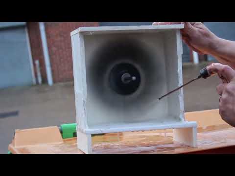

I found this very interesting :thinking: I

Yes. It is interesting. For folks who don’t have a suitable welder or skills for welding stainless they might wish to use silver solder. It requires a good flux and limited heat to prevent oxidizing the stainless.

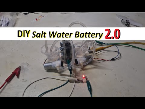

As far as salt water batteries go, here’s a newly posted video that might be of interest.

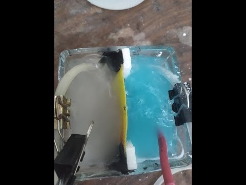

I’ve wasted a lot of time and money trying to build my own batteries with only limited success. This video just showed up and combined with a DIY membrane like…
That YouTube channel also had some other DIY membrane videos that I started to try but got discouraged and moved on to other things before I tested them.
I did a quick test of the galvanized nail and copper wire idea from the Aquion link and it did make power but it looks a lot like a potato or lemon battery.
Lots of people have the idea to scale up homemade batteries using buckets or barrels but I never seen anyone that actually did it. All my small scale experiments had such high self discharge rates that scaling them up would have been a waste. Hard to compete with the proven lead acid or lithium.
