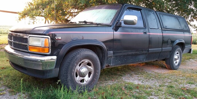

This topic is for general information about my 1995 Dodge Dakota Project. Mostly about the truck itself. There will be no WK Gasifier fabrication posted here. That will be in a separate thread.
First “Slide Show”..

Here is a video with some general stuff and walk-around.
https://youtu.be/qZnP3FpDAAs
Some fenders a little rocker panel work,she sounds good, paint it and oil the frame and it should out last both of us.

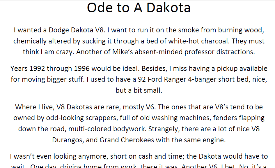

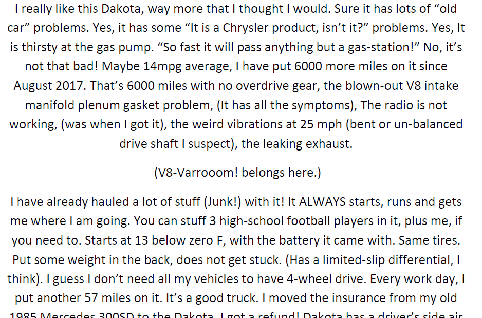

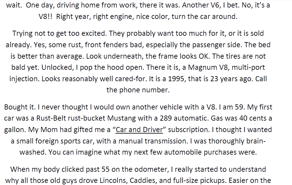

I have been feeling really odd lately, and this is the result. I wrote this in MS Word before I found the only things you can upload to a post are image files, so here it is in multiple pictures. Hope it is legible!

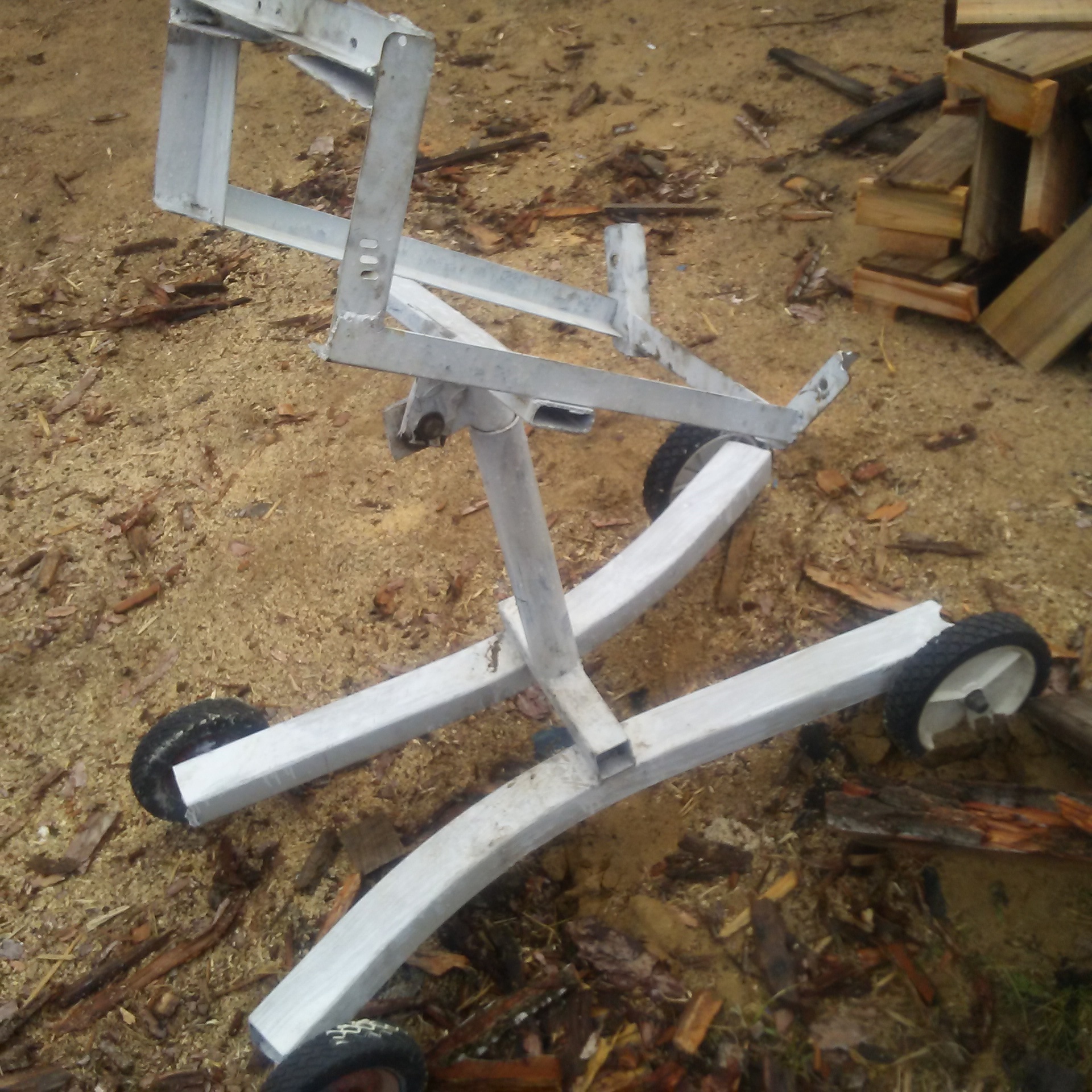

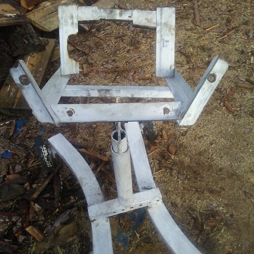

Its a big puzzel at first then as getting firmilyer with the parts and how they fit it gets easyer with just part handeling and cheching the book.You need a large bench too set the parts in order and a core tranney for double checking. So two large benches best till parts memerized locations. And i for got you would need too build a trans stand too hold up too your height with a swivel and on wheels too roll out side for good lighting on the harder too reach assembly snap rings. PS the new 8 speed automatics from asia look interesting. More gears for better milege, and steady throttle angle.The book for me was the most intimiated, once tranny is apart and studdyed it gets down too a very few double checks and the tools cost zero for me, i made clucth puston return spring compressor with a bumper jack and case too hold for the one hard too get snap ring that held the tin spring cage down.by watching the vidio of tools working. Here is the trans stand i made for small block chevy trannys.
The bell housing bolts too the short tabs and i made the tranny mount bolt hold on the tall end of trans bracket. Hope i dident corrupt your thread, thought maybe my trans experiment would be helpfull if you decide too tackel.
No hurry it took me a week or so too look at all the posible ways too put toogether wrong, and with the parts and book too observe locations. The only thing that i dident check was the end play after pump is snuged down against the parts, if too much play as in a few extra thousands than can buy shim washers too get clearance, long as the other 5 or 6 standard washers are through out the transmission have all ready been installed. Since i bougjt all new standard washers the clearance was fairly snug but not tight so i just let it go at that. The odd way that trannys go together i am serprized they last 200.000 + miles.
