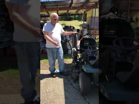

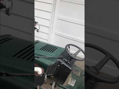

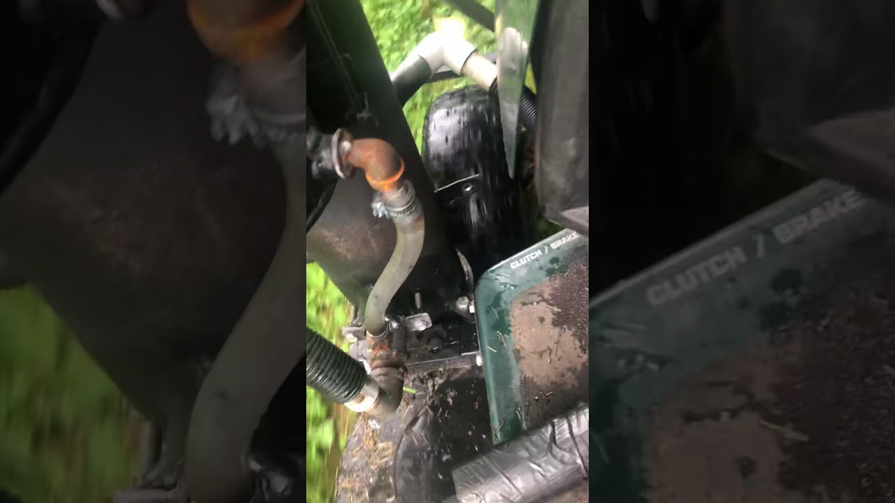

Had some problems and so after mods began mowing
Sorry about the sound but this is after 15 min of mowing high wet grass

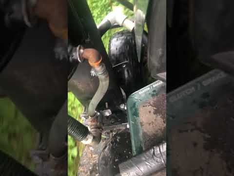

Thanks Mike, I like the gasifier set up you have built. The water cooled nozzle sure seems to be working great, making water vapor for the intake air for more hydrogen out put of the gasifier. It is also seems to controling the gasifier temperatures around the lower part of the gasifier. I like how you can see it percolate through the clear tube. The mounting of the whole unit is nice. A Great build you have shown us. Thanks for the walk around and the ride with you.
Great job, Mike! Perseverance pays off. Are you passing the gas through the original air filter? Is it a thin foam rubber sleeve over pleated paper?
