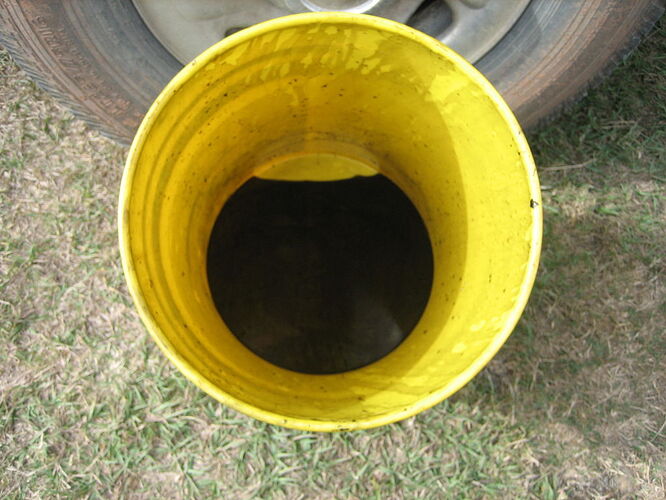

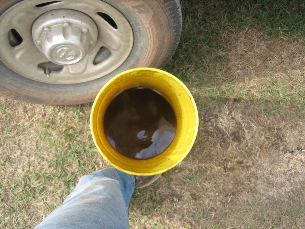

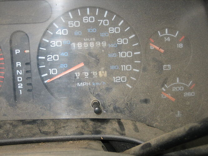

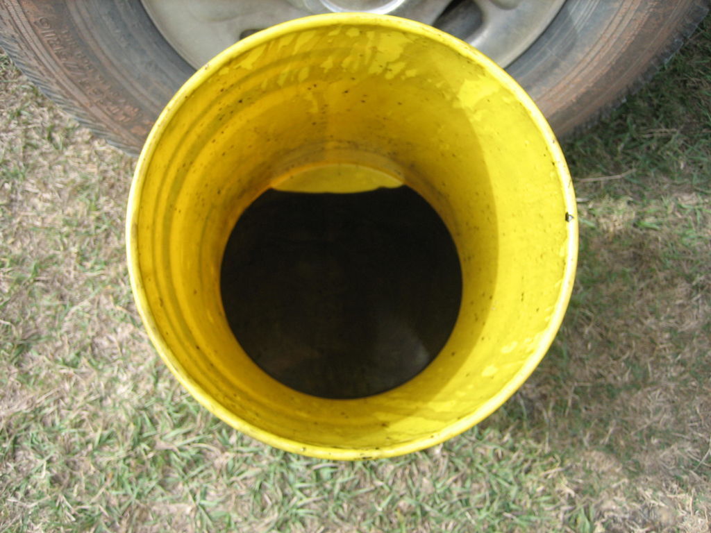

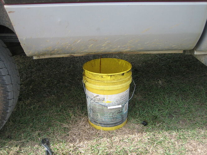

Good Morning Robert,

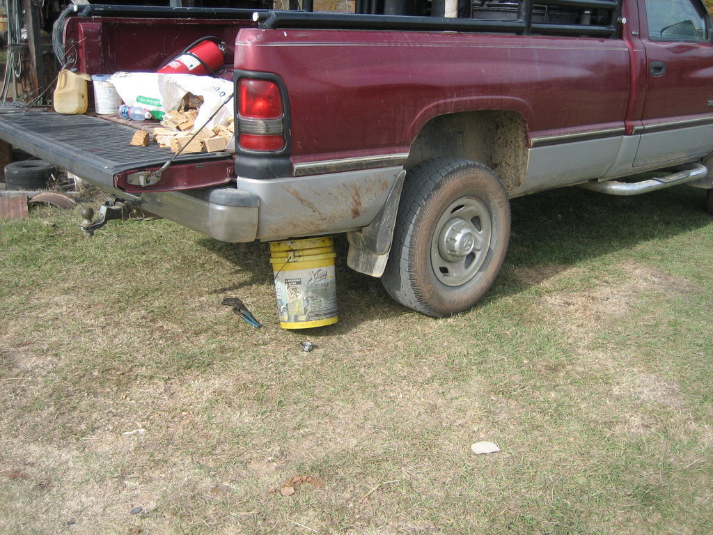

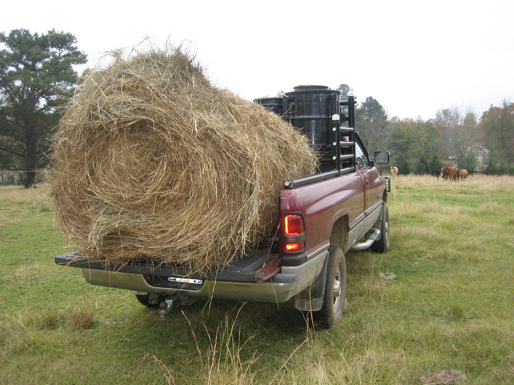

I drained all the condensate from the v-10 Ram this morning before making a trip into town. I will be doing a few farm chores today hauling hay ect. I expect to put about fifty miles down. We have light rain and humidity of 93%. I will keep up with the amount of wood and miles and report to you.
Thanks for posting the picture. It is kinda eye catching!!
Hey RobJ
If they will, offer buy this system for scrap value.
You WANT that high pressure/hogh volumn blower and power supply.
The car, a SAAB? sedan not something you want. Not enough space/weight capacity in this for a while system and on board fuel supply.
Talking the the biulder of this would be good alright. He/she with thier large for this small 4 cyclinder? engine fuel gas suplly piping with sweep corners show some smarts here.
Good Morning Mr. Robert,

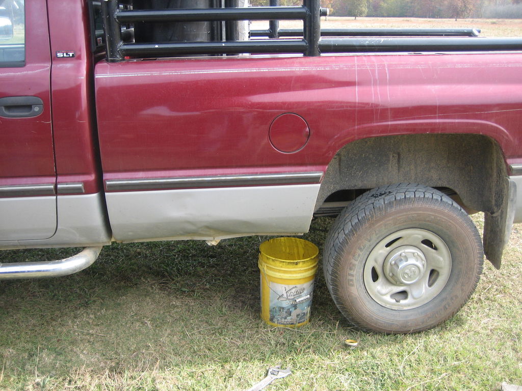

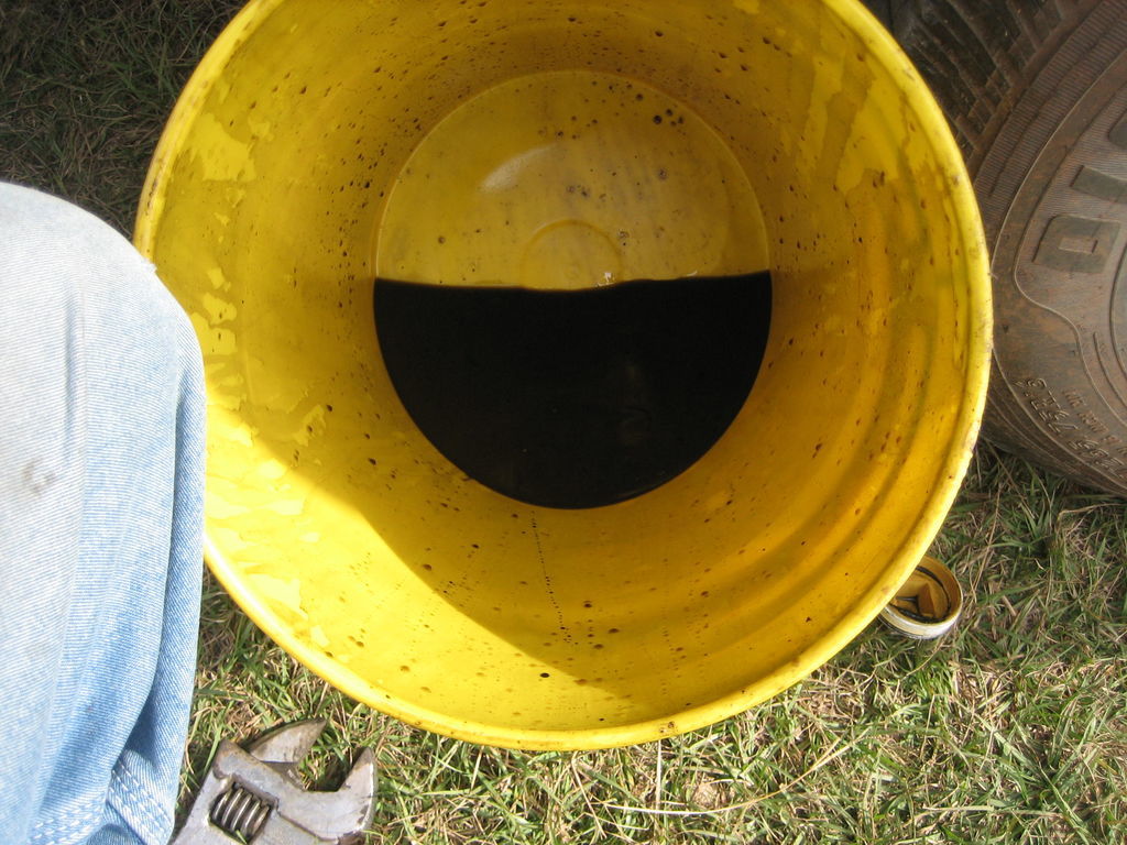

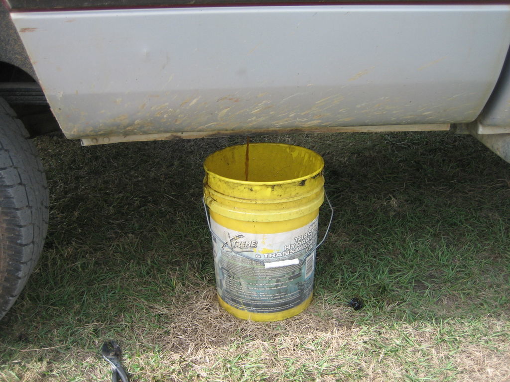

I have monitored the v-10 ram over a 24 hour time span now. This includes a trip to the coffee shop Sunday morning, visit brother, feed cows, visit friend, drive over farm and timber and a trip into town this morning.

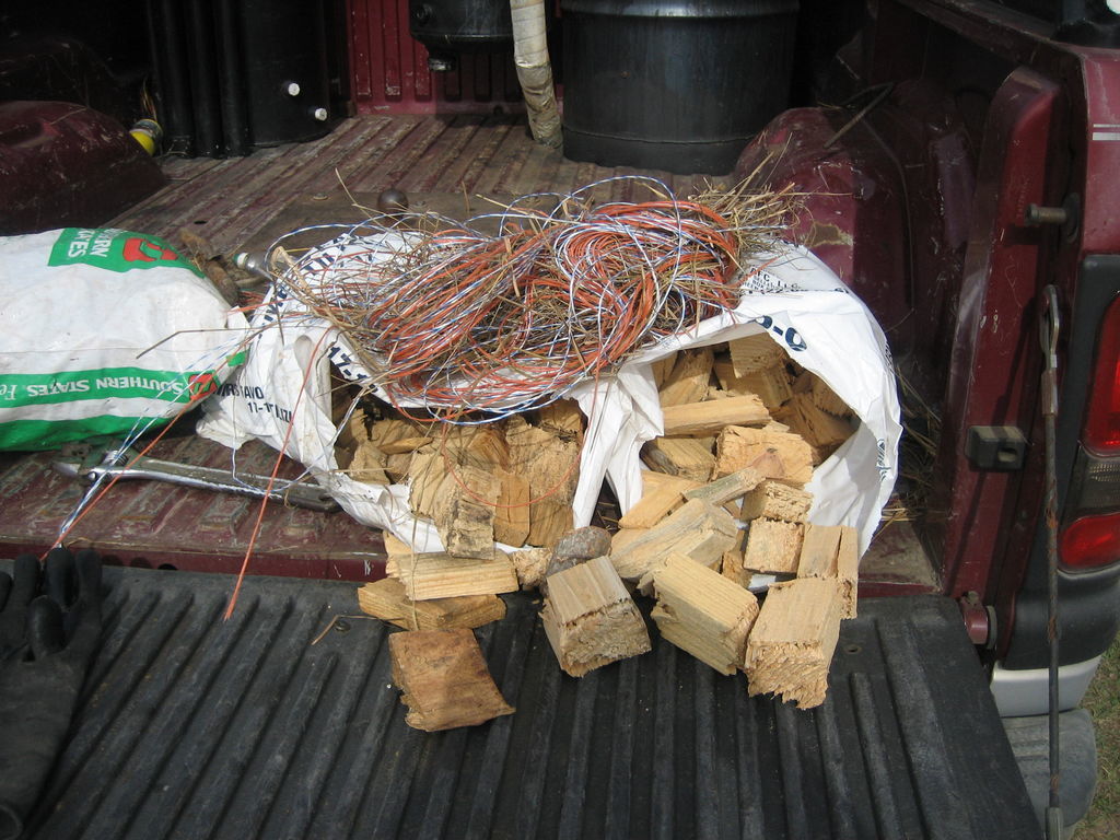

I have driven 56 miles, have shut down and restarted about a dozen times, one relighting this morning. The fuel used was about 70-80 pounds of wood, (moister contend unknown) and a hand full of plastic string from hay roll.
Part of the day the humidity was 90 plus but most of the driving was around 50-60 %
Most of the miles were speeds 40-60 mph and a few 75. About 30-45 minutes of driving was done at idle speed in low range checking cattle in the pasture and locating down and dead timber, only about a mile was added.
The hay filter contained about ¼ gallon of condensate, the condensate tank about ¾ gallon and the fuel hopper condensate tanks about 1-1/2 gallon.
Keep in mind the more condensate from the fuel hopper is a good thing.
