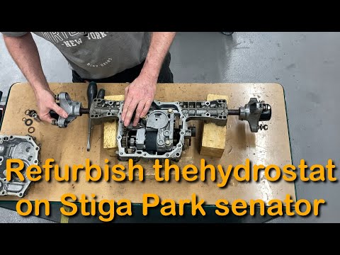

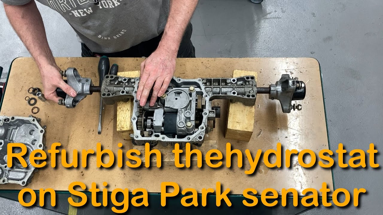

Hey TomH. Your wish is here:
I’ve been viewing YouTube on these Tuff Torq transaxles to see how/were to add lower cover draining plugs. This video the fellow does well using the right terminology. Oil Pump; fluid driving a hydraulic/oil motor. Driving motor speed and torque external lever controlling that wedge plate left and right varying the piston plungers strokes. And the only video I’ve seen that explains the actual reversing method.
Ha! Ha! All of those are easy pull-out; drop-in parts. Easy. What could go wrong? Ha! Almost all parts are able to be installed flipped, or reversed, then not-right! And he misses explaining an easy fall out, then lost drive-pin in the motor section.
But, hey. On his with the hex spacer above the fan he is able to drill drive it to check for functioning before installation.
Excellant practice piece project for you to feet wet on @tcholton717 .
