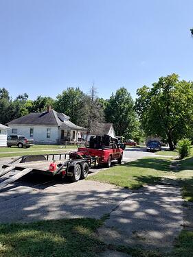

I pull a trailer big enough to fit a car. I have probably had 1200 pounds on it. I also have a 12 foot enclosed trailer that I use. The truck is a 1998 Dakota 4x4. I live on the edge of a town of 60,000 people. I usually drive side streets. I have pulled the trailers on two lane roads on 100 mile trips. I haven’t been driving on wood long and prefer to not get into tight situations. The later model truck handles trailers better than the 92-96 square bodies. I wouldn’t try to pick up speed to get on a busy expressway. The truck is pretty sluggish pulling a trailer. Better braking ability than the square body trucks, These later model trucks are heavier and catch a lot more wind. Going 55 is pretty comfortable. Have to hybrid some gas after that. If I pulled trailers on a regular basis or heavy ones I would get a v10. Hope some of this helps answer your questions.
