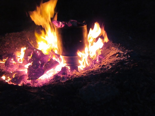

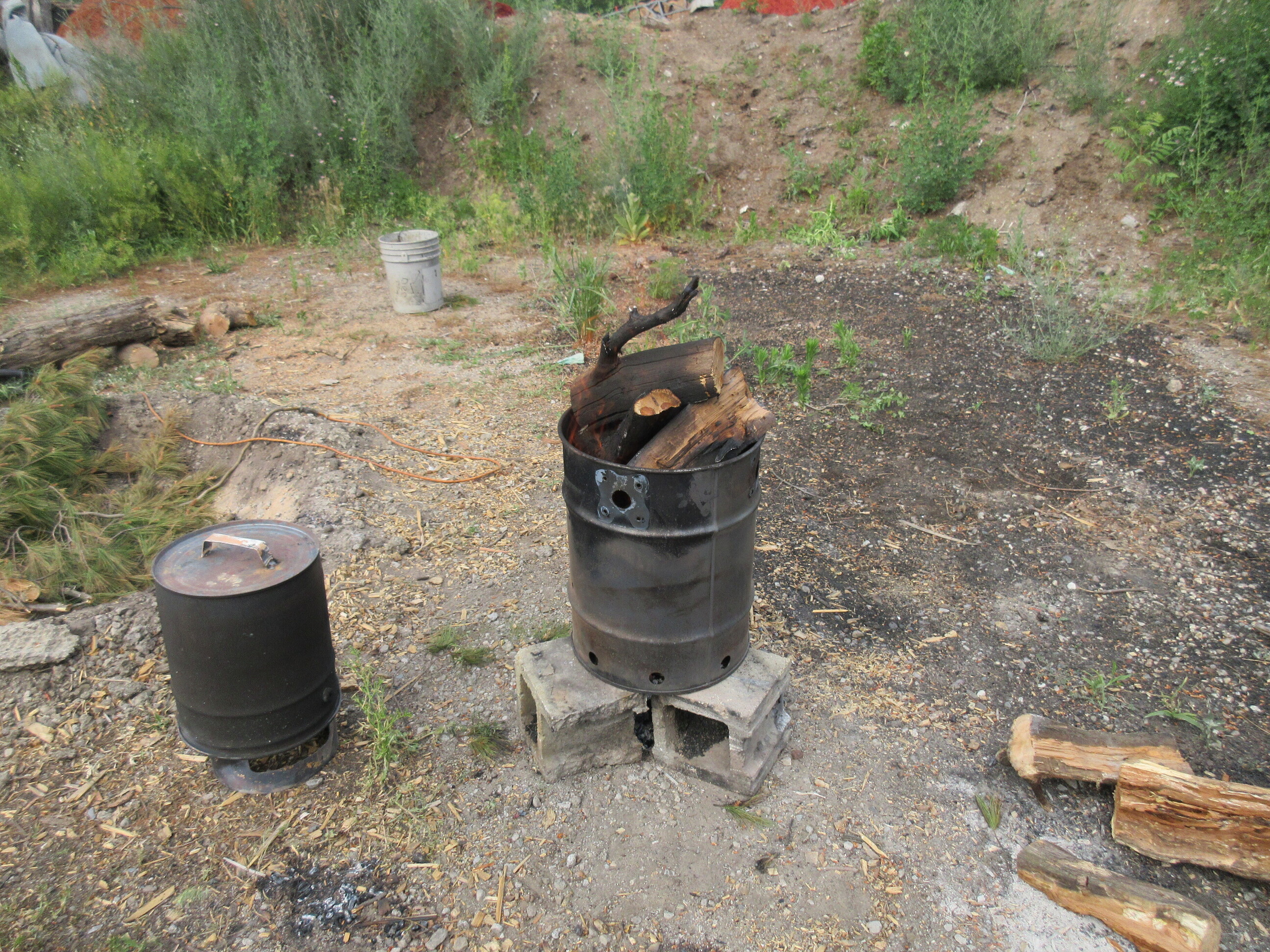

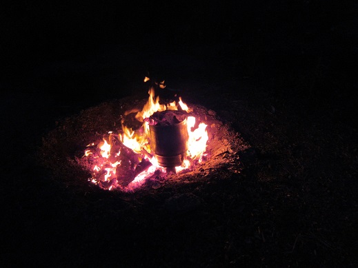

Makin some charcoal!! I made a kiln out of some obtainium I had here. This was plan A, It didnt work so plan B chuck it in the fire!! lol

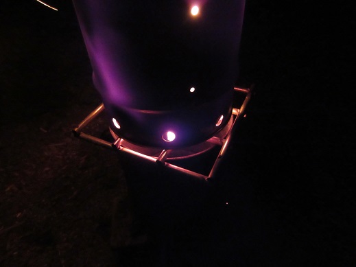

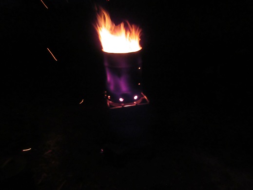

What I tried to do is turn that oil burner that turned into a wood burner into a furnace to fire the kiln. It turned out with out the chimney it make charcoal on its own. So going to mod that stove to work as a partial burn retort. The kiln I have plans to rebuild it so it can get much hotter.

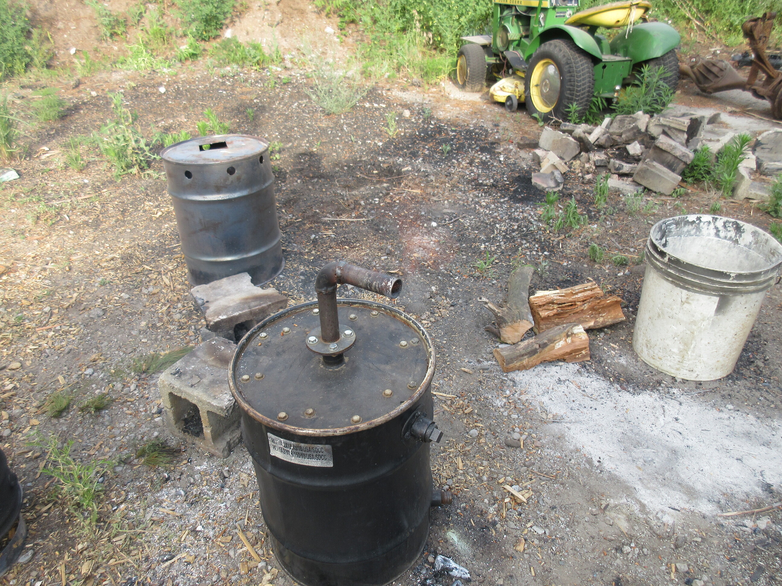

The Fusion Charcoal gasifier is now in production, I have quite a bit cut for it already. Ill start welding here soon.

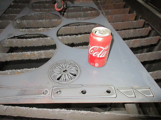

Here is the little tiny grate; inst it cute?? haha that is tiny compared to all other machines

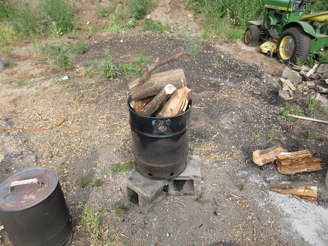

So I completely scrapped the kiln idea, Im such a newbie here haha!!.
Just a barrel with holes in the bottom is all that is needed.
So Im going to work a new version of this but using the breaker system from the stove with a barrel for collection bellow. Fill it up, fire it up and turn it on. I can program a timer into it so the crumbler will wait for it to get good and going before it starts to process.

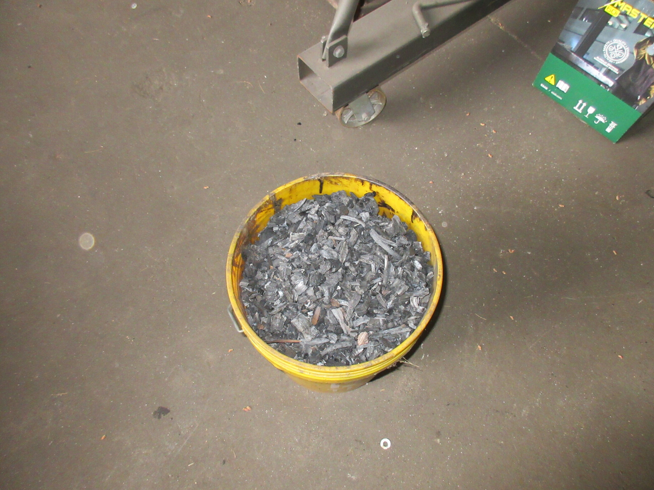

Moving on, I cut out the bottom of the burn barrel and put a passive grate under it with a catch barrel underneath that. It worked fairly well, I think if there was some sort of agitator It might work a little more effectively. If I can get that to work then you just keep feeding it.
I’m really enjoying your posts on this topic. I can’t stop looking at your pictures and thinking about “Automatic Firewood to Charcoal.” The grate and catch barrel is very clever. I imagine a rotating bar with a few large cams on it positioned just above your grate. Use nautilus-shaped cams that lift gradually and drop suddenly, preventing jam-ups.
My best results for pyrolyzing “firewood” have been with a Curtain Kiln blowing air across and slightly down into the Stainless steel lined burn chamber. More complex and a lot hotter operation, but it eats wood fast, is smoke free and makes nice charcoal.
Love it, Yeah Kristijan was right I and had suspected the rotating busters would be a bit over kill. I think Im going to remove them and build a grate system exactly like you mentioned.
