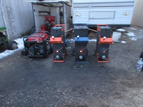

That was my original thinking.and if that failed i was going to try to add 2 more cooling and filtration systems and then connect the generators to those.so it would be 1 gasifier combustion chamber with 3 exhaust pipes leading out with there own cooling/filtering system at the same lengths .Steve wouldnt that solve the 3 kids drinking a milkshake out of a single straw? It would be like adding 2 more straws…by the way once up to power all generators will be running equally at the same rate of power without idling

Here is a better solution. A charcoal gasifier can be built very easily and cheap. Now if you have three gasifier you can network them into a one generator. So now you have three units and you can run all three generators or if you only need the one generator you can then team your three gassers together to extend your run time.
