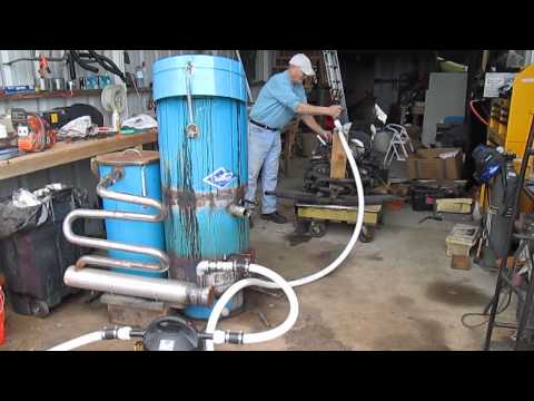

Hello Gordon; Just watched you latest glare. Looking good. I’m still seeing moisture in the flare. Think in turns of insulation to get things hotter to maybe break the water down. The one thing that concerned me is opening that air valve. I have never seen a gasifier where you controlled the air going in. That is usually free flowing and determined by the nozzles size, restriction, and vacuum. I’m not saying it is wrong but does make another variable that you have to contend with. Oh, the final thing is the sneeze. It did come late in the run, I would have expected it earlier. When you started this run you did not fill the hopper all the way to the top. When you closed the lid you trapped air in the upper part of the hopper. Eventually the pyrolysis gases mixed with this air and formed a volatile gas. it got spark from the nozzles and exploded the gas in the upper part of the hopper. If you fill the hopper it may sneeze a little but not as bad. Other wise if it bothers you, set a piece of news paper on fire and drop it into the hopper and quickly close the lid. The flame of the paper will eat up the air. I must say you are making great progress.TomC

Good advice as always. I think you are right about the trapped air in the half full hopper. I’ll try the newspaper trick next time.
The inlet valve is for closing off any air to the machine after a run. no oxygen = good char for start-up. I should just open it or close it. Regulating my incoming air was the culprit to that pop. I really think it was turning up the vacuum and not opening the inlet valve all the way that caused the lid to leak a little oxygen in and boom. From now on that valve will be open during a run and closed after. Thanks for your observation. very helpful to my thinking. better try to post

Yes that was a big bang instead of granma’s fluffer. I have experienced that hopper lid flutter,but that bang was a pretty sharp crack. I think I sucked air in when I turned up the vacuum without opening inlet valve fully. I bet you had a kick watching it and laughing. I get a good chuckle when I see it now.
I have a fix in mind for the hopper seal. It will also fix the condensate dripping down my purdy blue hopper.

Sofar my design with the air baffle and grate seem to be working good, however I am noticing that the flow of gas quality seems to go up and down. I think this is due to bridging. I can cure the bridging without a full redesign of the hopper. Right now the gasifier is stationary. but going down the road will be no problem. I want her to function stationary tho. I dont think I need to shake grate hard but light movement couldn’t hurt.

Your last video— put the lid down on the gasifier and run the vacuum a little before you try to start it. As it was you were running the vacuum and pulling more air into the hopper and the lower part while you were lighting it. This way your torch will eat some of the air and your charcoal will eat air, and that is all less air to feed and explosion when the pyrolysis starts making volital gases. In the latest video it appears you changed your blow off lid. I can’t help but think you don’t have enough springs on your lid. I think with the light springs, you are seeing the entire back fire. Heavier springs will require the pressure to build up more and then the spring will shut off the back fire. Try closing your mouth, then blow out through your mouth. Now, open your mouth and blow. More air comes out and faster when the mouth is open.TomC

Yes TomC my eyes were wide open on the first pop. I wish I had a video of that because it actually did run great after I found the sweet spot air/fuel. I actually got the engine to rev-up well! A sustained high rev with just a manual air mix. I was hooten. You are most likely right about the springs. Today was my first day of trying an engine.
