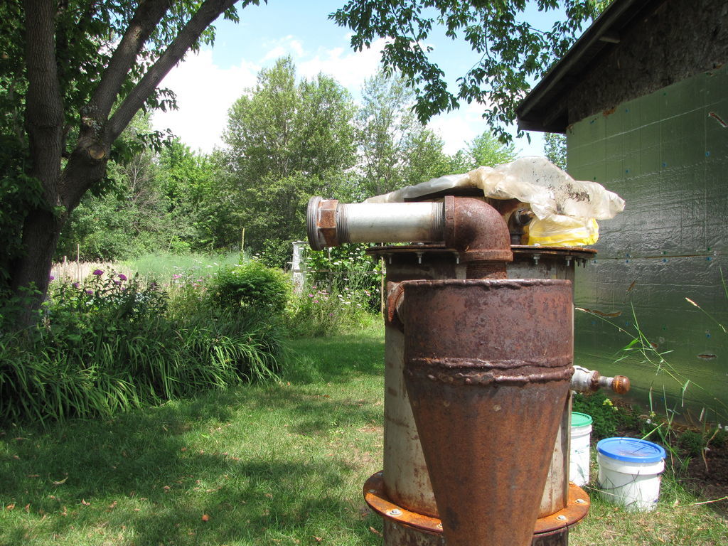

In your obtainium/MENS theme now you have a workable hearth go bone out a few self cleaning ovens for their good high temp 1000F capable insulation. Now try externally wrapping your oxidization/pyrolization/lower hopper zones that I can see in your system pictures. Hold in some of the heat now bleeding away and force it to rise up internally and watch your system performance jump up a big step.

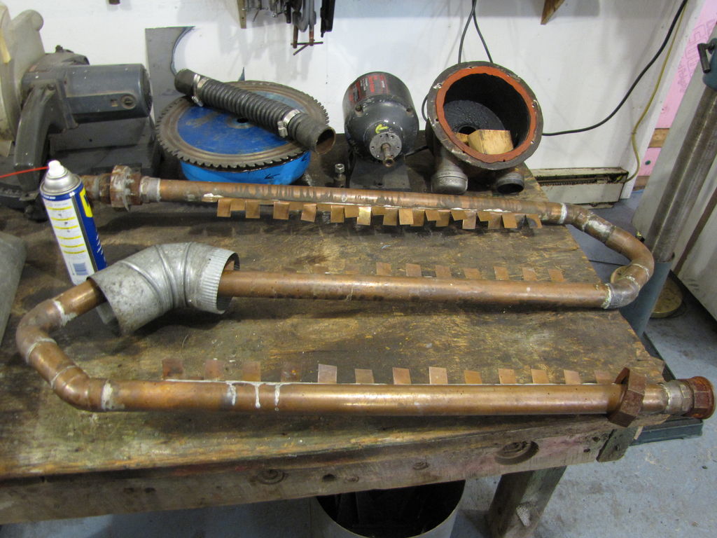

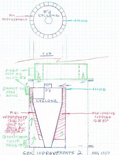

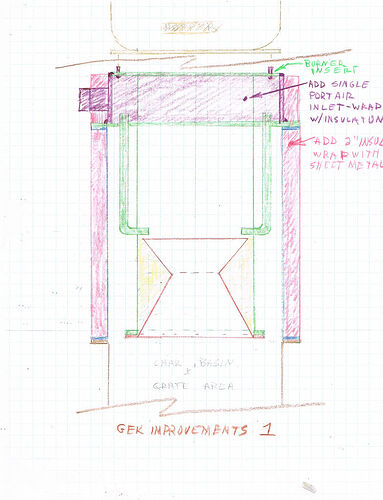

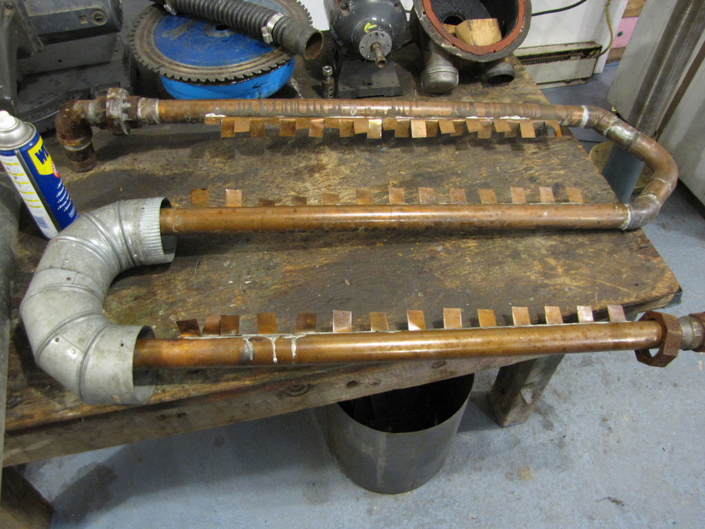

Hi Everyone, My single port air inlet manifold retrofit beat the Titanic to the bottom. Leaked all over, so I scrapped it for a little redesign and a few other improvements.

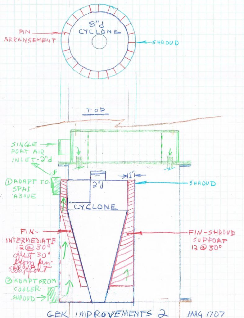

First I will install a single port air inlet of a different design (and easier to weld). This will involve cutting off the existing air inlet elbows to make room for wrapping the flange with light steel leaving a single large air inlet. This inlet will be fed preheated air in the following way. I will insulate the burner shell. Next I will recapture the cooler and cyclone heat with a finned shroud on cyclone and a 4" stove pipe shroud around my S shape cooler.Therefore the air is pulled in at one end of the S cooler, exits and is fed to the inlet of the finned cyclone shroud, exits and is fed to the single port air inlet at a high temperature. The SPAI can also be insulated. This will all be in line and require some imaginative adapters between components. Can’t wait to get started. Welding on the fins will be good practice for an eventual go at the WK
UPDATE 1/29/13 I did not use this cyclone plan and posted pics later on of new design. I also will build a vertical tube cooler with condensate trap and drain.
Also I noticed the gas outlet port is missing.

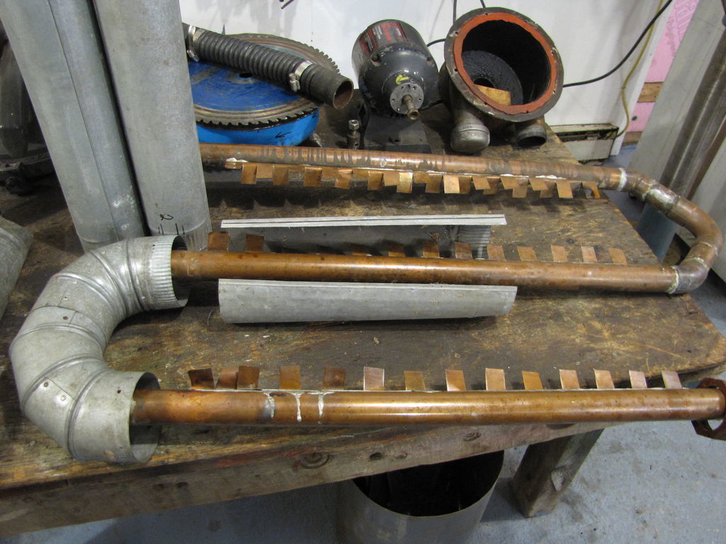

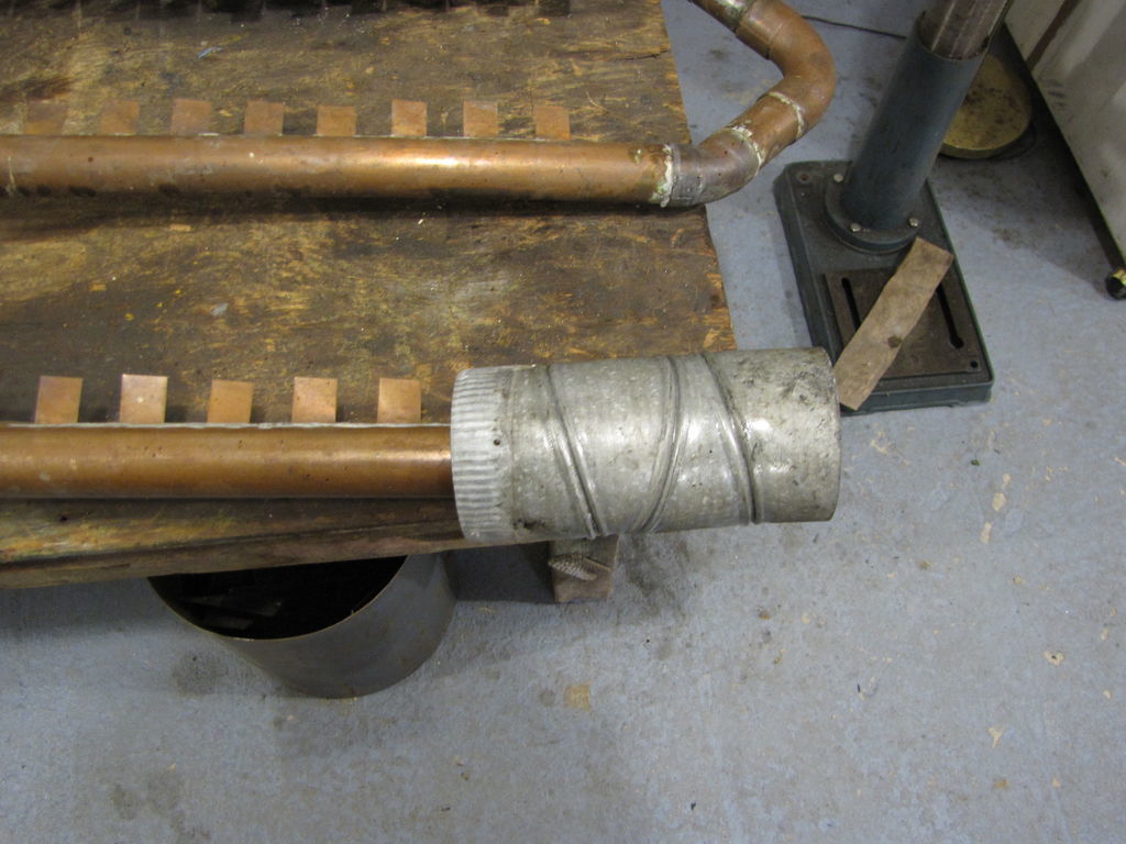

Guys, Lest you think I designed it this way, the stove pipe fitting like this was pure good fortune. I built the cooler almost 2 yrs ago when I didn’t have a clue about gasifier preheat importance… I might add that heavy galv like this is a bear to snap together over the copper. I’m going to use 4" aluminum. The adjustable elbows need to be turned and tweeked but they will fit! Mind your matching ends. Pepe
UPDATE: 12-11-2014 I never followed through on this for preheat. I did build a more effective cooler. See later here.

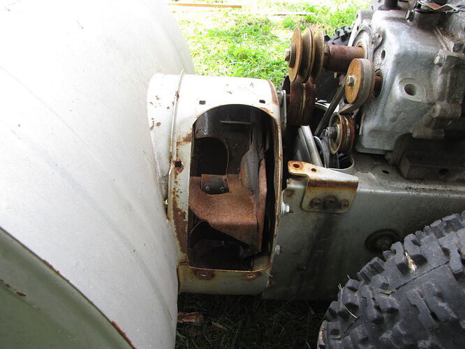

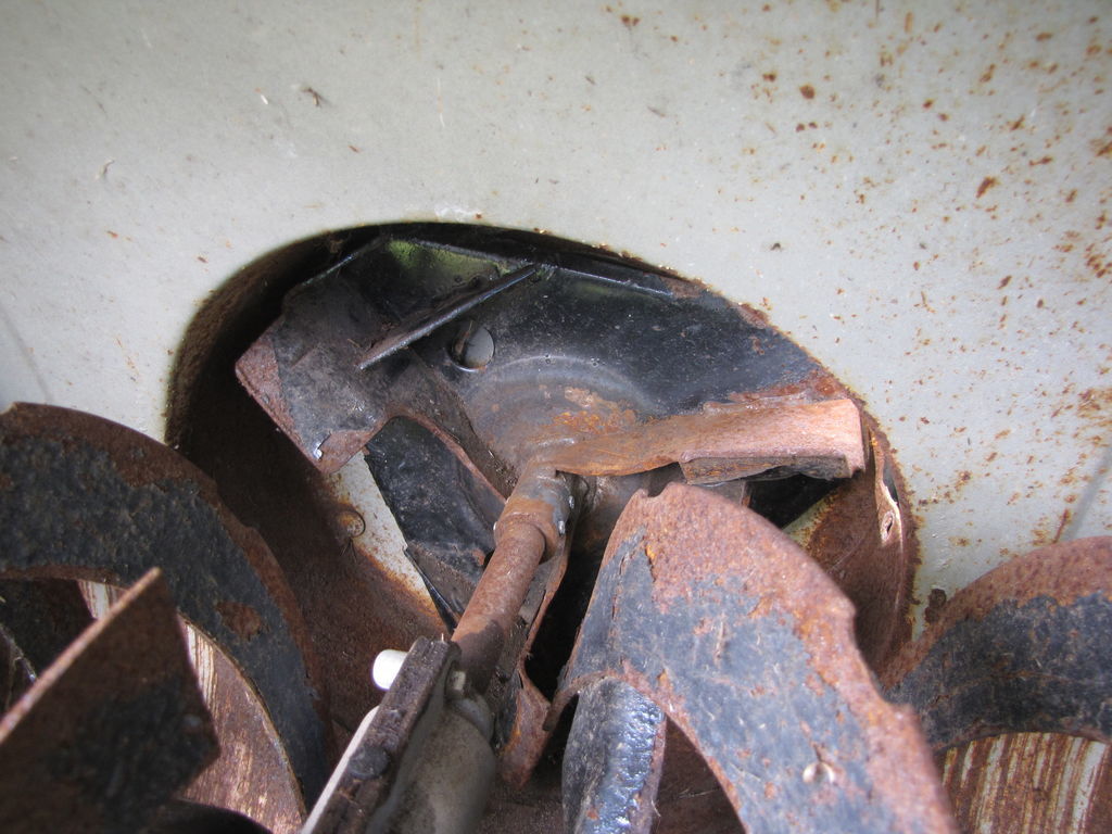

I got to looking at the snow blower and realized I had a snow fan. This has a bearing on the right in the housing(which also has a cut out for a tangential snow chute) and a drilled shaft adapter with 4 set screws connecting it to the auger drive. It’s a 12" d. I’m planning on removing the blower and use the pulley system adapted to run several alternators. Then I’m going to make a blower fan out of the snow fan. Well, not right away, of course.
Shovel it, why? lol.
Hi Pepe
Good to see you thinkin’ and doing. BEST way to improve hearth performance is to conserve it’s own heats.
Your old snow blower is now your lemon tree of resources. Exhaust heat off of this is your 2nd most important heat to put back into the overall process on a small stationary system IMO. EG: GEK Hotottie and Mr Waynes and others engine exhaust to primary air heat exchangers. This heat is so intense it is difficult to use for fuel drying unless diluted down with blended in cooler air. Why waste it? Lower temp engine cooler air/coolant heats and fuel gas cooler heats are already just right for wood fuel drying.
