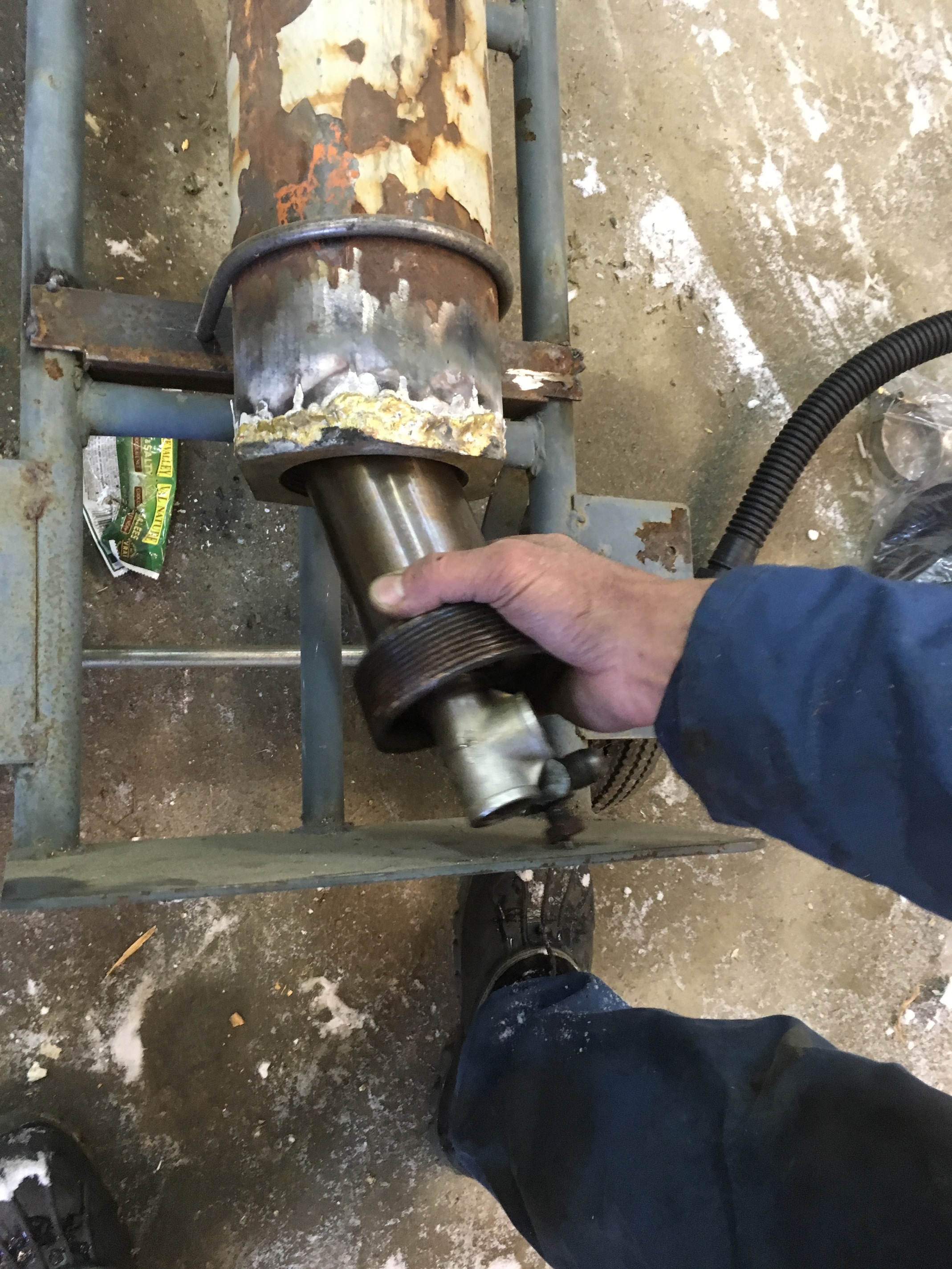

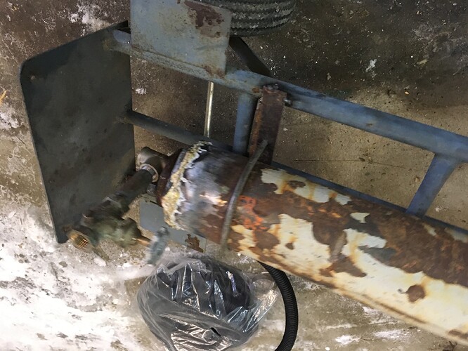

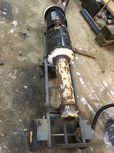

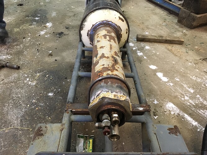

I had a little time to try a new set up, here are some pictures
Looking great Thierry

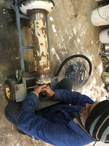

very clever construction on that cart, easy to handle for tipping or moving around
For testing its easier to use a short tube between gasifier and engine, less drag more gas

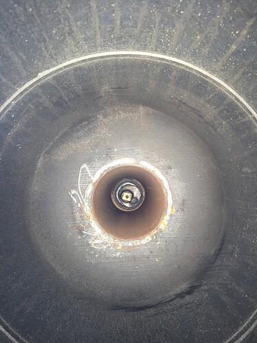

Looking great! Any idea how the nozzle holds up?

I shorten this pipe today, thank you Koen
I only started the engine on the coal gas 15 min, not egr, no H2O. I think my coal, or the ambient air, is a bit damp. The flaring of the gas was white and the color of the red oxidation zone (1000/1100 C, I think)
I hope to check the nozzle today

Jeff, I want to work with dry charcoal to test, the heat exchanger in my aluminum bath nozzle.
To cool the nozzle I have to circulate the steam inside. If the coal is wet no overheating of or no test

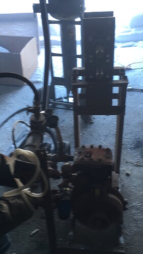

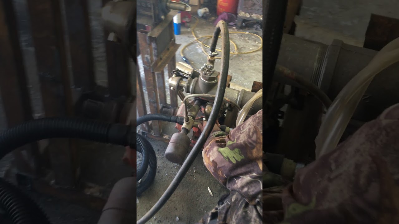

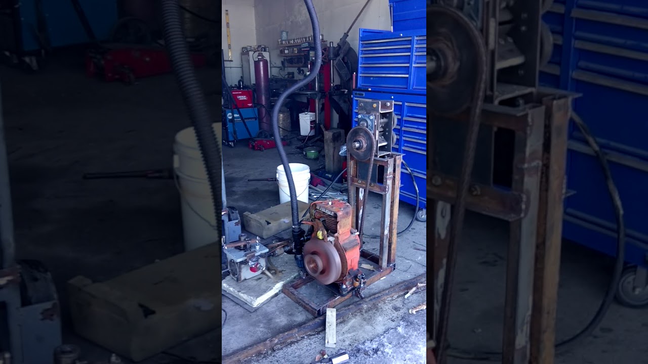

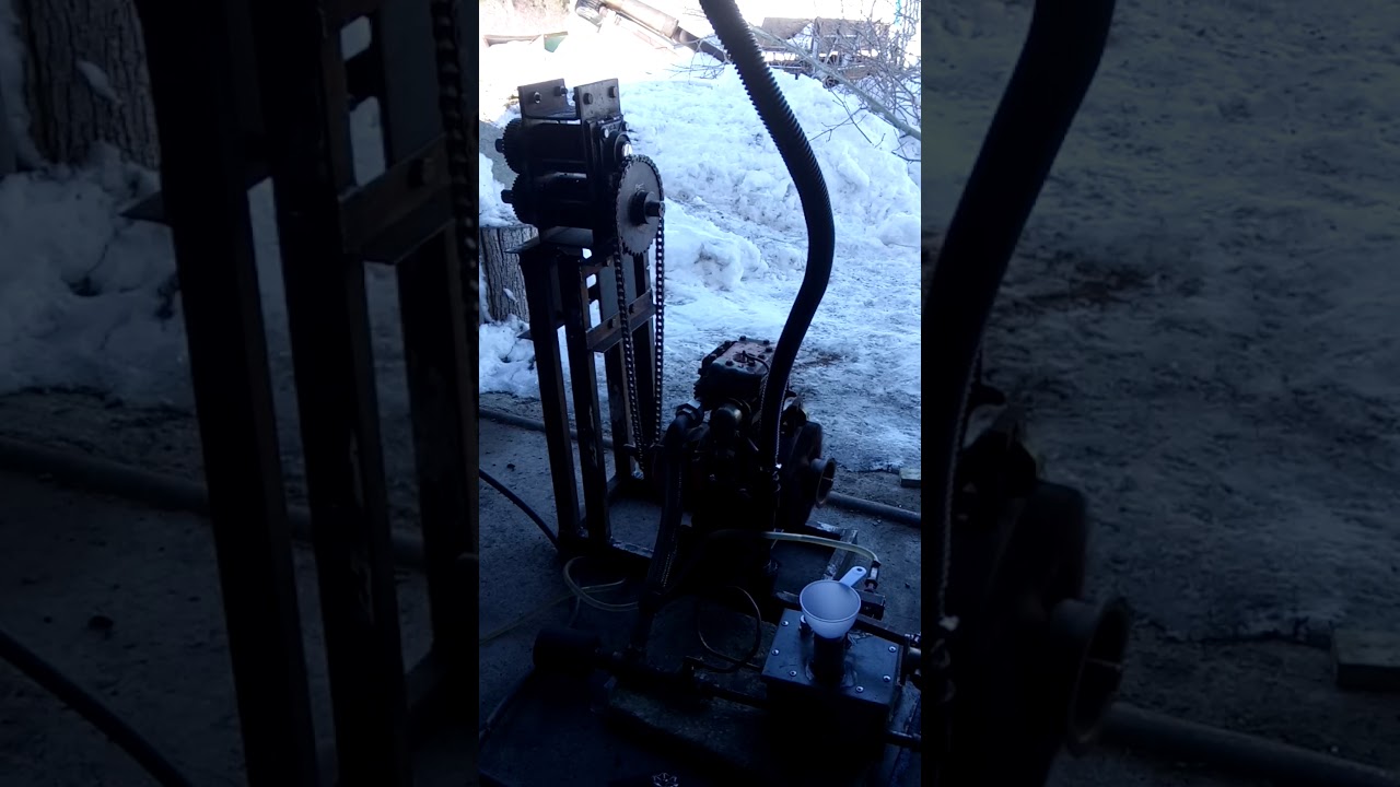

New tests
I have to close the air almost completely in the mixer for the engine to work. yet I do not see any air intake on the line. Did you think the coal was too thin ? (causes a lot of restriction?)

Wow! Rebak running on wood!
I like it a lot. You never mentioned your rebak was finished, or did I miss something?
I think there are only two possibilities if your air valve has to be almost closed. Tight charbed or you’re leaking air in somewhere else.
Jo I do not consider that my rebak works very well (machining homemade not very well done) I try to recover my errors of adjustment to make it functional ![]()
Dont wory if it doesent work first time, myne didnt either. With some help of JO who has most experiances here with Rebaks l managed to get it goeing good.
Its important that the blades actualy allmost touch and overlap/slide one a nother. Like scisors. Then you will be able to gring eaven litle twigs.
Hi Thierry,
Try to find some airleakage , might be almost invissible but still…
