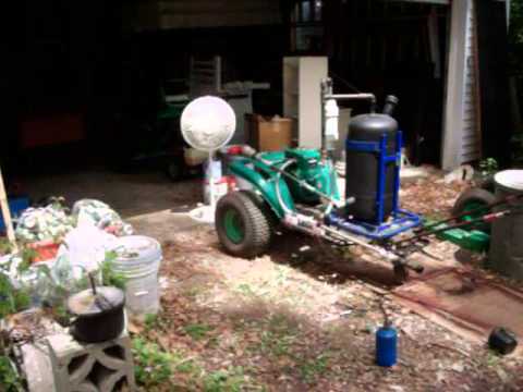

Hey tom, you can use softwood charcoal you just use twice as Much volume wise as hardwood. I am using softwood charcoal in my tractor. Processing it you will find more waste and dust then hardwood as well. For nails I remove all I can catch. They seem to always find a way to weld together and obstruct my air inlet with slag…

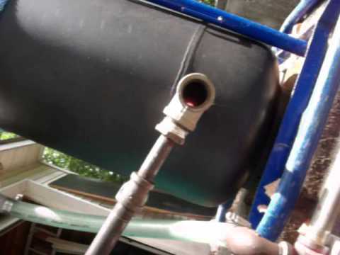

Hey Dan, it looks to me like your charcoal is too coarse i.e. the pieces are too big. The charcoal guys that run small engines have processors that grind it up and then screen it thru a couple of screens and use everything between 1/4" and 3/4". That gives a whole lot more surface area to react and make richer gas and with a hotter burn it might also convert some of that water vapor to H2. Bruce Southerland in the charcoal yahoo group made up this sawblade roller to grind up his charcoal.
Judging by what appears to have been a puff coming out of your observation/lighting port when you went throttle up, I’m going to put some window screen or something over mine, and establish the habit of using a mirror to check nozzle “color”.
Eyeballs don’t grow back.
Don, That charcoal grinder looks pretty sweet and easy to make. I’ll try smaller pieces. sounds logical. Alex, Yeah I wear safety glasses when ever I am doing any project. Eyes are a blessing for sure. Peace!
