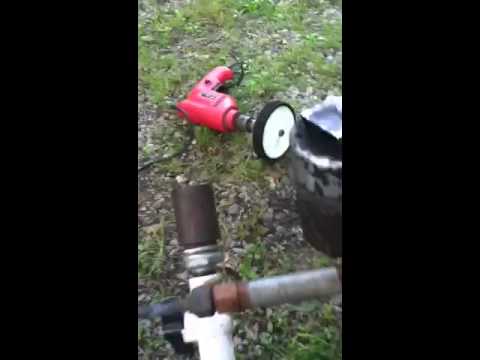

Thank you gentlemen. I greatly appreciate your comments. I have followed this site for many months and just recently decided I might have something to share with the group. I had made the video to show to some “Nay-sayers” at work and thought I’d post it here. My goal is to build a larger system to run our 1988 Jeep wrangler. My wife thinks I’m a little crazy but a genius at the same time. Ha ha. The system on the video will eventually power my 4000 watt generator (bought at pawn shop for $75 because it wouldn’t produce power. A set of brushes fixed that). I’m not brave enough to start the woodgas system yet ( Soon, though. Ha ha). Thanks again for the comments and letting me join your group. Dan Wilson (RadicalDanZero)
Hi Dan, Watching your video reminded me of the excitement I first felt when I realized the engine was really running on charcoal. Yippeee!!! Welcome to a small, but growing club. If I may make a suggestion, put your start up fan after the filter. This way your filter will also be filled with gas which makes it easier to start the engine. The past three times I started my log splitter engine (about the same size as the one you are using) it only took one to two pulls. Charcoal gas is nice in that it does not gum up the carb like gasoline that has set for a year.

Thanks for the inspiration Mr. Gilmore. I realized the fact about fan placement AFTER I made that video. Ha ha ha My arms and shoulders were sore! Placement is important. Maybe an electric starter is important too! Ha ha.

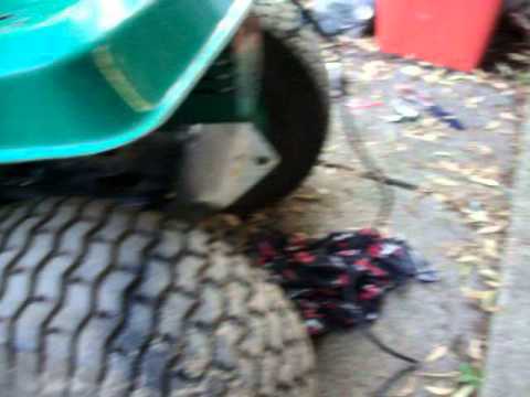

I am loving this project. It is nice to see something working first hand. I mounted the generator on an old riding mower frame so I can move it to where I might need power. I’m thinking about putting a radiator between the gasifier and the filter. It is getting really hot.
Learning from our mistakes is half the fun.
using the old tractor frame.

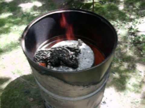

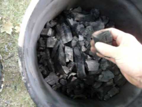

Looks good Dan, Its hard to see from the top view but it looks like 1/4 to 1/3rd yield. Did you start out way full? Thanks for posting the vids.
Yeah. I started with a full drum and ended up with a little over a third after I broke it all down into smaller pieces. It was mainly scrap pallet wood from my woodshed project (Building a woodshed from scrap pallets.) and some small limbs from storm damaged trees over the winter. It was a lot easier to make than I thought. It is awesome listening to the gasses burning from the bottom of the barrel when it gets hot. Sounds like a furnace blower.
I love the “tinkeling” sound of your charcoal, well done, i love it…
I have made three batches so far and filled up a metal trash can (30 or 40 gallon, not sure). Much easier than I thought. Once the drum gets hot and starts blowing out the gas, it pretty much is self sustaining until the charcoal is formed. I don’t really burn much wood in the large drum overall. I love the sound also. My wife looked at some pieces that were still in there original shape only burnt into charcoal and she said “that is almost pretty” Ha ha ha
