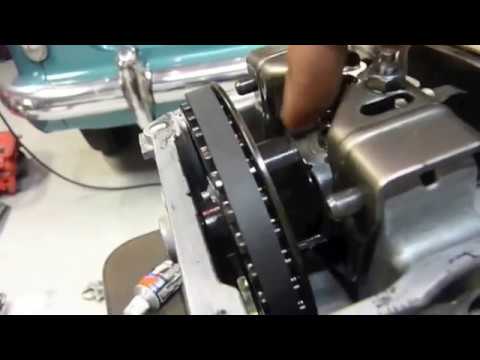

The best IMO video is this one:
Shows all the naked beast in all of it’s glory. East of repairabilty. Availability of parts. He’s doing this without a repair manual guys.
Youttube guys of desertduelsport, crazydjhead, Saeid Momtahan II and others are real wrencing gearheads.

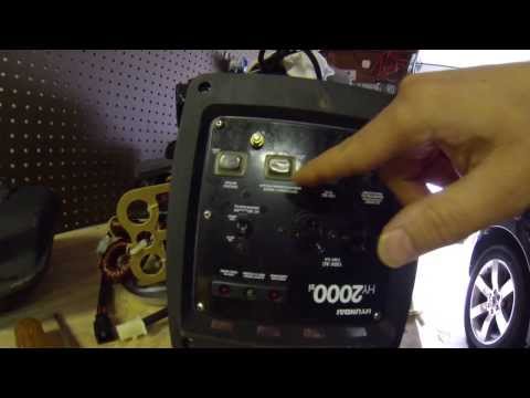

Not a Robi, BillS. But a very unhappy 30 hours later fellow with a Hyundia named brand:
He ate crow over his original video mondo load testing, saying, “I could buy two of these over the price of one Honda.” He later realized then both would have failed in the same ways.
