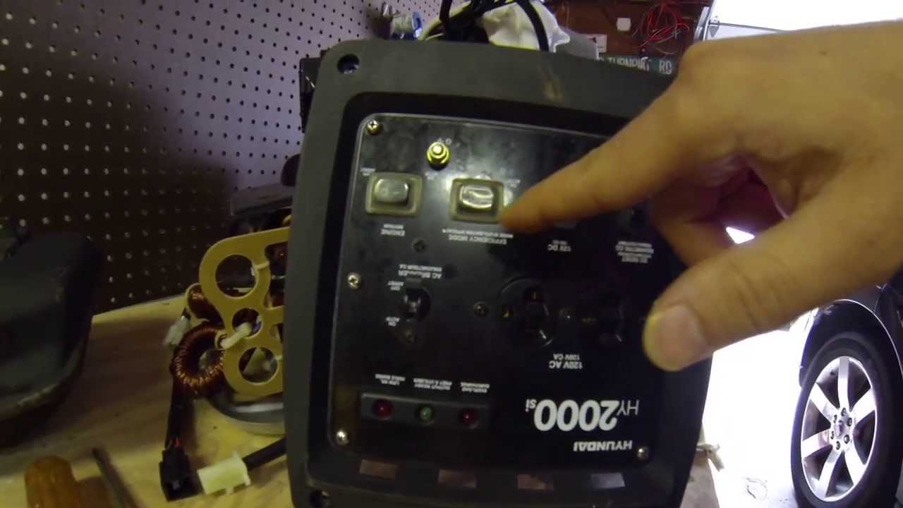

Not a Robi, BillS. But a very unhappy 30 hours later fellow with a Hyundia named brand:
He ate crow over his original video mondo load testing, saying, “I could buy two of these over the price of one Honda.” He later realized then both would have failed in the same ways.
