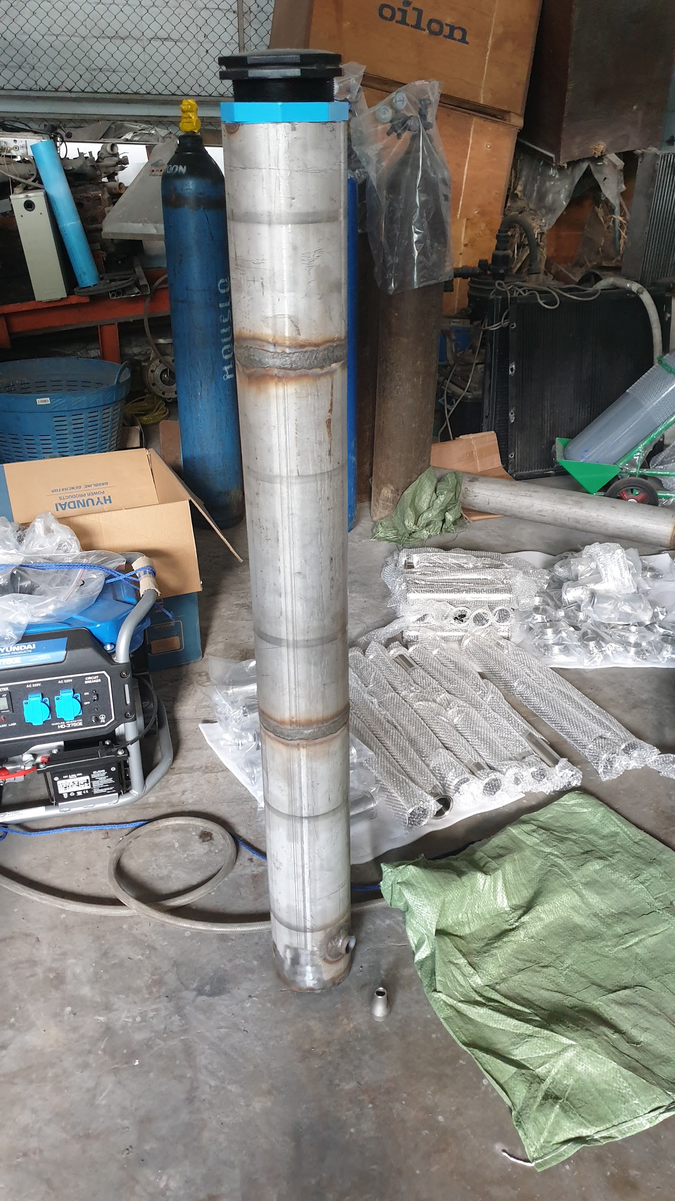

My little "outback" "farmer" charcoal gasifier
Based on my own experiences and learned on DOW , subsequential learned from the feedback during teaching around here…
This little one is kinda expressing my opinion on how i think a gasifier “should” be…

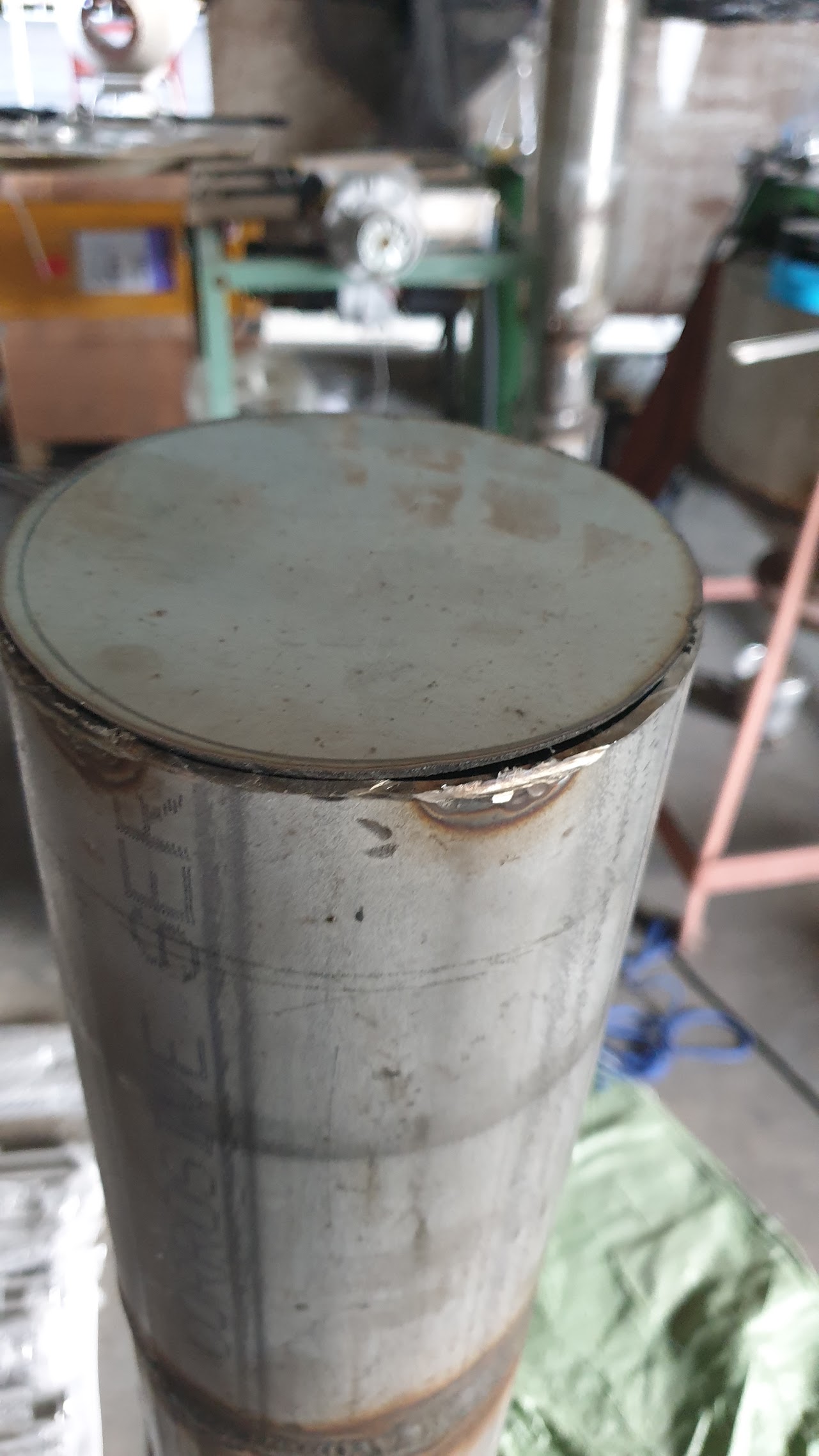

I will post some dimensional / drawings / parts / pictures and after that running it on a small genset and waterpump ( my favorit )

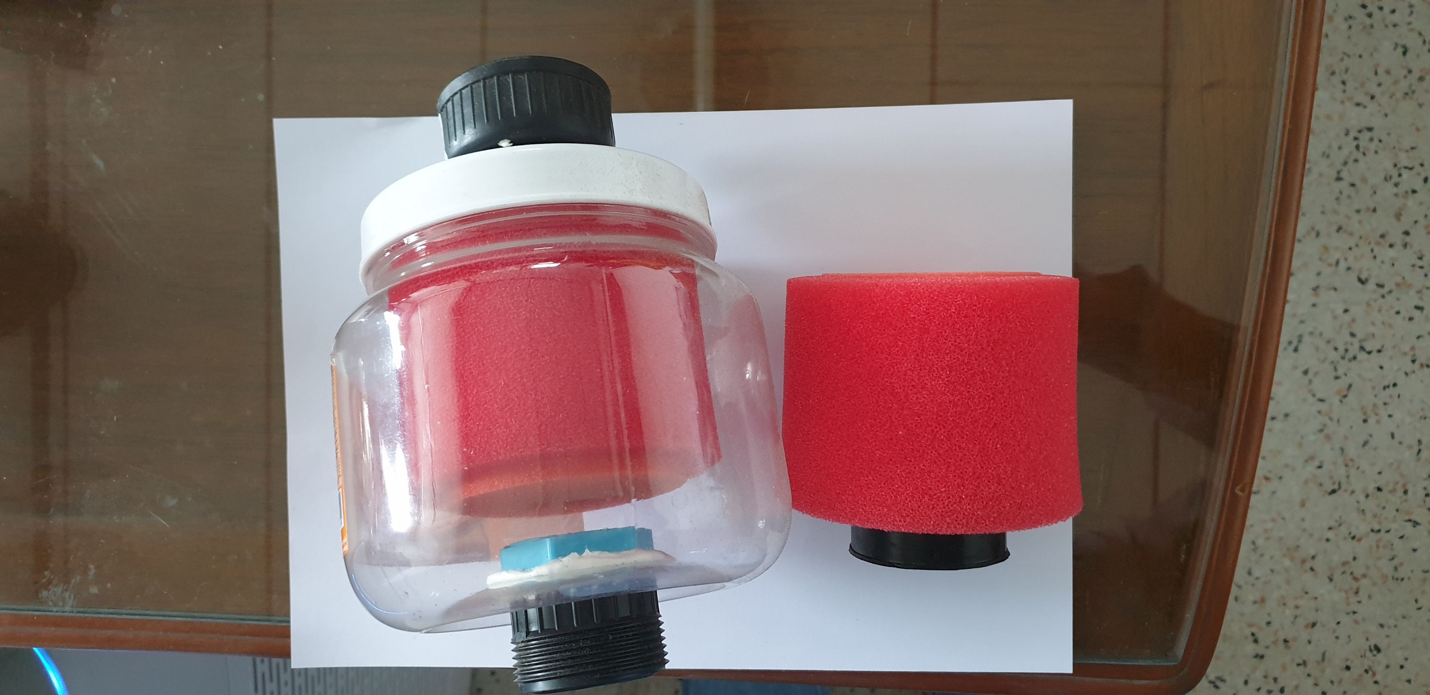

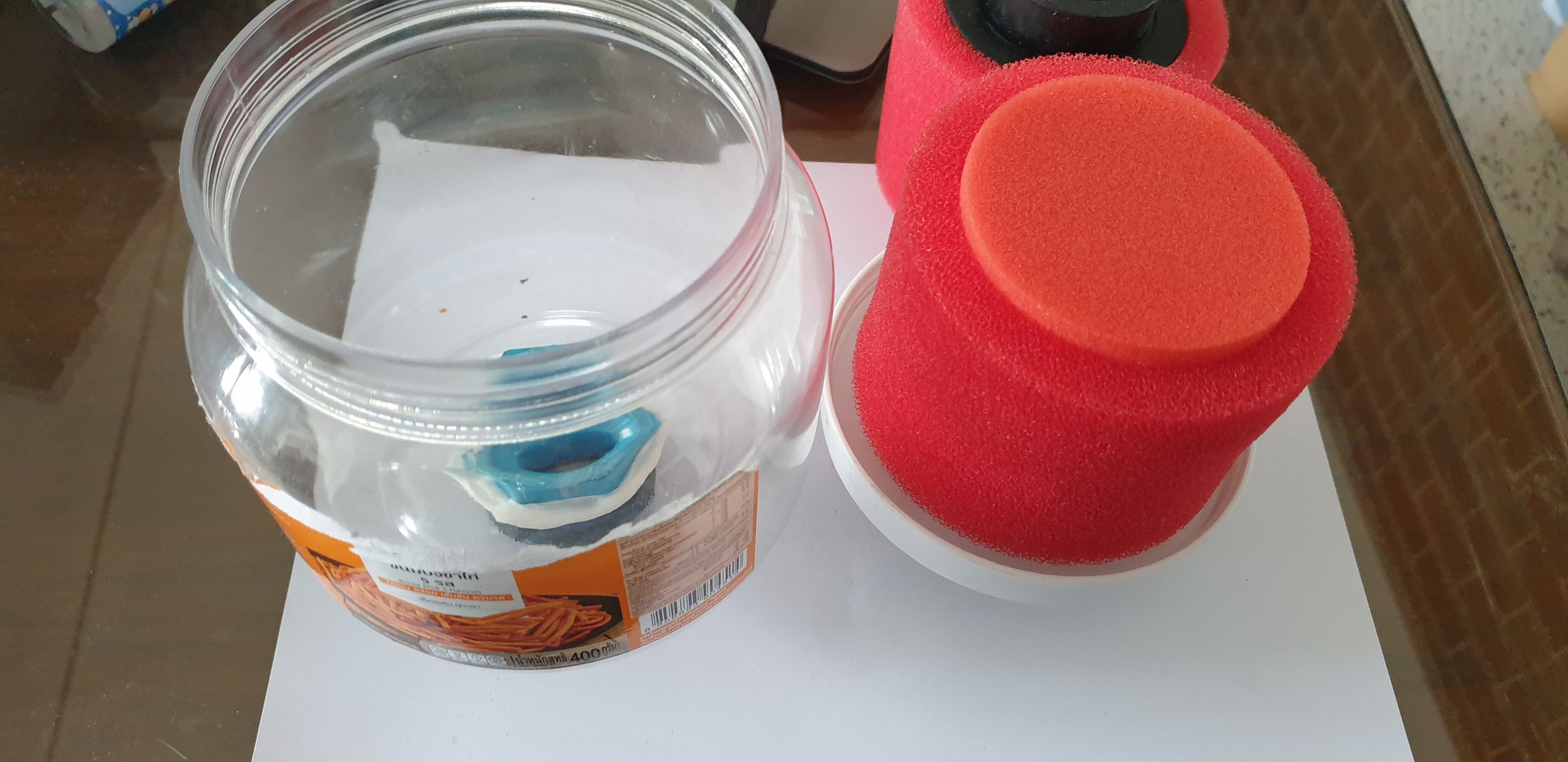

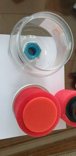

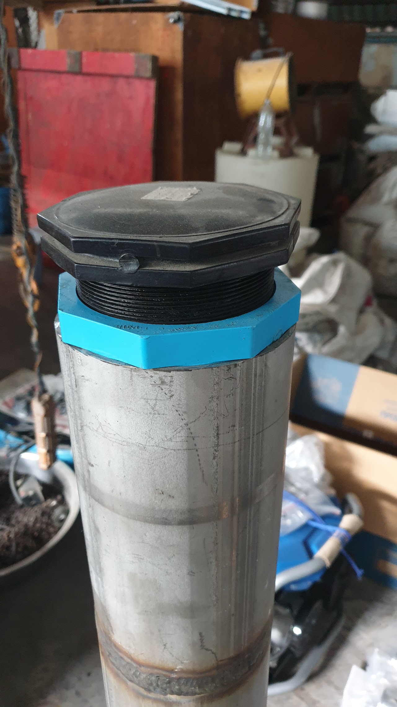

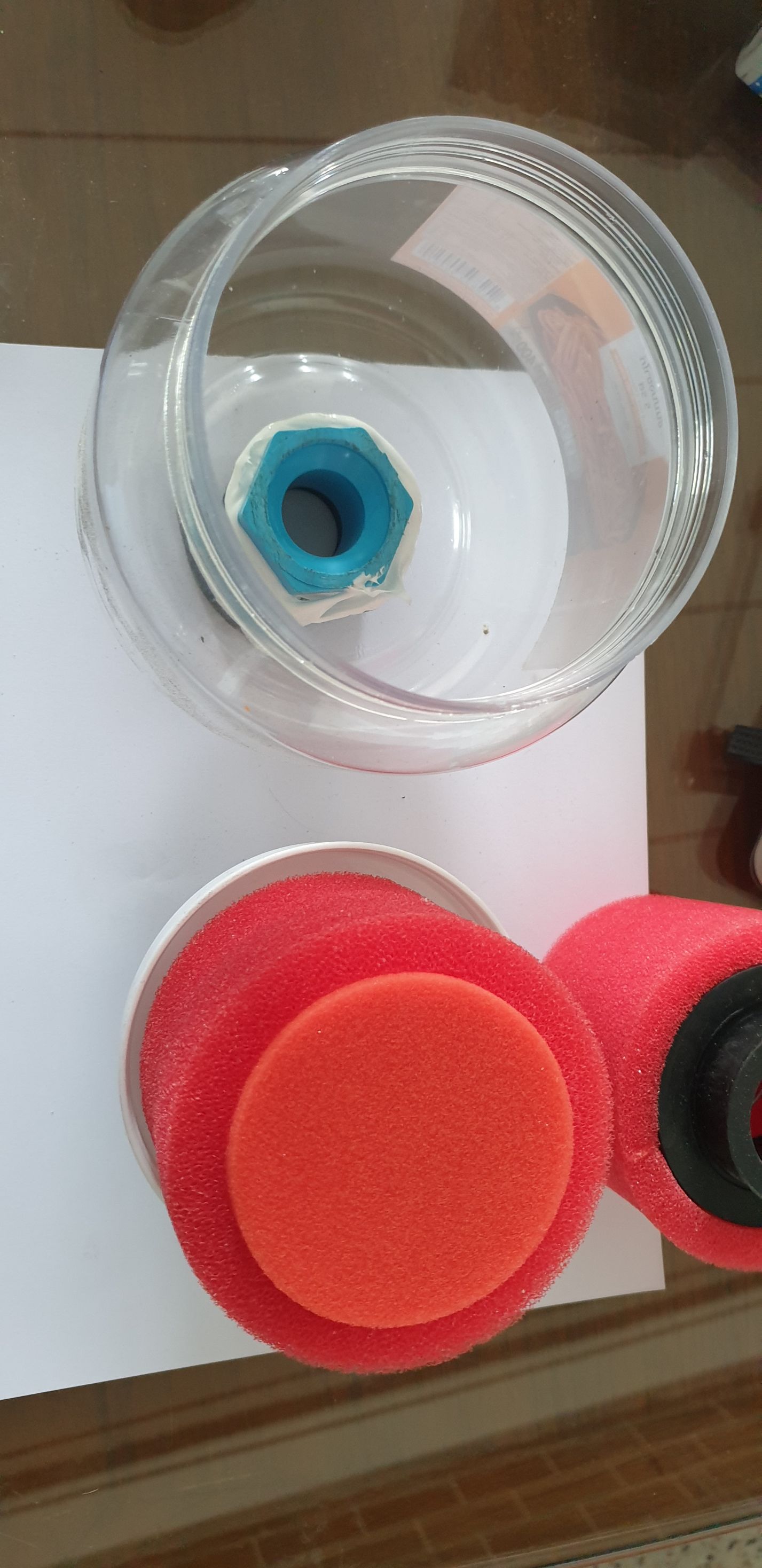

Filters i am using for this:
1: cooky jar style

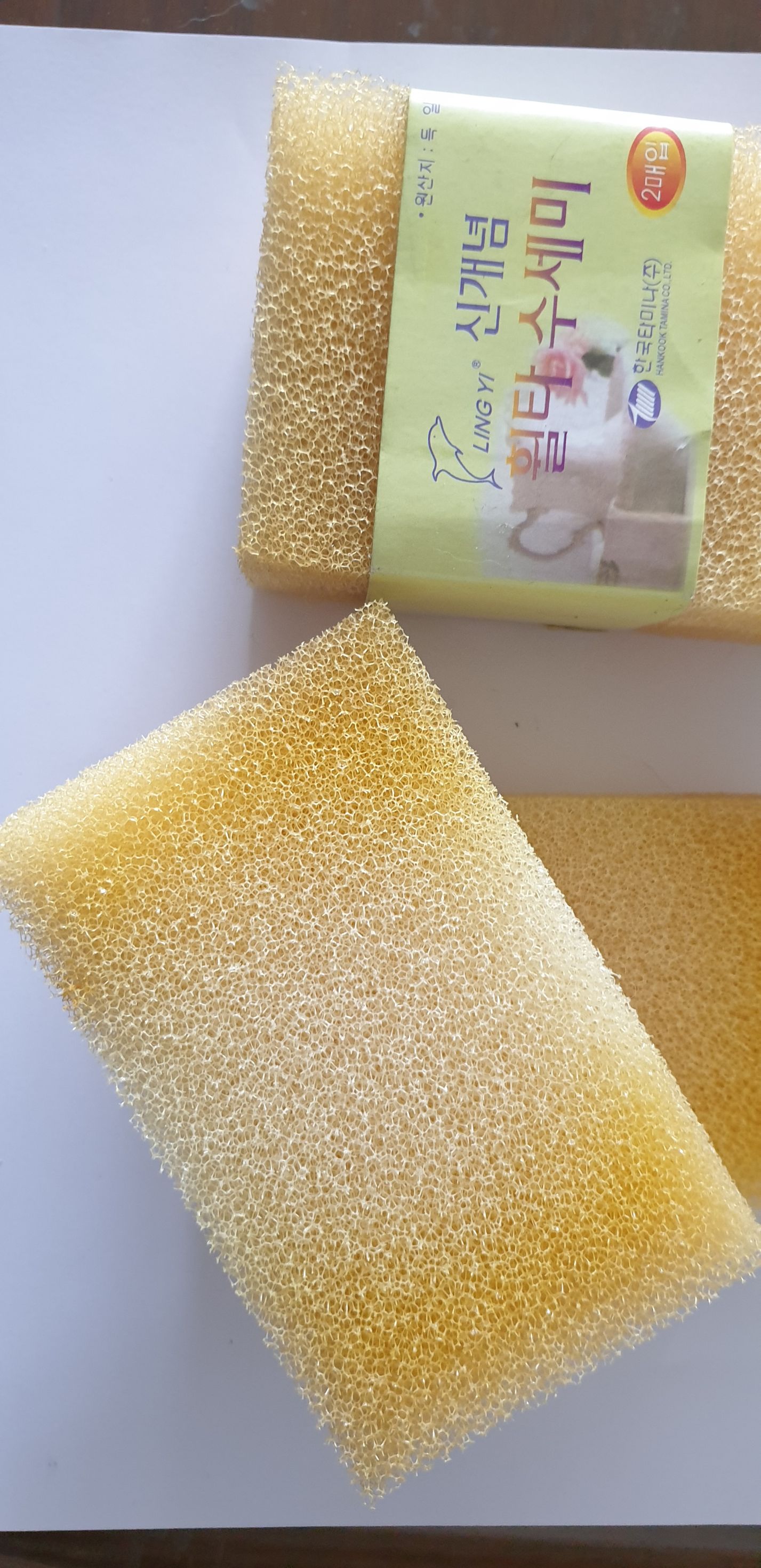

2: option coarse foam and sticky oil

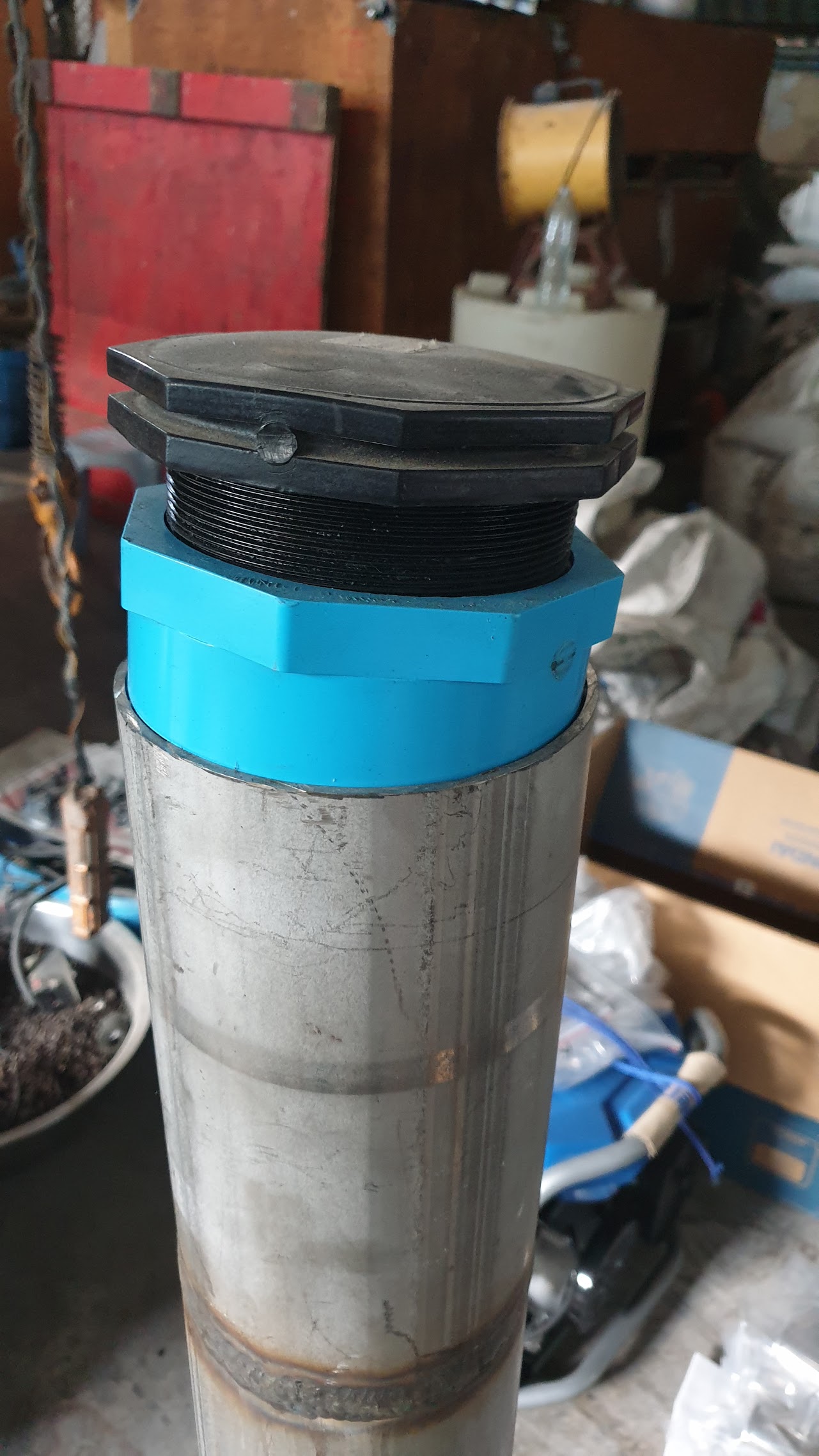

Wow! That surprises me! Is that the gasifier you are building? You are always using a lot of PVC. Is that tower high enough to cool the gases and not meld the pvc?
Thanks for the pictures, that makes things clear.

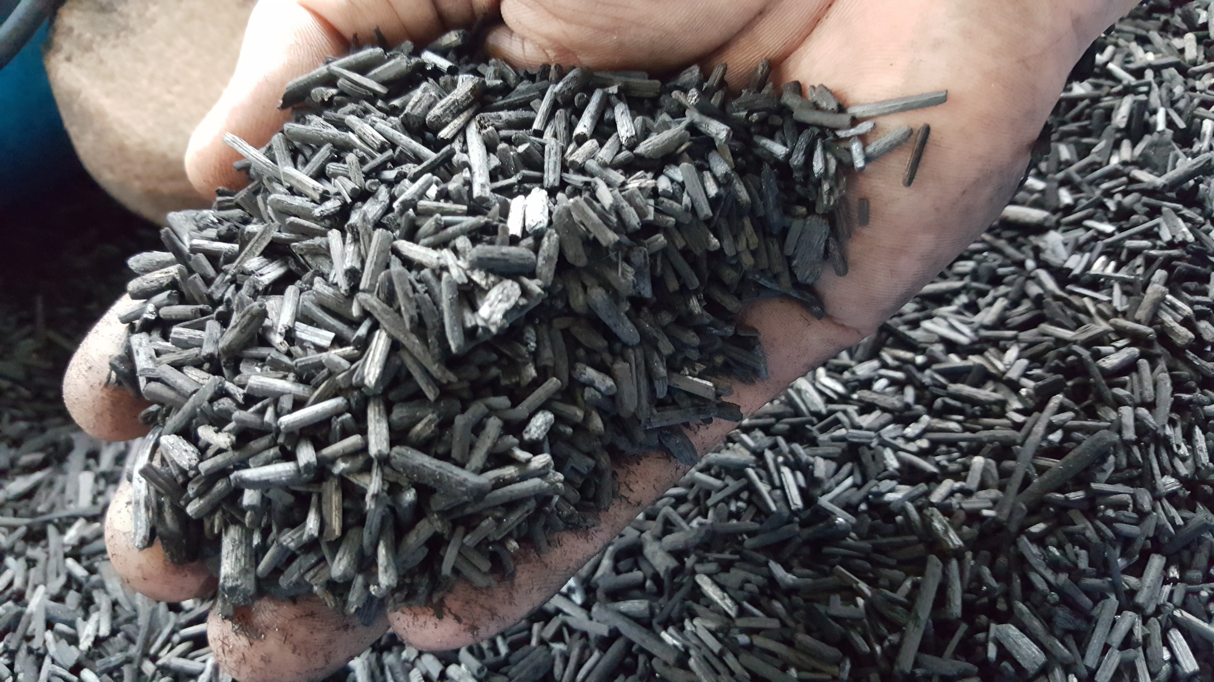

Type and size of fuel i use for it, can be any other source as well

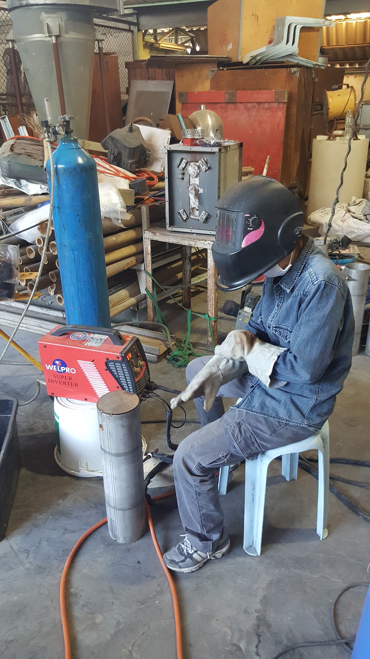

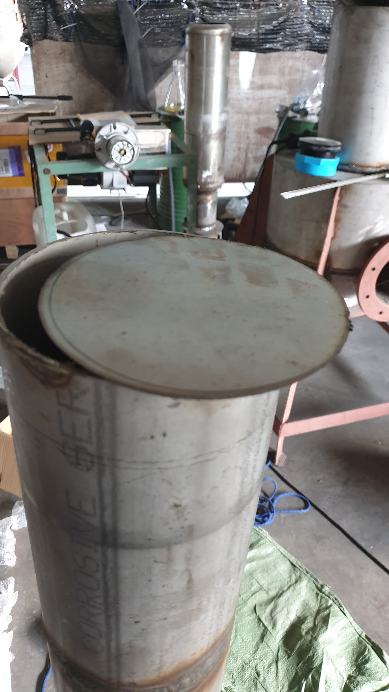

Diameter pipe 5"
Length 4 to 5 Ft

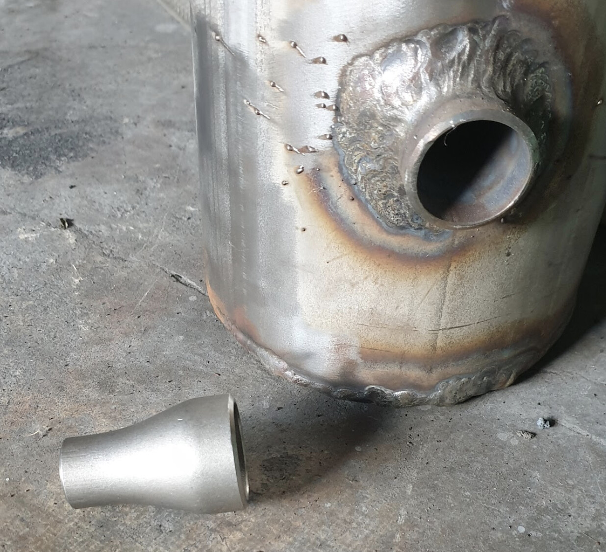

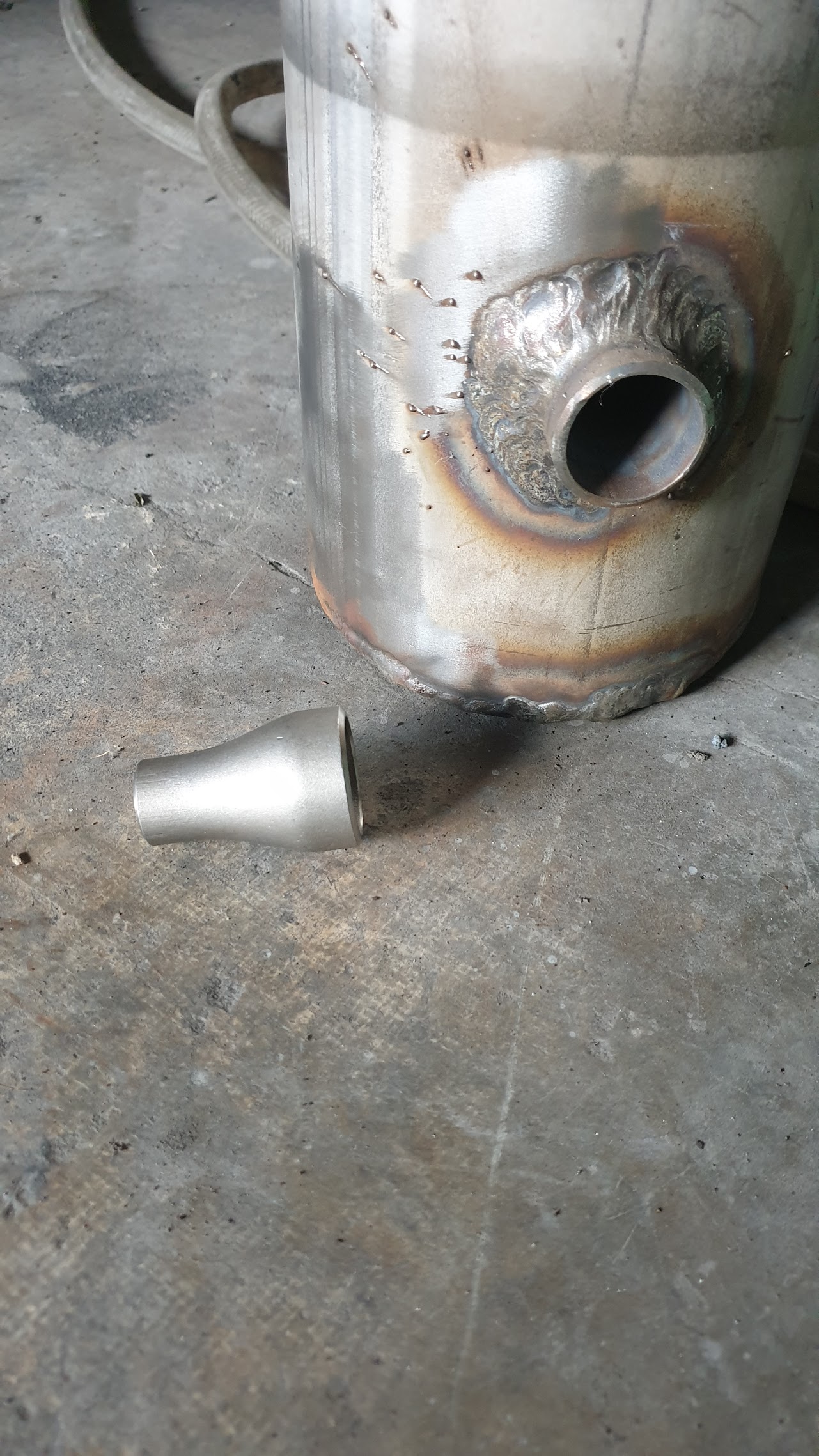

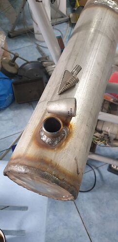

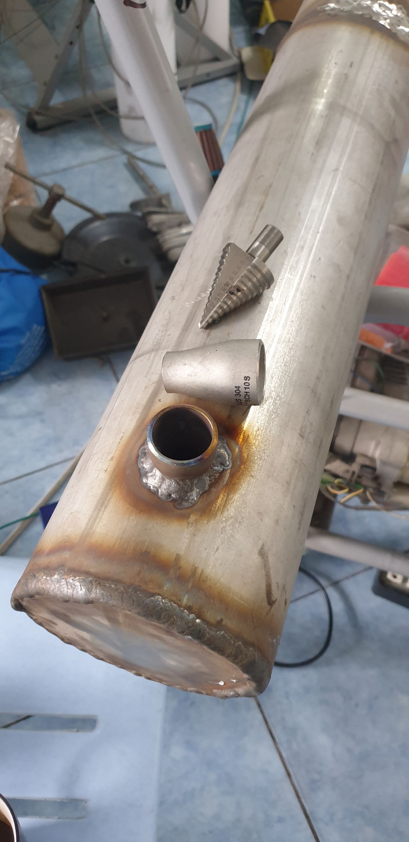

Nozzle is reduction (weld) small is 1/2" to 1"
Height from bottom to nozzle = 4"
The nozzle protrude about 1" inwards the pipe
The minimum level i use is about 2 Ft above the nozzle
The gasifier is connected to the engine frame for vibration
This gasifier is left to cool , then tipped over for cleanout and refilled with new dry charcoal.
The old charcoal sieved out after drying.
I prefer to start each load with the bottom half new fresh ( works for me )
Size charcoal: biggest pieces pass 1/2"screen. Smallest are larger then 1/8"

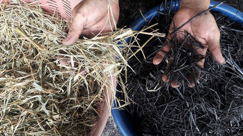

The way i make charcoal, retort style: the center pipe stops emitting smoke (smokeless charcoal )
Also: since my nozzle is outside bigger then nozzle tip, it extracts the heat from the tip to the outside, hence protecting the nozzle from overheating.
Also notice the extra welding where it connects with the reactor pipe.

Just sack of information but have tried other farm residue like stems of cotton plant millet wheat and sorghum stem for making char and used in your farmer gasifier

Hi Koen,
where do you find these beautiful little buzzards. Do you have an online address to refer to us?
Thierry
Hi Thierry,
They are called “concentric welding reducers” or “Butt-weld concentric reducers”
I find them local or also can order online, you might find them easy nearby if you use the google search
