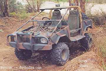

I’m sure that some of you remember the Subaru BRAT. They were nice and light and stayed on top of the mud pretty well. There is an Aussie company selling plans and complete vehicles based on the early subaru. I bought the plans. I also bought a lot of Subaru parts and a bunch of box tubing. They have one version with a small truck bed in the back. The buggy is normally front wheel drive and engages the rear axle for 4 wd. It has front independent suspension which is super important for traction. The “Hummbug” by Rhino looks like this;
If you buy the correct year for a donor, it also comes with LOW transfer case. Good mileage and 4 whl independent suspension. Low case is important because you need some tire height for ground clearance. Something like this;
Looks like room for a back porch for little gasifier?That one really looks adgile,must have used some lighter tubing.
It has a back porch all right. I built it with 1 1/2 Sq box, about .090 wall. The roll cage is thicker. I built it longer than the plans called for.

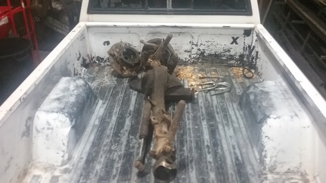

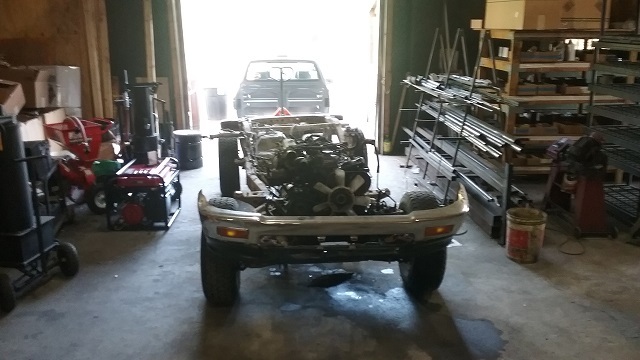

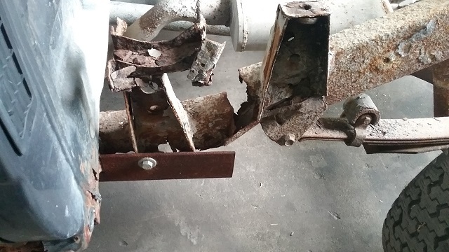

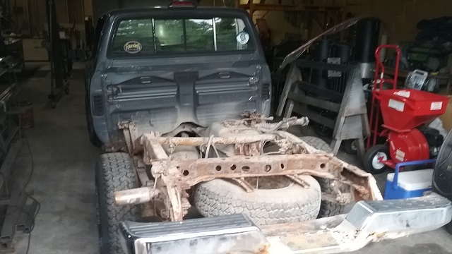

Im starring this project back up. A little late I was hoping to get to this sooner, but was just unable to be in a position to get this going. So anyways, I picked up an 83’ Toyota solid front axle a few weeks ago. The guy I got this from gave me some good advise with swapping some of my existing IFS parts over this axle as well. He was pretty knowledgeable about this sort of thing. I just finished the tear down of my rotted out Toyota, cut it all a part and salvaged the drive train, steering box and linkages and few other minor things. Just chop, cut, snip, and yank really hard
haha. We are going to chop the frame down a bit to fit on our trailer and haul it away tomorrow.
So I should be able to begin the next phase of this project next weekend. This will entail reconditioning both the front and rear axle’s. Ill need to acquire new shackles, shocks, brakes, bushings, a set of leafs for the front axle ( early 90’s Jeep CJ) and steering components. Then we will bring in the S10 and begin swapping all this stuff over and get this part complete with all new lines installed, steering linkages etc.
The next phase after this is adapting the LS engine to the Toyota transmission and then the RnR of this.
After this a quick paint job and then we will begin a gasifier project for it
So much more to come hopefully I can stay on this steady, Im very motivated to get this project complete.
