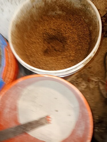

I mixed it 2 powder to 1 water to 2 damp sawdust and packed that into the cavities of my boiler.
The sawdust and powder.

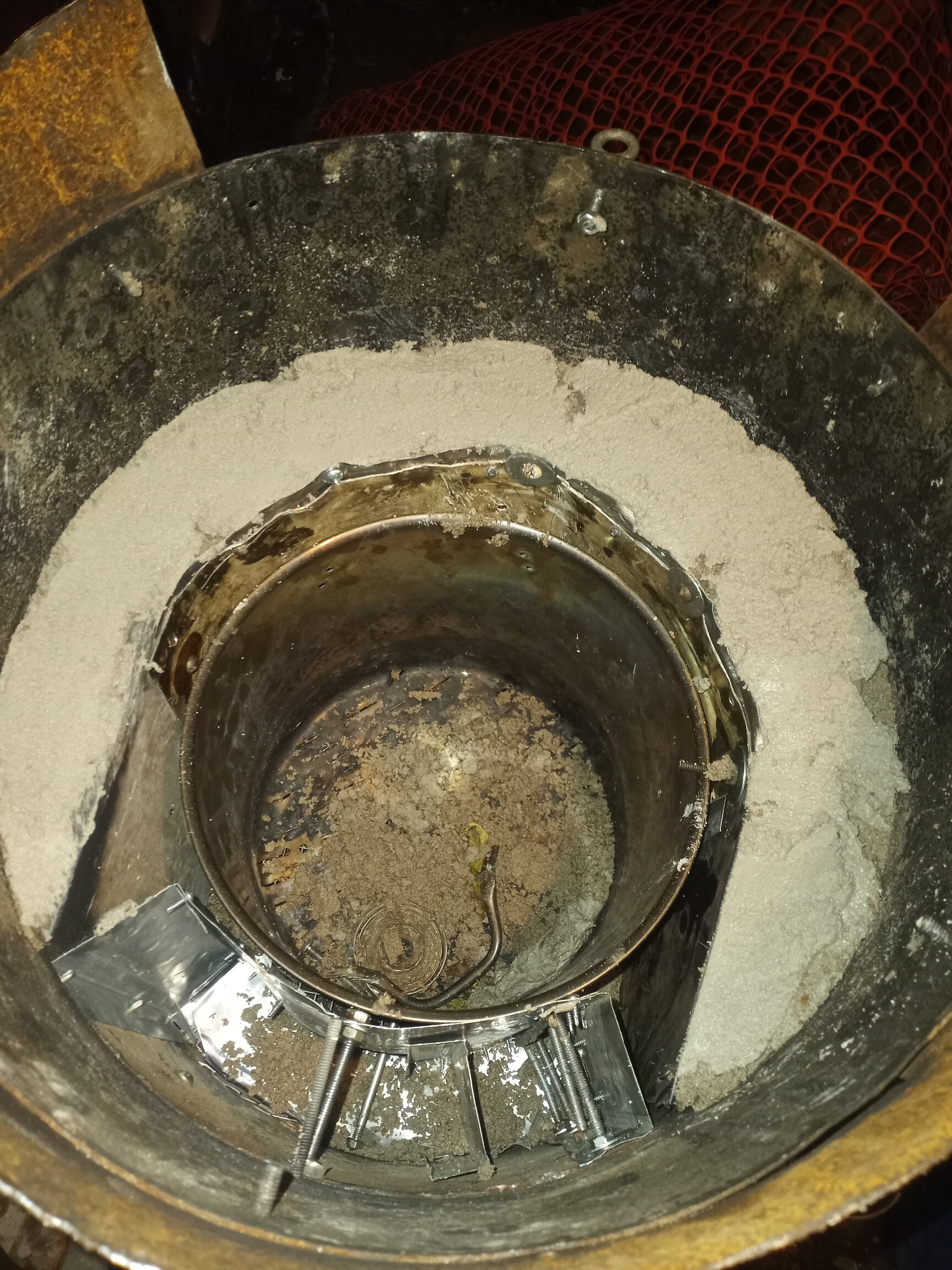

Packed around the firebox, capped with what is either strait cement or paster.

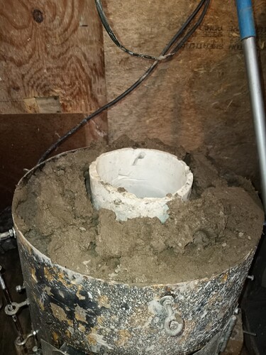

I’m going to want some rockwool to insulate the water tank , so I might use some around the “heat riser”.
That’s what I’m calling the short bit of Tlud chimney that stays inside the body of the boiler all the time.
The higher temperatures that will hopefully result from insulating in this area should quickly destroy the #10 can that is the original heat riser.
I’ve crafted a cast chimney from cheap Calcium aluminate cement and rock wool, that will hopefully last indefinitely.
The sides of this cast tube are roughly 3/4" thick, so they shouldn’t be a terrible heat sink if backed by decent insulation.
There will be a 3-4 " doughnut of relatively dense cast material right before the flame /exhaust reaches the inside of the water tank, but that doughnut is in direct contact with the bottom the tank, not a bad place for heat to accumulate.

The cast heat riser is now surrounded with a six inch doughnut of insulation consisting of various amounts of mud, sawdust and cement.
Once the fire drys it out I hope it the sawdust will slowly pyrolise while the mud/cement fires to a hard but fragile substance.
If that doesn’t happen, I’ll tear it out and start again.
