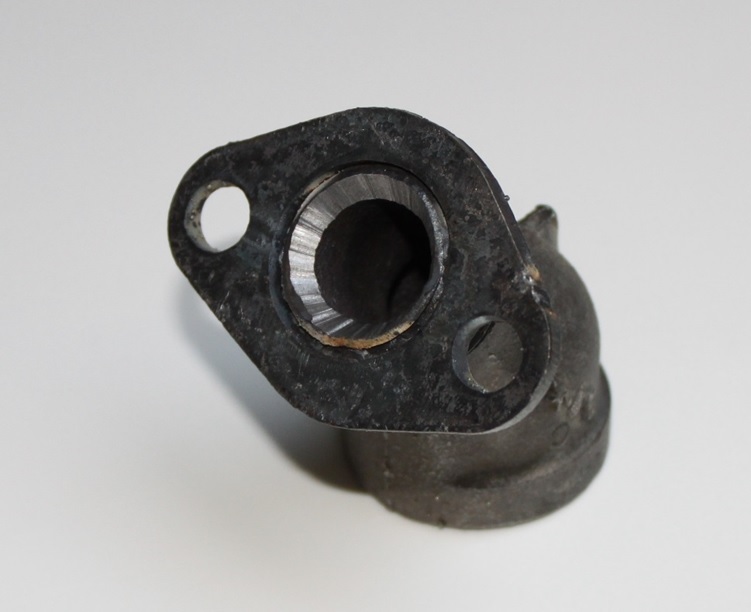

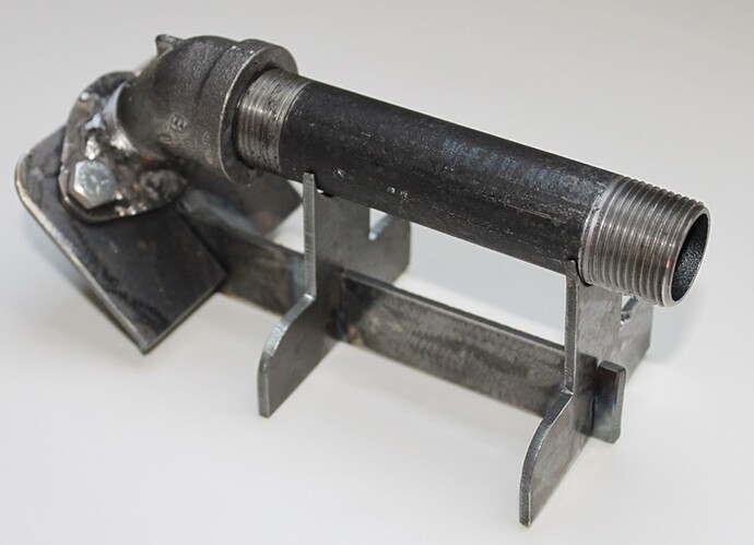

Undeterred I just went for it with my Predator 212cc clone:
I took the exhaust manifold gasket off, scanned it, extracted the edges, and plasma cut a duplicate in 11ga steel. Then I made a jig to hold everything bolted in position. After welding I took a countersink and did a crude “porting” job.
The welding is not great, but I have a guy who does my production work. Hopefully the bolt holes are in the correct location. I know the angle is correct. Hopefully it fits when the 196cc clone gets here.
