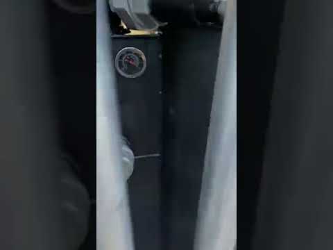

What helps is to have a gas temperature outlet gauge. You can see this in another new members videos, Dean Lasko:
The gasifier in its converting section must get up to 650 degrees centigrade and higher.
Good finished gas outlet will read at least 500-700 degrees Fahrenheit. Dean’s BensBook system gasifier does two internal heat recovery steps so will read on the lower side in the 400F range when fully draw loaded pulled.
