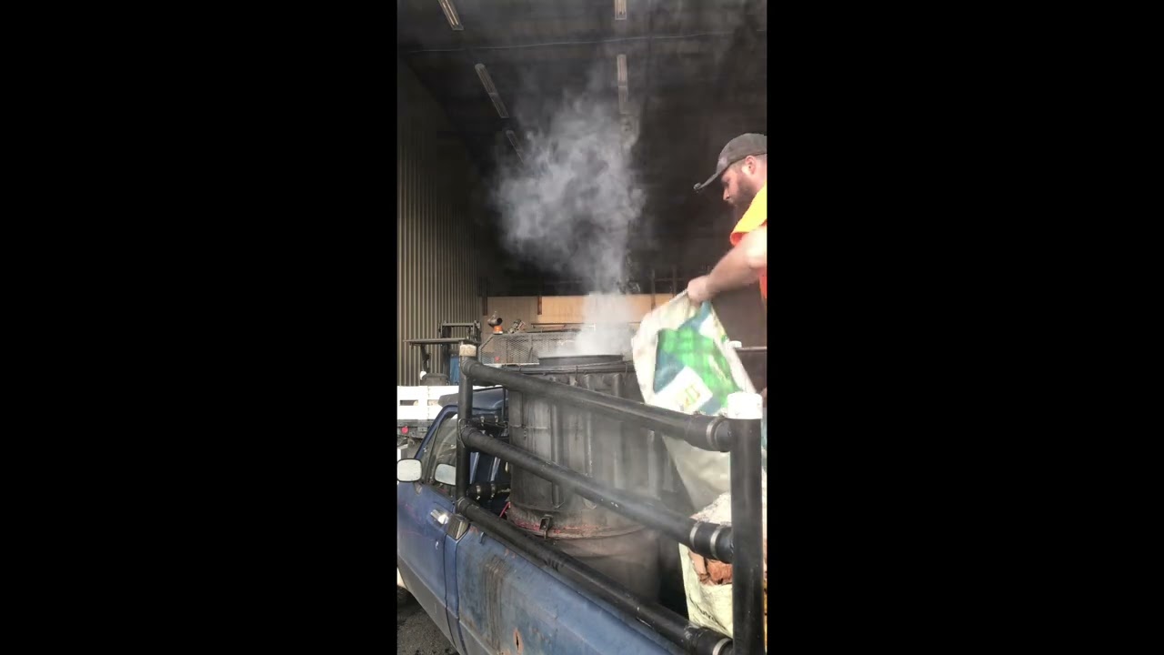

Just to kinda reconfirm what others have said, each system wants what it wants, and its your job to learn how to operate it. Trust me the struggle is real trying to figure it out on your own with no experience but the words of some feller on the interwebs. Yes there is a lot of bad and misleading information on youtube, a lot of look at me I want views bs’. It took me a solid 8 hours of fiddling to first get my truck to fire up on woodgas. Frustration was unbeleiveable! Still to this day it is not a perfected thing to start on straight woodgas with no dino juice bump start and warm up then switch over. This is best achieved with my truck by running pushing and pulling blowers for proper warm up, noting as wayne has said many times over a light haze gas, not thick smoky tar making goop. Once warmed up, then pulling blowers off, woodgas valves open at the engine, air valves open and let woodgas be pushed all the way to the motor for several seconds. This will gently haze out from under the hood. This insures fuel is at the ready right at the carb before any cranking happens. Here is a video example
But at todays fuel prices ( payed 5.17/gallon last night, 97$ for a half tank in my dodge :face_with_symbols_on_mouth:) I try every chance I get to start up on straight woodgas. Maybe 6 times out of 10 I can achieve it. And depending on how well the system is breathing will change my air mix settings, often as im driving minor adjustments are needed when running on softwood pine and doug fir, not so much on hardwood maple and cherry. I have 2 2" gas supply lines and 2 2" air supply lines each valved with a fully sealing throttle body. On my particular truck one air valve is always closed off completly and the other air valve is only open about 1/3rd, both gas lines wide open. 70/30 MIX?? But thats what my truck wants. I could delete the second air valve entirely, but that extra air is needed for those rare times im running on gasoline. If running on gasoline there simply is not enough air to supply the venturi correctly and it over pulls fuel and runs pig rich and starts fowling plugs. This should be a very clear indication that im sure other woodgas operators have duely noted how far apart woodgas runs from gasoline. It is not like running a engine on any other type of fuel we know of, its own beast. A beast that must be harnessed and taught to behave. Unchecked and unbalanced is tar production, system clogging, overheating irritation of the bang your head on a wall variety. Keep your head up, your nearly there. As Wayne has said before, wish I was there, im sure we could have it up and running in no time. Once you get it running and the other 75% of the learning starts flowing, you will look back on these early frustrations and know exactly what needed done to make it function. This to shall pass
