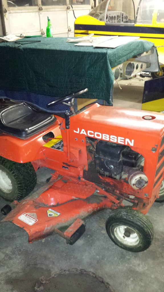

I've been thinking about taking new direction, and wanted ya'lls opinion. It's going to be about 2 months before I get my Ford back together, painted and sold. (mainly because of finances). I've been thinking that during this time I could build a small gasifier to run a few small engines I have around here.I do not want to spend a bunch of money on it,(except for the cost of premium membership)1 because I don't have it, and 2 I do not want the money I do have, taken away from the truck project.

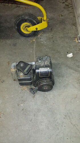

I started rummaging around the garage to see what kind of material I had. I have 2 small engines to experiment with, one is a 5 horsepower craftsmen and the other is an 11 horsepower Briggs and Stratton. I found a really thick piece of pipe that might work for a fire tube. It's about four and three quarter inches I.D. I have 4 or 5 pieces of 2 inch black steel pipe that is about 4 foot long. I have at least two 55 gallon drums to mess with, a metal five gallon bucket, a couple old refrigeration cans. (a little smaller than a 20 pound propane tank). I have a set of torches and a stick welder that will weld up to 6013 sticks. I'm also pretty good at welding with a torch and brazing.
What do you guys think? My goal would be to build a small gasifier to run one of the small engines.If I buy a premium membership and scale down the WK gasifier can I build a tar free gasifier for these motors with the materials I have? (I know I don’t have everything but do I have all the expensive stuff covered?) Mainly doing this for educational purposes.

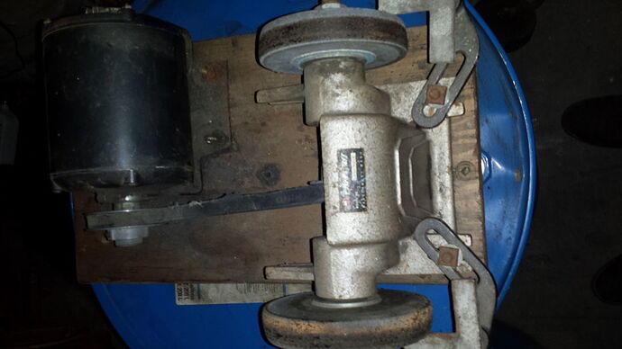

I’ll give them a call Monday on my lunch break. I attached a picture of something I would like to convert for wood chunking. I’ll take one of the grinder wheels off and put on a saw blade, this will get me through a couple hundred pounds of wood until I can get a better chunker. I’ve been reading a lot in the small engine section and SteveU says it’s really hard to make something that’ll keep a 5 horsepower motor running, said it could be done but only 50% of the power. If I could hook my 5 horsepower motor up to this and get it to run at 50% I think it would be plenty of power to cut stuff up.

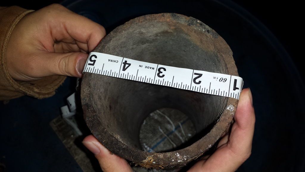

Speaking of cast, how was your 4ish inch diameter pipe made? A few years back, (when I didn’t know much metalurgy) I had a piece that looked similar to your piece. It turned out that the pipe was a cast steel. Because of the way the steel re-crystalizes in the casting process, it becomes almost imposible to weld.
To tell if it is cast, what do the surfaces look like? Are they bumpy? Maybe have a “mesh-like” imprint in it? If either of those are true, your pipe is probably cast.
You’re right, its cast. I can actually see the molding marks on the side. Guess I need another fire tube.

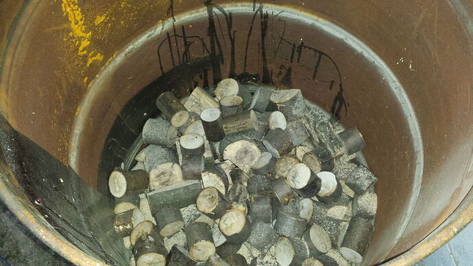

Was a little board this evening and decided to chop up some branches laying around the yard. Used a cut off saw and a hatchet. Loaded into a 55 gallon drum.
