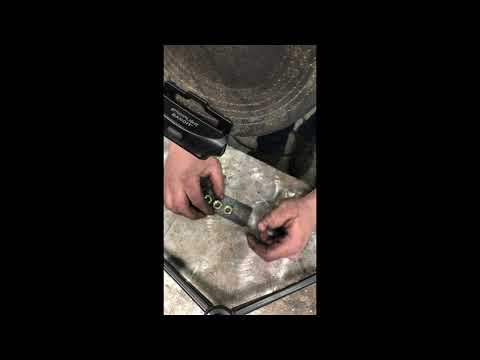

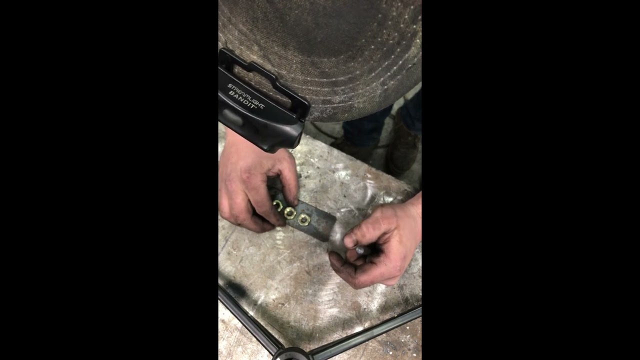

New project! Normans next gassifier truck
https://youtu.be/sv0luFIH1Ug
https://youtu.be/aBHETt-Hi0U
Hey hey hey, hold up Scorsese, you got all Hollywood on us with the nice fade transitions and good camera angles!
picked up a tripod for my phone, 20$ on amazon made for a lot easier videoing!!
Heard my name while you were bragging about your weld job :laughing: You are the man, man. Nice video. Keep em’ coming.
Very nice video instructions. Needs to be added to the V-10 building library.
What do you guys think about the built in puffer lid?
Vacuum follows puffback so the springs should work fine. I like your idea of working on this part of the build while the fenders are off. When you get my age you always look for the easiest way to do things.
