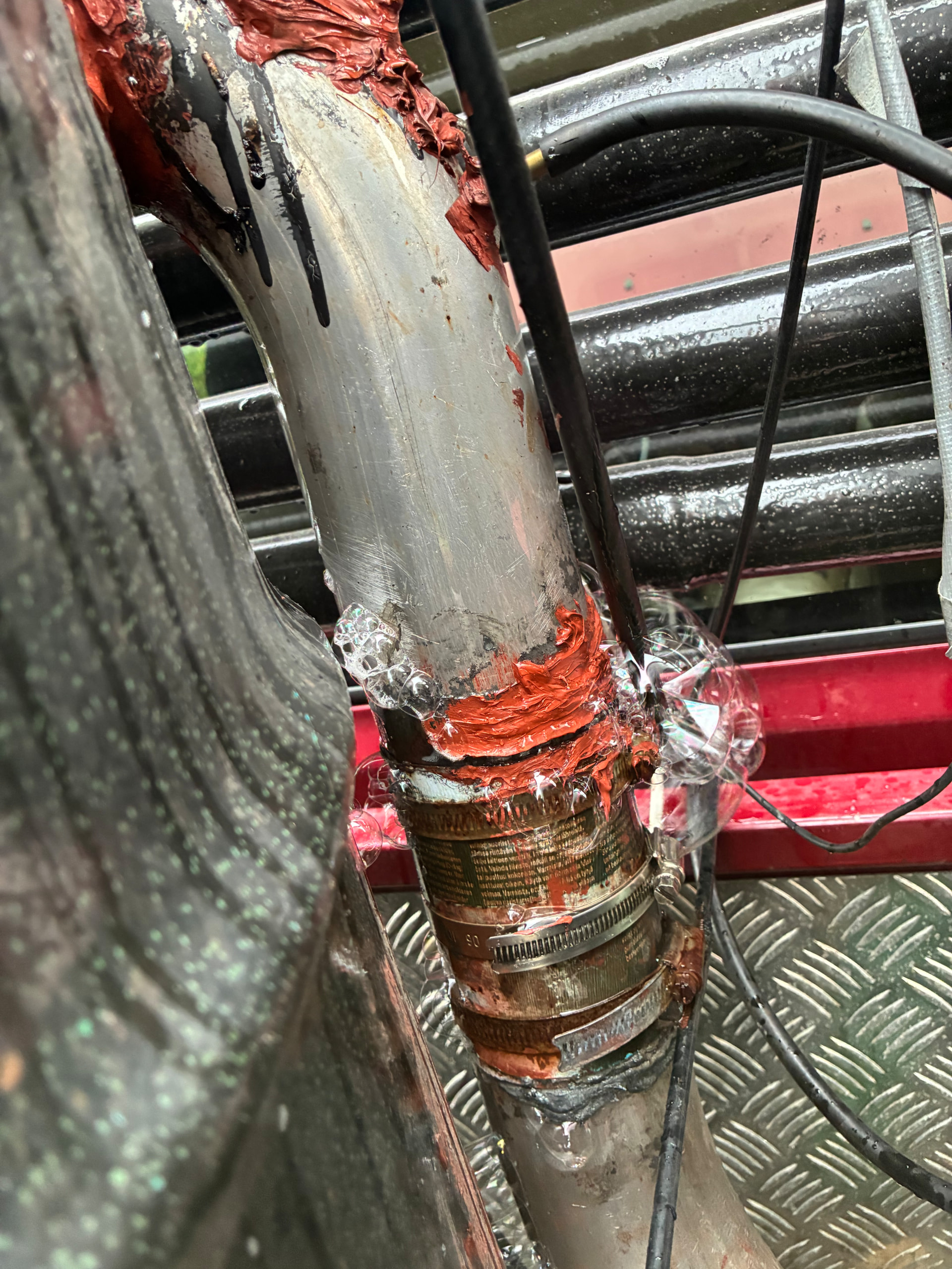

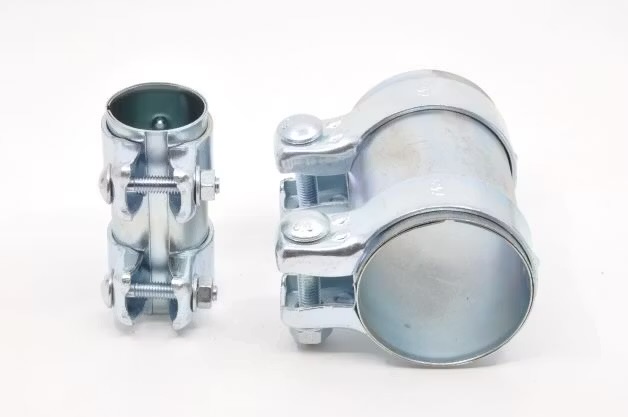

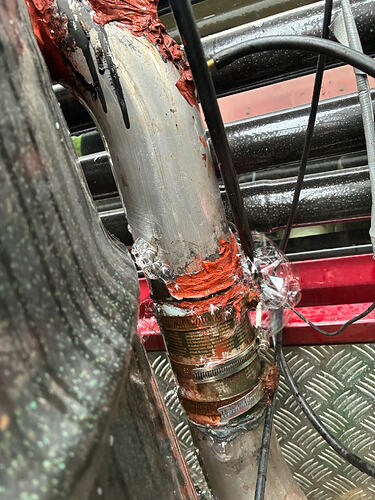

I wonder if I haven’t found something wrong, do you think a clamp like this will be tight enough instead of what I have?
Why do you have 3 clamps? Also I can’t see through the goop, so I am not sure if this is what you have. I was told to never put the clamps right at the edge of the hose because they leak, slide off or the hose cracks under it.

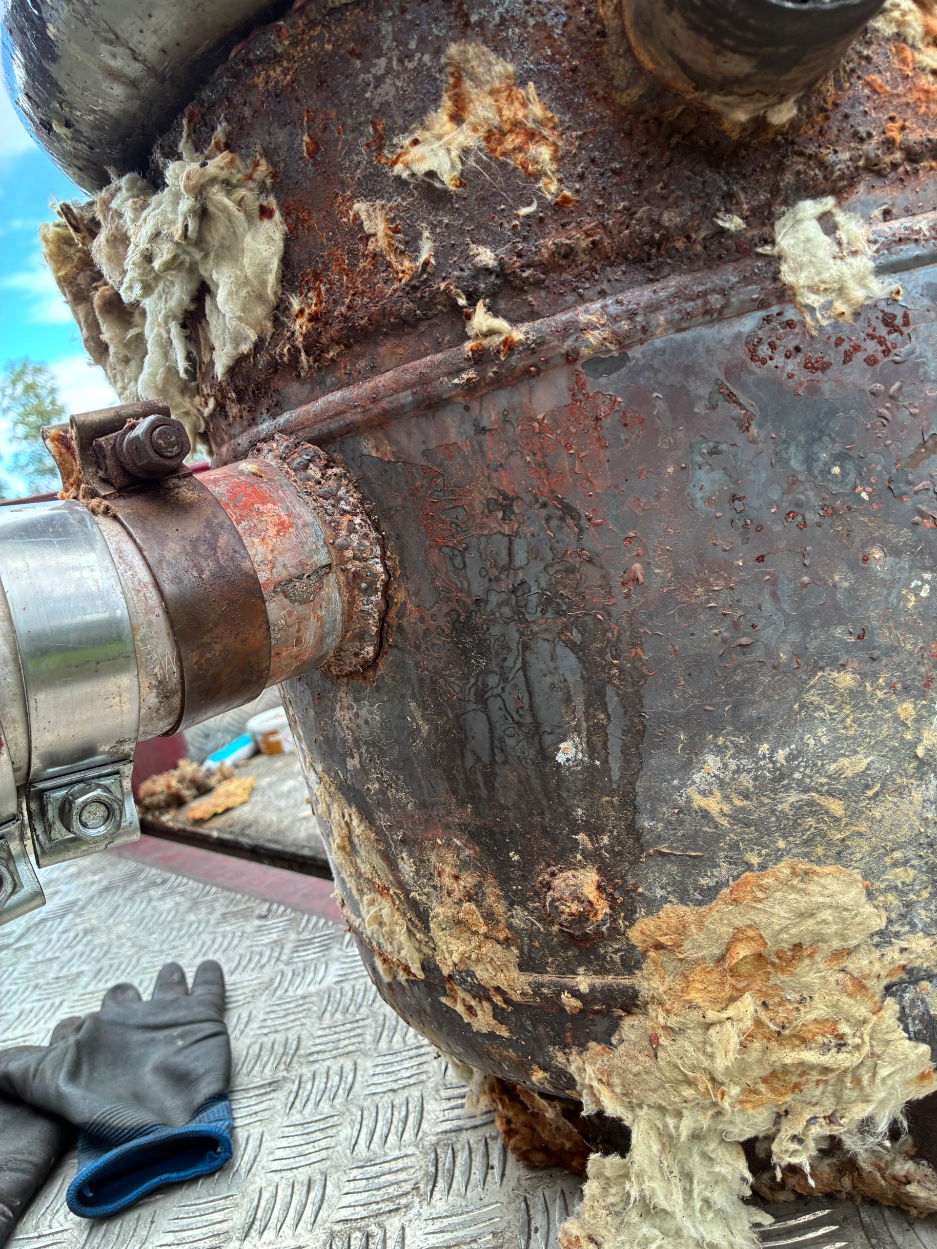

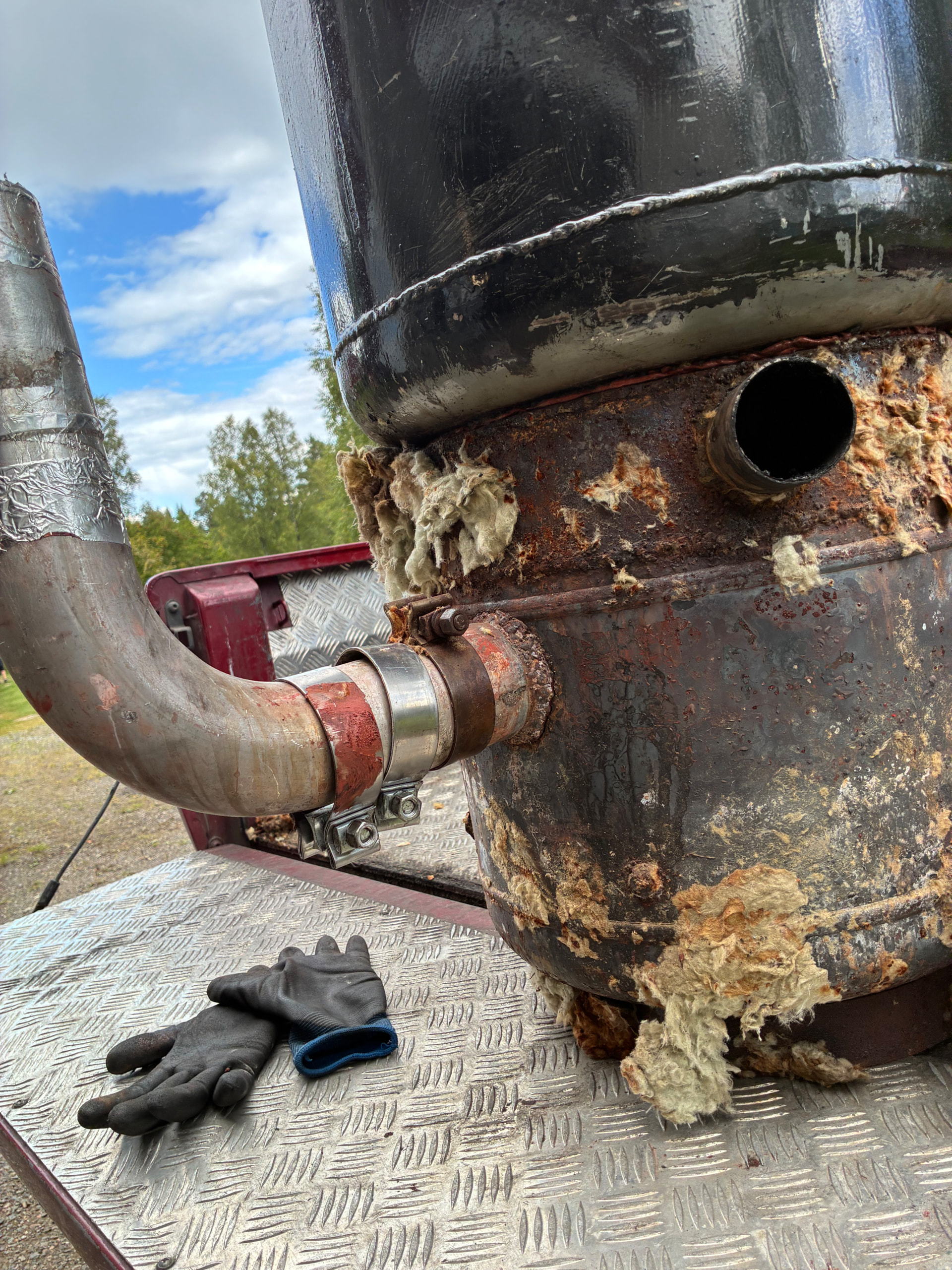

I have a thin sheet metal rolled around the pipes, there is a joint on the pipe there, I have tried to seal it with assembly paste and silicone, but the silicone can’t withstand the heat.
I would try flexible repair pipe for mufflers. It comes in a couple different diameters and it isnt super expensive. It comes in 6ft rolls, you might be able to find a repair shop or someone with the foot you need.
Edit: You may have to order it online from like amazon US as Europe doesn’t allow cars on the road long enough for the tailpipes to rust out.

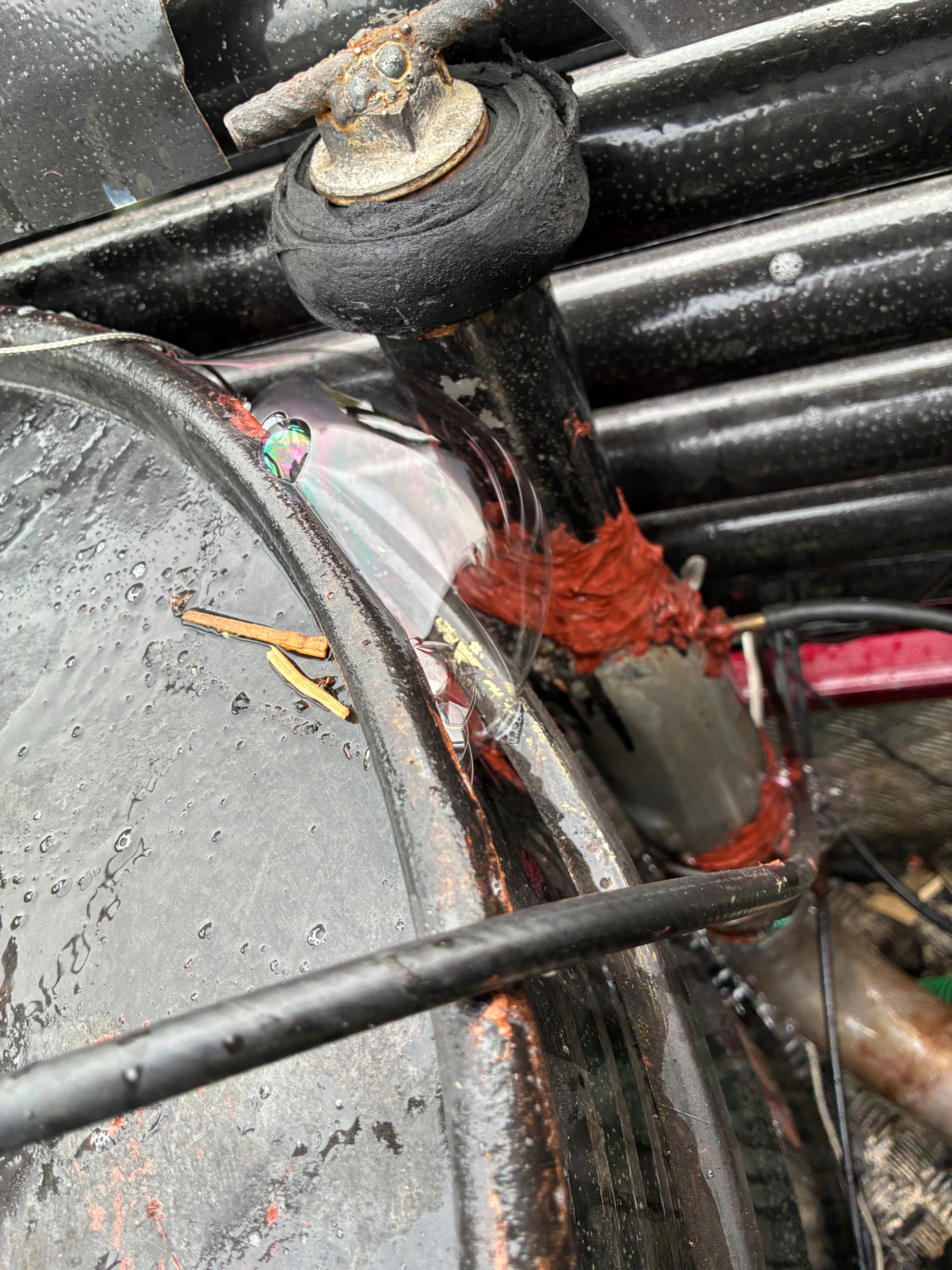

Are those soap bubbles, Jan? Does that joint need to flex? Seems like to many areas to try and keep sealed. The clamps you showed may work if you could wrap the joint in muffler tape and still get the clamp over the joint. Wouldn’t be flexible though.
Yes, it’s soap bubbles, I couldn’t get this joint so I’ll try another one, if it doesn’t work I’ll have to weld or solder the joint,
Maybe I should try that tape you suggested first, that’s probably a good idea.

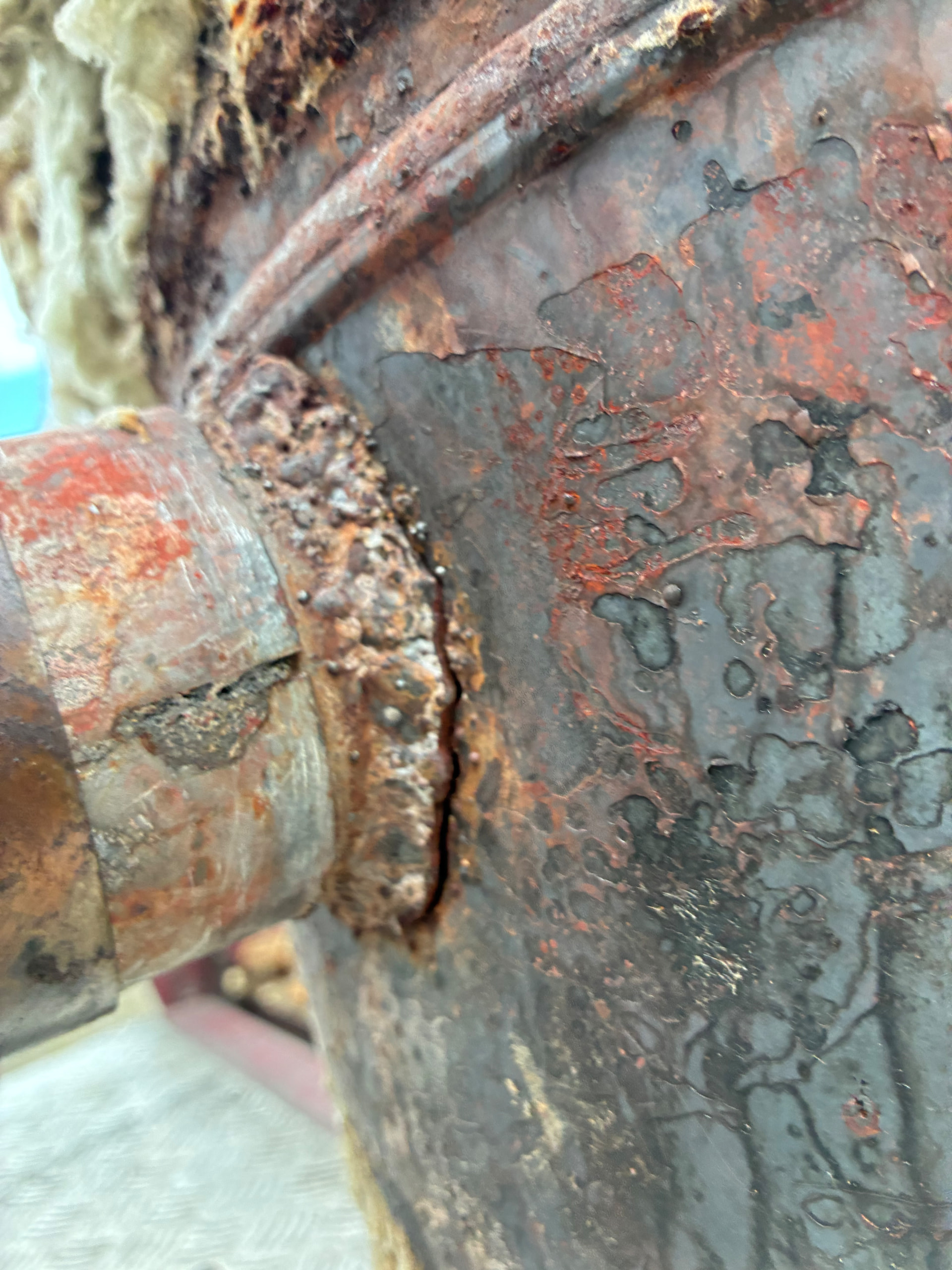

I wonder if this affected how the car runs and how hot the gas is out of the unit?
It was only cracked about 3/4 of the way around.
