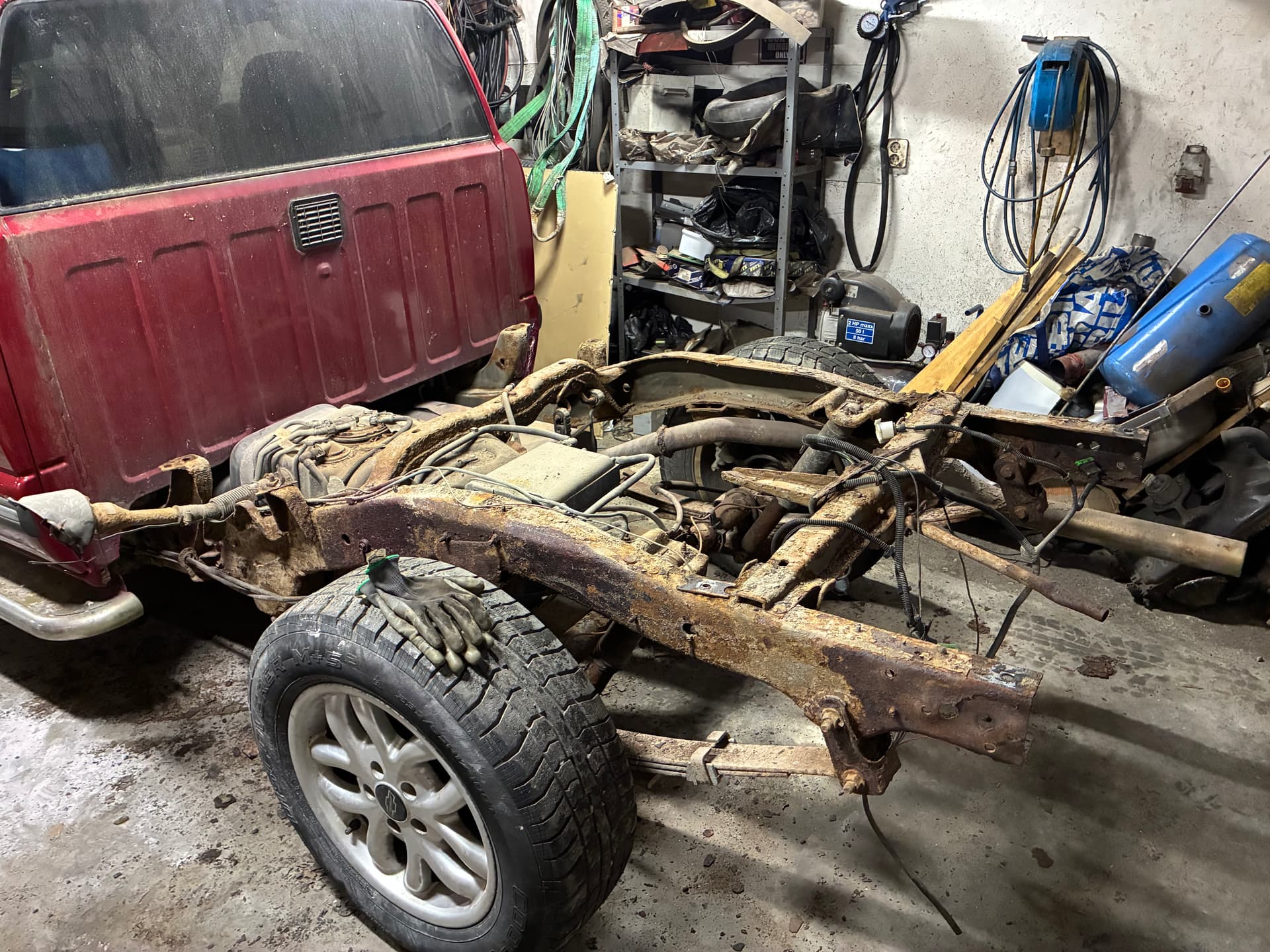

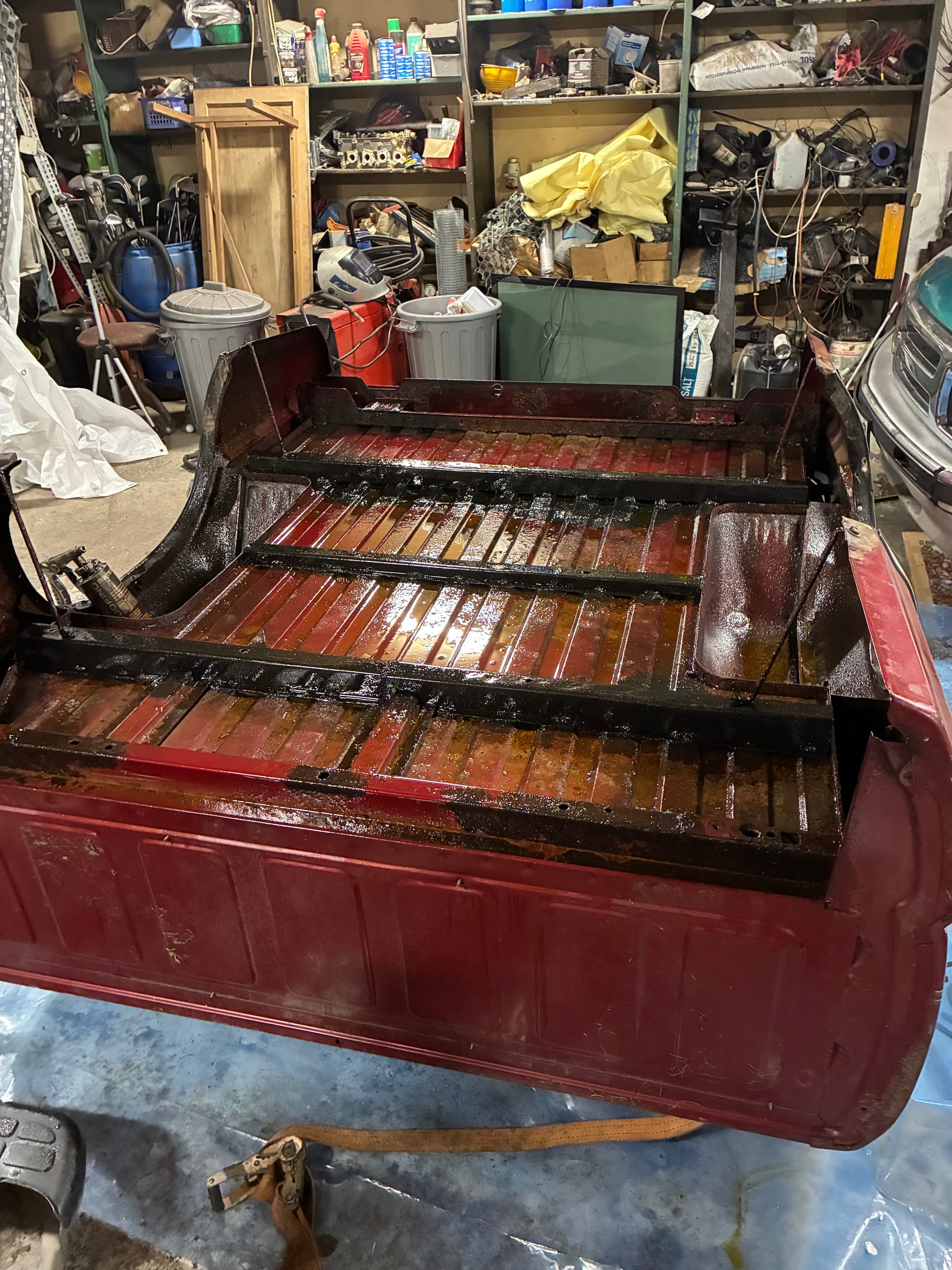

There was a little rust on this car too, it looked pretty good from the outside, but replaced a front fender and made a new fender edge on the right rear and repaired half of the fender edge on the left rear.

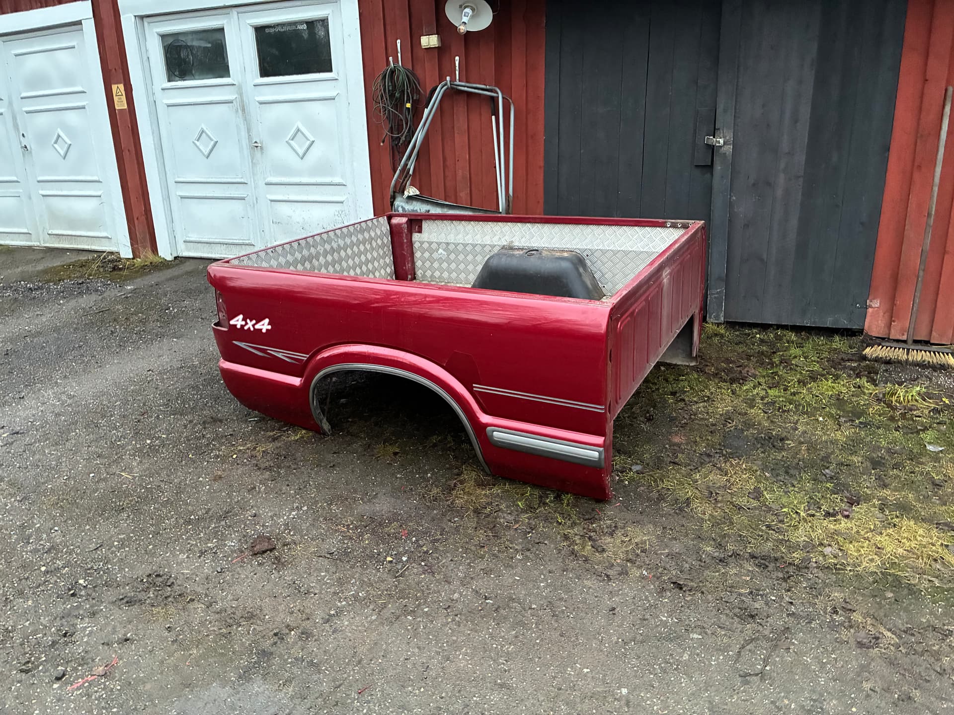

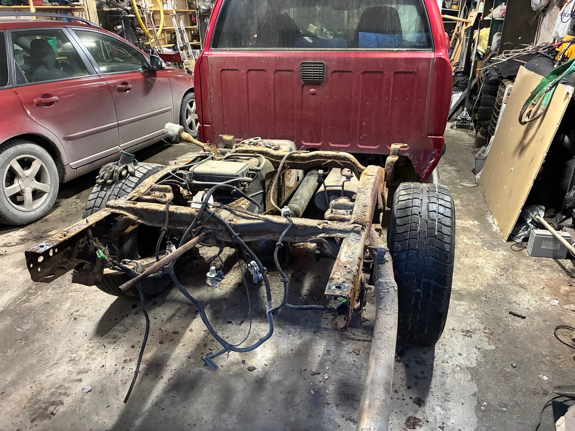

Now I have to make new beams under the bed, there are none left of these, but how do I turn the bed without damaging it?
Is there any other way than to tilt it towards the cab?
If the bed in the picture is the one you did the repairs on it looks great, I didn’t understand about turning the bed without damaging it. but I have removed them by slapping together a wood frame over the bed and lifting it with ratchet straps. I think you have a tractor with a loader though. I don’t know anyway to test a fuel pump but I have had a few go out on me and it’s always a Pain in the ass. For 50 bucks I’d consider swapping it while the bed is off.
https://www.amazon.com/s?k=chevy+s10+fuel+pump&adgrpid=189236909471&hvadid=779674214849&hvdev=c&hvexpln=0&hvlocphy=9016921&hvnetw=g&hvocijid=12212619633998232734--&hvqmt=b&hvrand=12212619633998232734&hvtargid=kwd-302730695001&hydadcr=24337_13726283_2427109&mcid=bbc8824044a0363c93e7d08da0ab9b6c&tag=googhydr-20&ref=pd_sl_6taaayxsjy_b
That was a good idea, I actually have a new motor for the pump on the shelf, thanks.
Yes, very good idea!
When i had an s10 Chevrolet, i cut a “inspection hatch” in the bed floor when i replaced the in-tank pump.
And, nothing left of the lid and “nut” on the tank but rust- become a piece of sheet metal, 8 self-tapping screws, and lots of “sika liquid weld”.

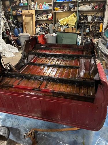

New beams and parts of the bed, and now linseed oil everywhere, let’s see if it works.

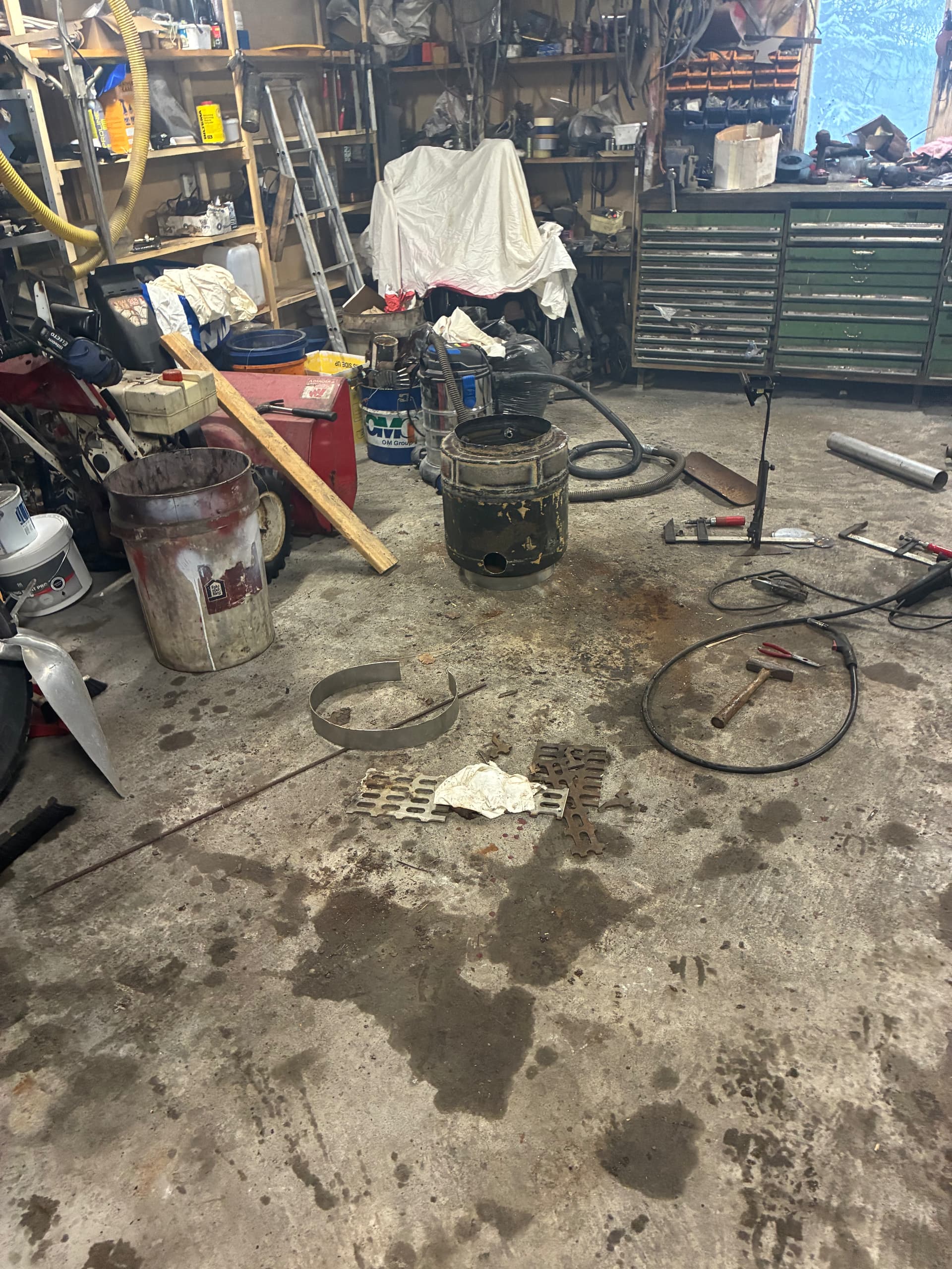

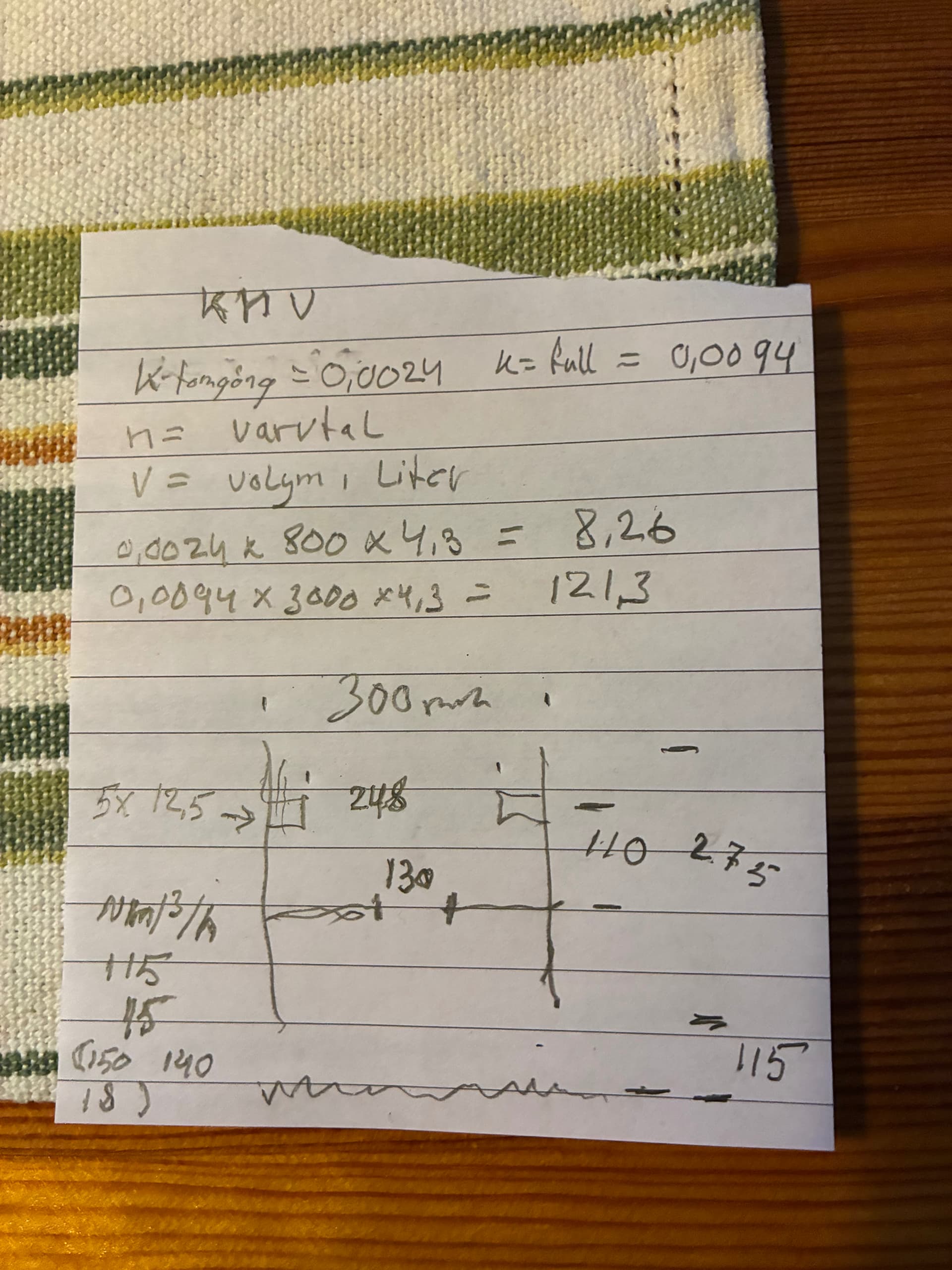

I was thinking about making an aggregate for the new s10, but haven’t decided whether it should run on gas or be sold.
I can use the aggregate for the generator otherwise.
The dimensions are roughly the same as I have now in the old s10, if I remember correctly, just a little further down to the grate, do you see anything that seems wrong?
I’ll have to show it when it’s almost finished, took a picture from a little further away so you can’t see my welds and how simple it is.
Now the question is what I’m going to use for the wood container and the filter, I’ve found some garbage cans with lids that I’m considering, but I’m not sure if I can get the lids to seal.
Soptunna med Lock Rostfritt stål 95 liter | Adexa SDB95v1eo1c_upMQ…_gs*MQ…&gclid=EAIaIQobChMIoIPm1M2CkQMV0lyRBR1AJwiaEAQYBiABEgKKbPD_BwE
JanA., a simple at 90 degrees rim skip welded to the lids outer edge will form a channel to hold a silicone impregnated rope seal.
This will also stiffen the lid greatly.
The weld does not have to be air tight.
Skip welding will prevent the lid from welding heat warping. Use lots of clamping down to the pot edge when welding.
Yes, you’re right, then I’ll get support too.
