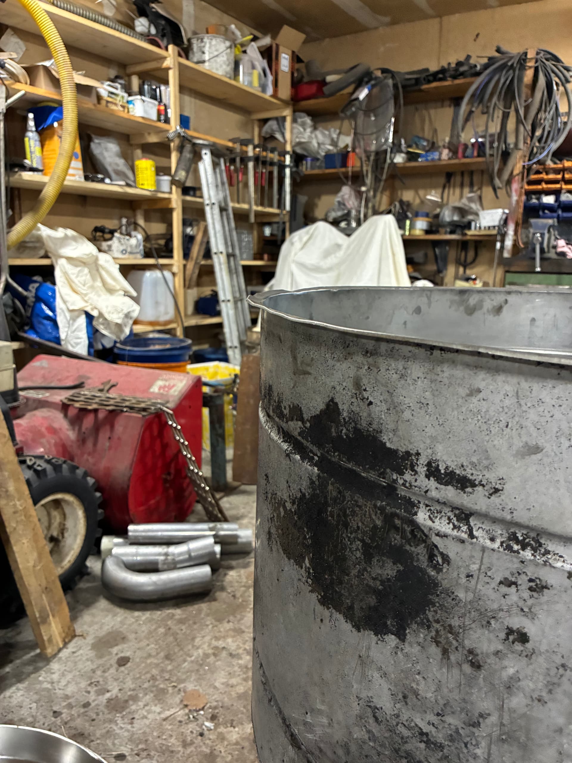

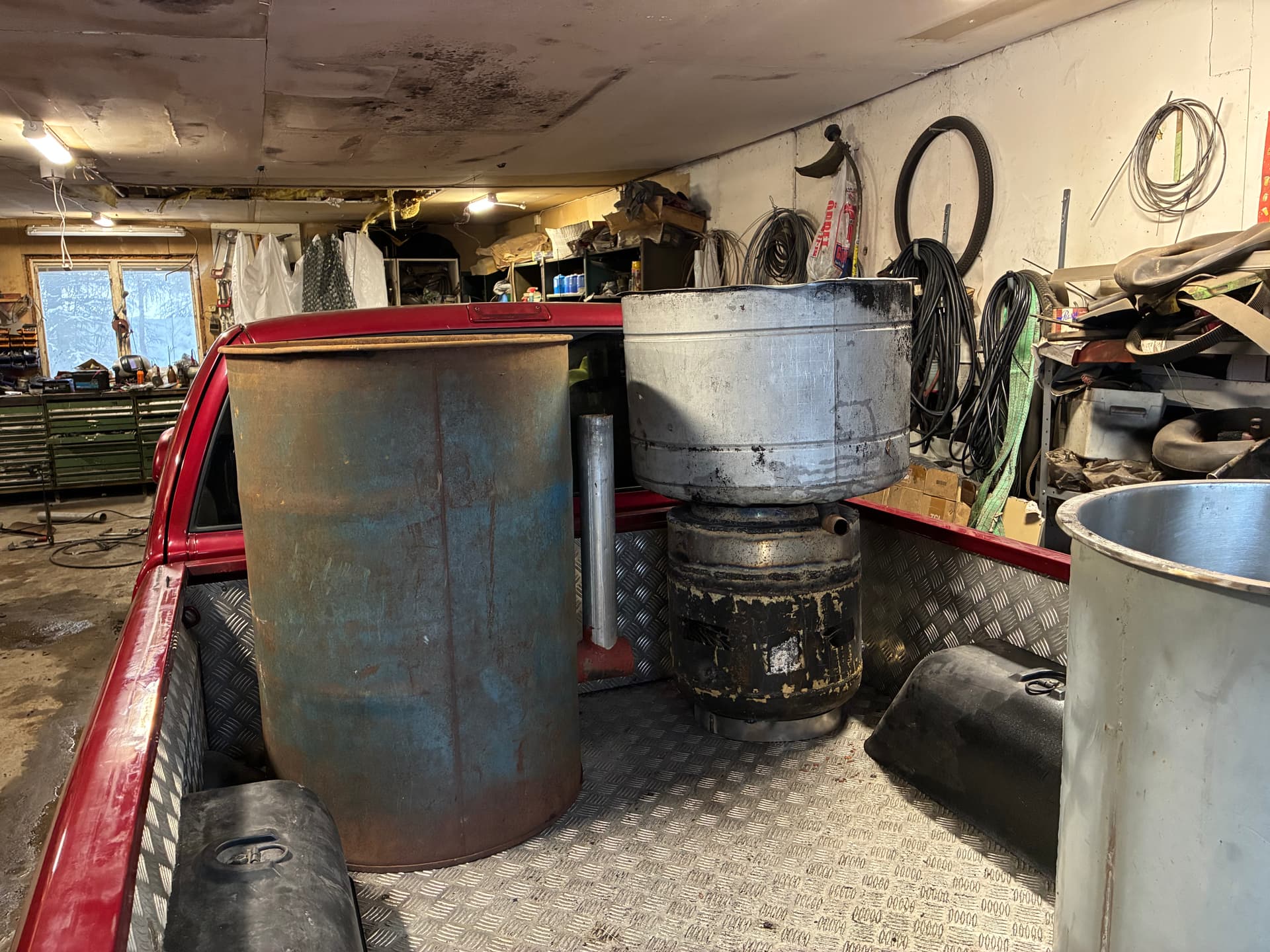

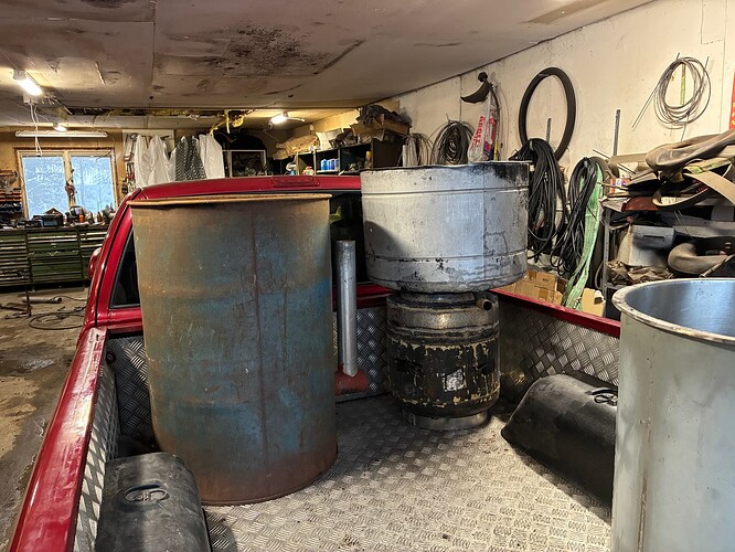

I looked at how much wood goes in different containers, the ones I was thinking about buying are 95 liters (25g) the low one on the car is 103 liters (26g) and the high one on the car is 113 liters.(30g)
I have to make a lid for the low one on the car, so I can make it a little higher so I can fit more wood in.
My wood container on my other car is 157 liters,(40g) which I think is good.
Now I’m confused again which one should I go for?

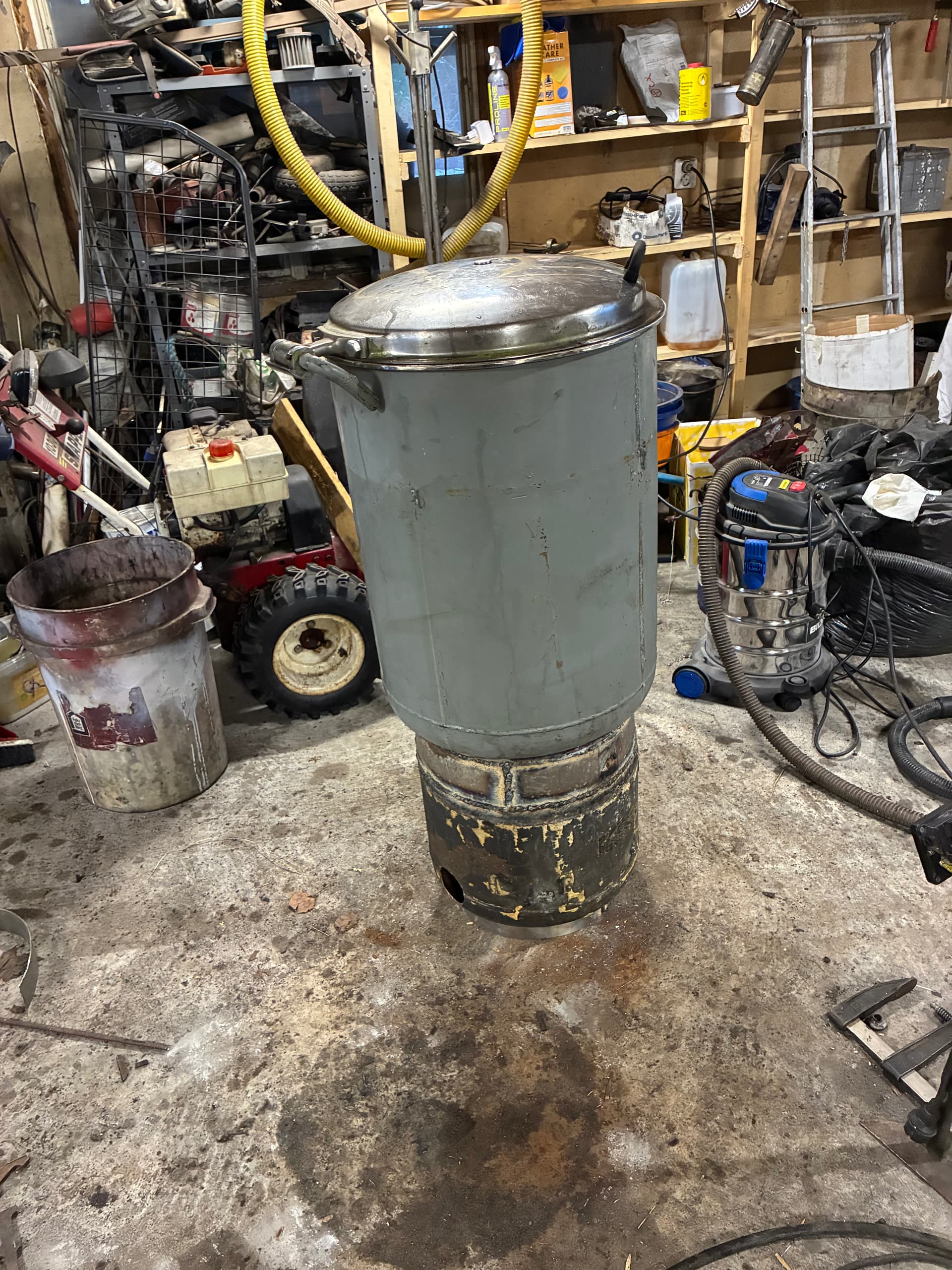

Personally I would go for the lower setup in the first pic. I find that size to be enough 95% of the trips I make. Also, a lot easier to light up, and if you like to inspect nozzles or so.
However, I think it works well with a little more wood, I only had 1 wash pot to start with on the old S10, and I thought it was much better with about 50% more wood, there is quite a lot left most of the time when I run it too, but it is very dry next time, which is good.
Ignition is not a problem with the weed burner, if it is not too cold.
I was thinking about whether I should make a pipe next to the nozzles and light it through it, it seems better to light directly into the coals instead of risking driving fresh wood into the coals when lighting it.
But it looks much better when it is not so high, but loses a little cooling.

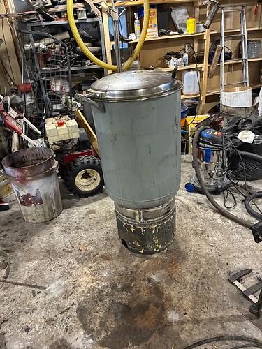

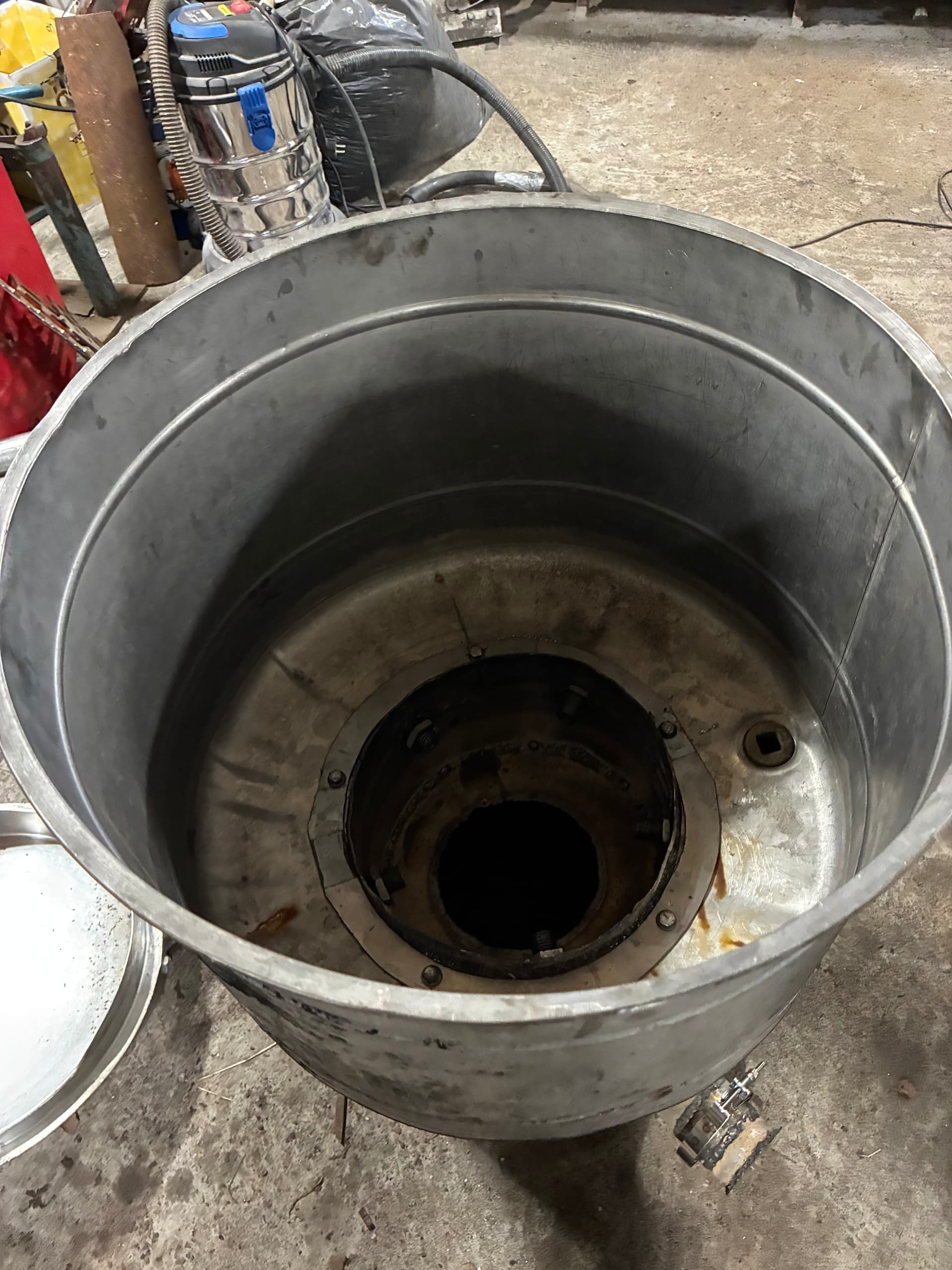

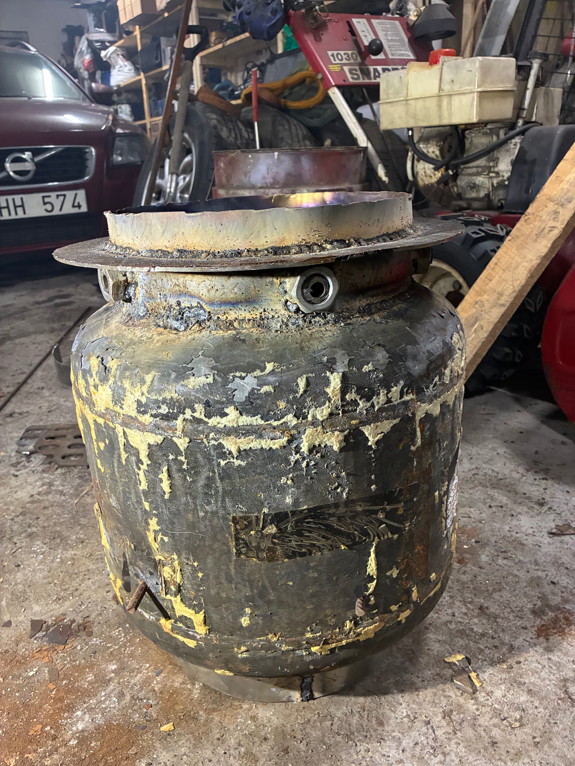

I had second thoughts, and thought I’d show you a little bit about how I do it, I hope you’ll give me your thoughts and suggestions before I finish it completely, but this is what my unit that I’ve been using for 4-5 years on the S10 looks like.

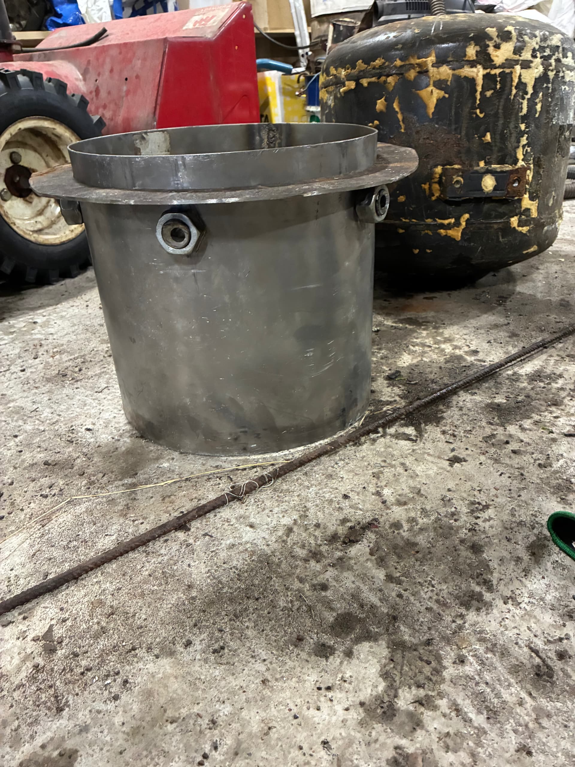

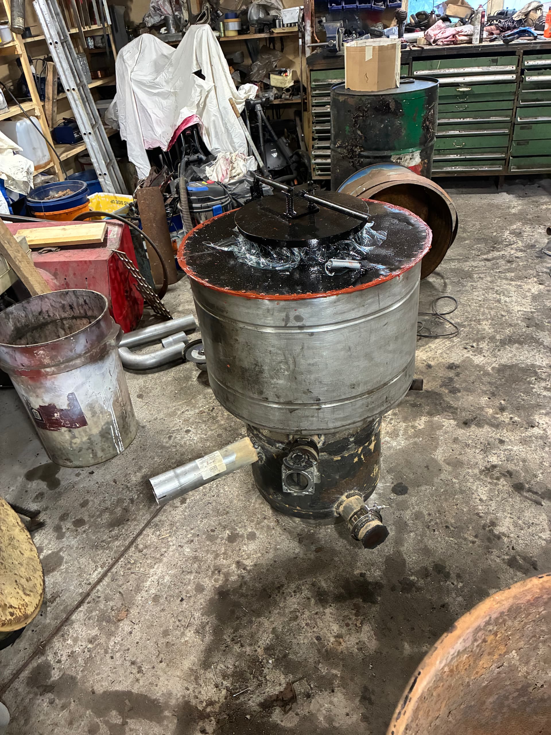

Now I’ve done as you suggested, @JO_Olsson JO, it’s probably good for inspection too, do you have any good idea how I can make the cover?
An oil pan lid is too small, and the rim is very narrow and thin, under 1mm.
Jan, if you can’t find a lid that fits I guess you have no choice but fabricating one. Maybe cut a donut from a sturdy sheet which will in turn fit a barrel lid. In that area welding isn’t necessary. You could just sandwich the donut to that lip with some silicone and a few tiny bolts and nuts holding it together.
My fillerlid’s necks are only “spot welded” to the barrel lids and silicone does the rest. It holds up very well - better than the actual barrel lid metal. I belive it’s important though, to smear the silicone from the outside. Not only because the hopper holds negative pressure, but also because hopper juice turns the silicone to jelly.
Ok, thanks for the answer JO.
I did not know that about the hopper juice, JO. Living and learning. One way I made a filter container, Jan, was to take a metal garbage can. https://www.instacart.com/products/18857100-behrens-galvanized-steel-trash-can-with-lid-31-gal? and slit a length of air hose to fit over the edge of the container. I carefully hammered out the lid edge a little so it would fit over the hose. it sealed and worked for me. I added a couple of hoops inside the can to keep it from collapsing. You could do something similar with your container if you stitch welded a piece of banding around a flat lid and sealed the rest of the joint with HT silicone.
Well, at least the HT-silicone I use becomes soft and wobbly. I use it for filler lid seals, but they only last so long.

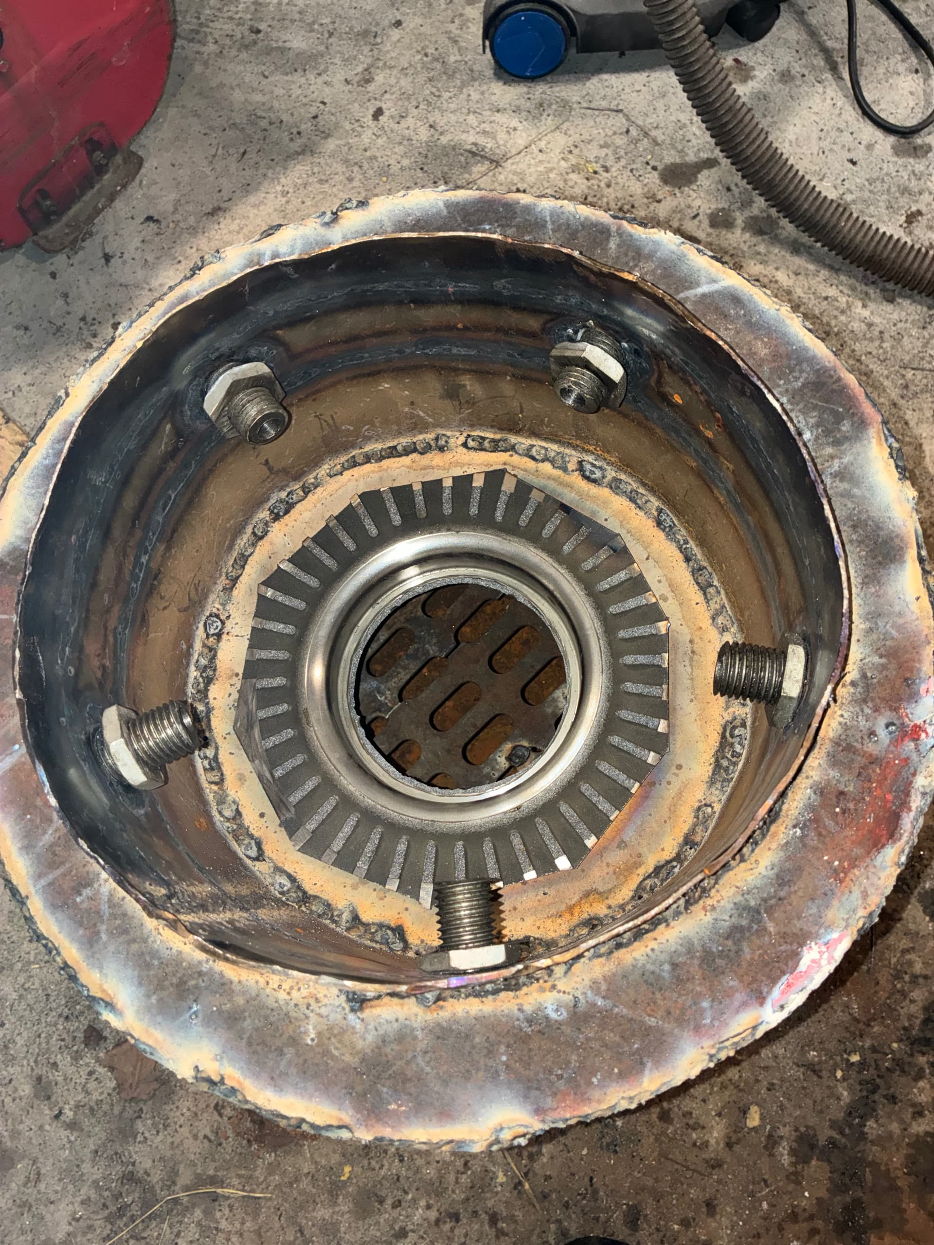

Almost done but as usual I made a mistake, when I welded the edge to the lid I welded all the way, thinking that the thin plate can’t bend that much, well it could.
I’ve tried pop riveting the entire edge, but it probably won’t be tight, I guess.

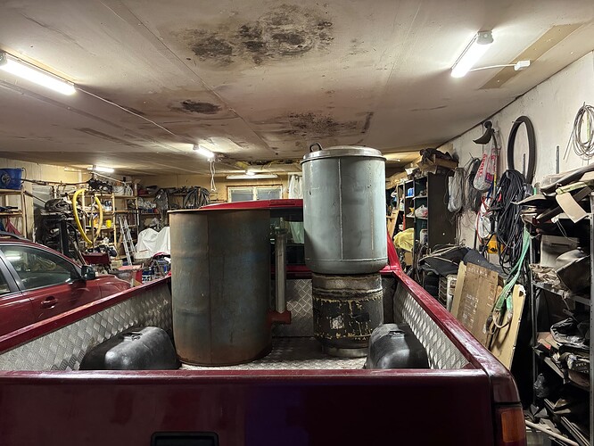

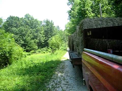

Mr. Wayne, @Wayne I think I saw one of your trucks with radiator pipes only on the front of the bed, if so, does it work well, or is the cooling too poor from the gas.
I would like to have more of my bed left for wood transport hence the question.
Good morning Mr. Jan .
I think cooling pipes at the front would be enough but many times I use more pipes down the sides to camouflage the gasifier .
I drove the below ford farm truck several years with only front cooling pipes with no problem .
Thanks for the reply, yes you can drive this in your climate, then there shouldn’t be any problem here.

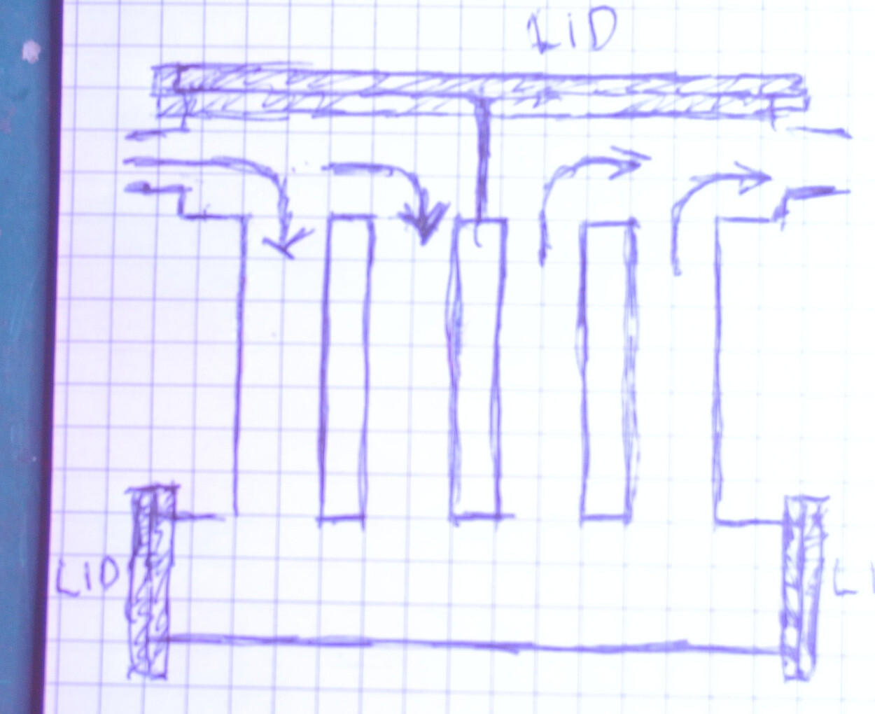

When I make a cooler, how should the air flow?
Through as long a surface as possible or like a regular cooler?
i think that depends on length, number and cross sections of tubes.
better not to make any barriers in lower manifold, they would make cleaning more complicated.
i would make something like this
I make them like your bottom drawing, Jan. The top one may be slightly more effective at cooling and would work if you put threaded caps in the top header directly above the vertical tubes so they could be washed out. You would need both ends of the bottom header capped. Not sure if it would be worth the extra effort.
Good morning Jan.
I have always made my coolers as your second drawing .
The gases will move slower through the 3 passage way. Than with just one passage way of the same length. This will give more time to cool the gases down. If mounted on a car. The same amount of air will flow over the ether set up. But there is more cooling surface on a the 3 tube set up with the gases moving through the pipes with less gas flow restriction.
