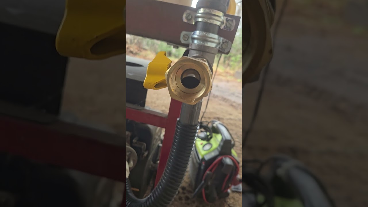

Here is a post of the last run. It ran about 20 min. I was pretty pleased with it for first time run.
I was surprised at the amount of moisture in the filter.
Im starting to make some new charcoal and hope to fire it up again this week end.

Hey Joe , congrats on your run , if it is a flat head then Your Doing ok as they have lower compression than the more modern Chinese clones of around the same size , i have in the past run engines as small as 50cc but you do need to size the nozzle accordingly so that it keeps up the temp and makes strong gas .
With that wet /damp filter your showing in the photo i would recommend you maybe  run some petrol through for 5 mins after shutting of the gasifier that should help dry out the carb and get rid of the fine dust that builds up around the butterfly .

Hi Joe , it is mainly the  carb butterfly that needs cleaning not really the cylinder walls the moisture in the cooler area of the carb is what causes the fine soot to help seize the steel or brass butterfly pin to the aluminum/die cast body .
Yea, makes sense. I’ll clean it next time at the end of run. For now I’ll spray carb inards with carb cleaner or wd40. Appreciate the tip. All these small details make a big differance.

Kudos on stabilizing the mixer valve to the frame, your carburetor mounting studs will thank you! Thanks for sharing.
 Yea. It was great advice. thanks. I plan on bracing the exhaust pipe also. In the video you can see it vibrated loose and was bouncing around. J

With all good intensions i would recommend placing a air filter onto your mixer valve asap , last thing you need is to kick up some of that dirt and dust around the machine  other wise it will interfere with your fun.
