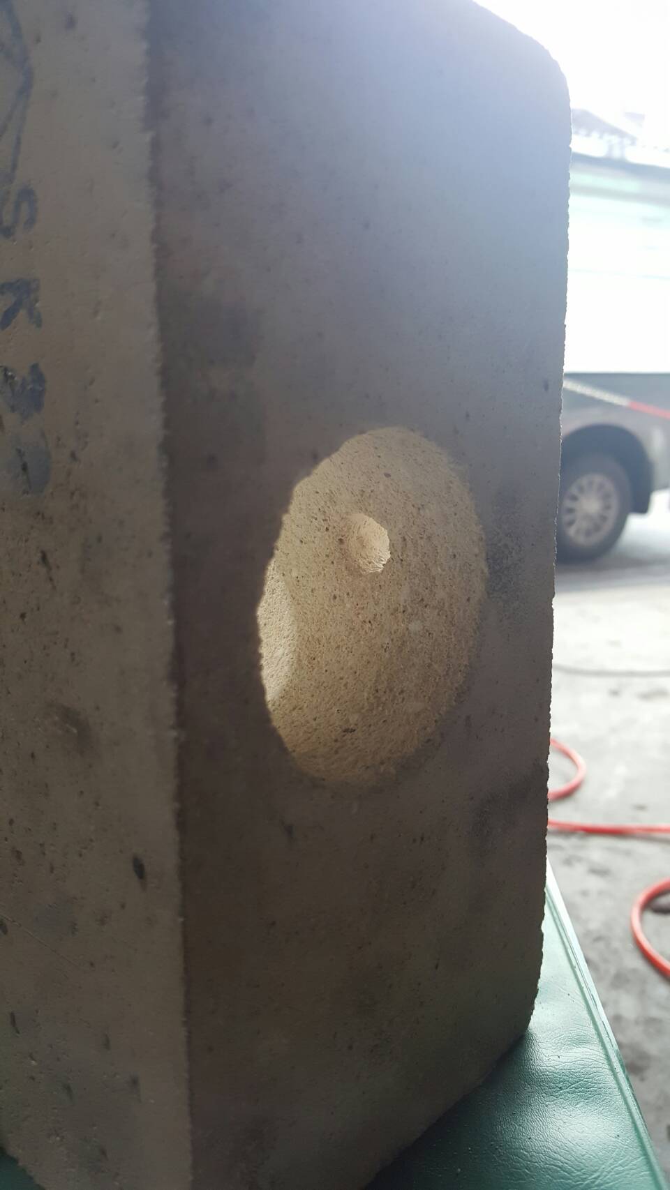

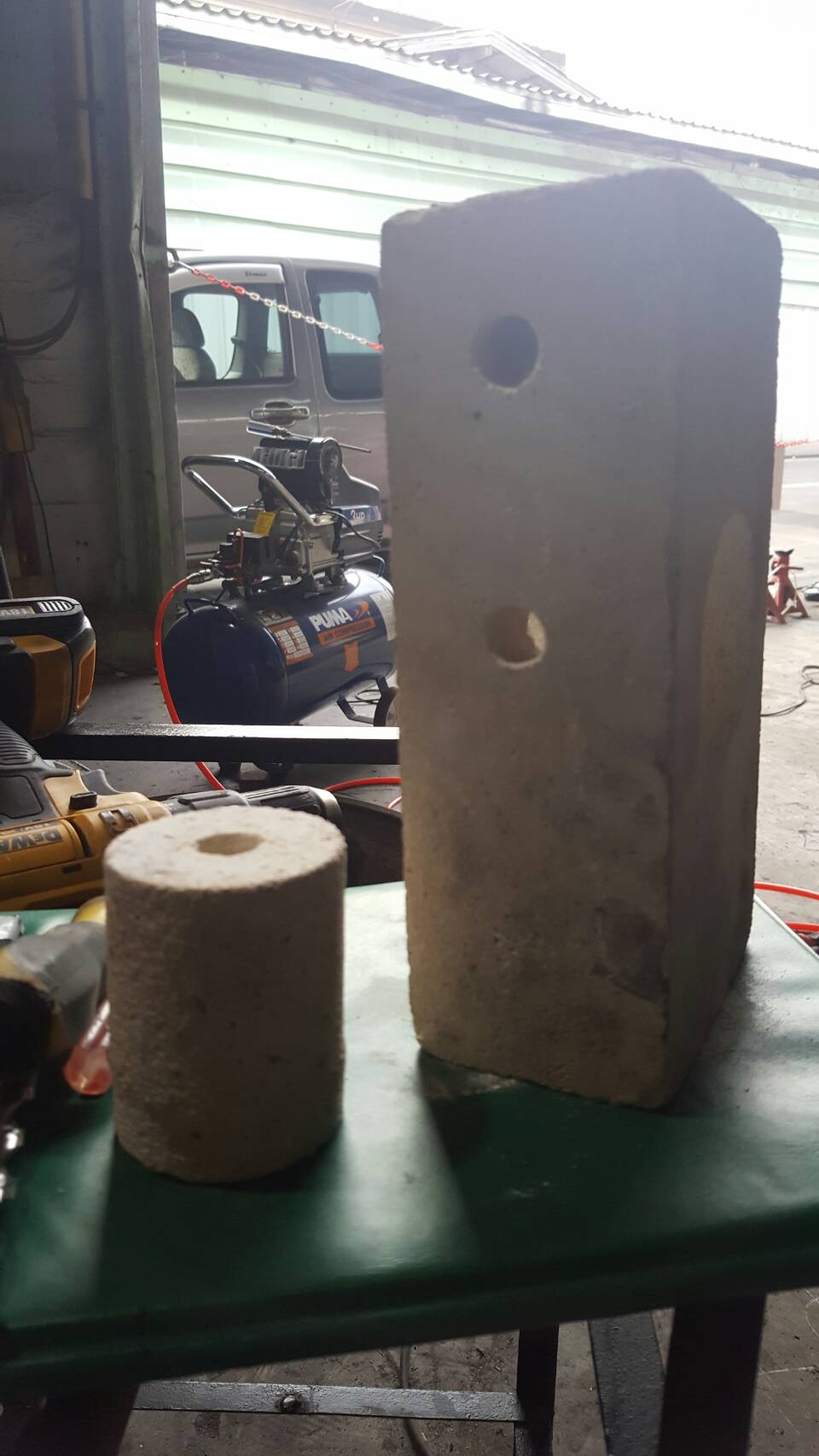

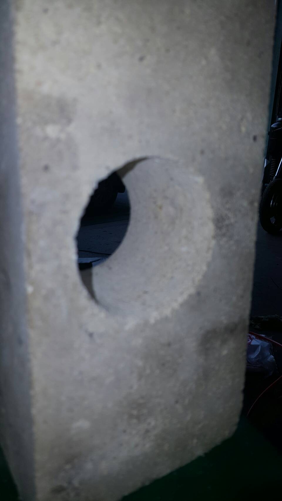

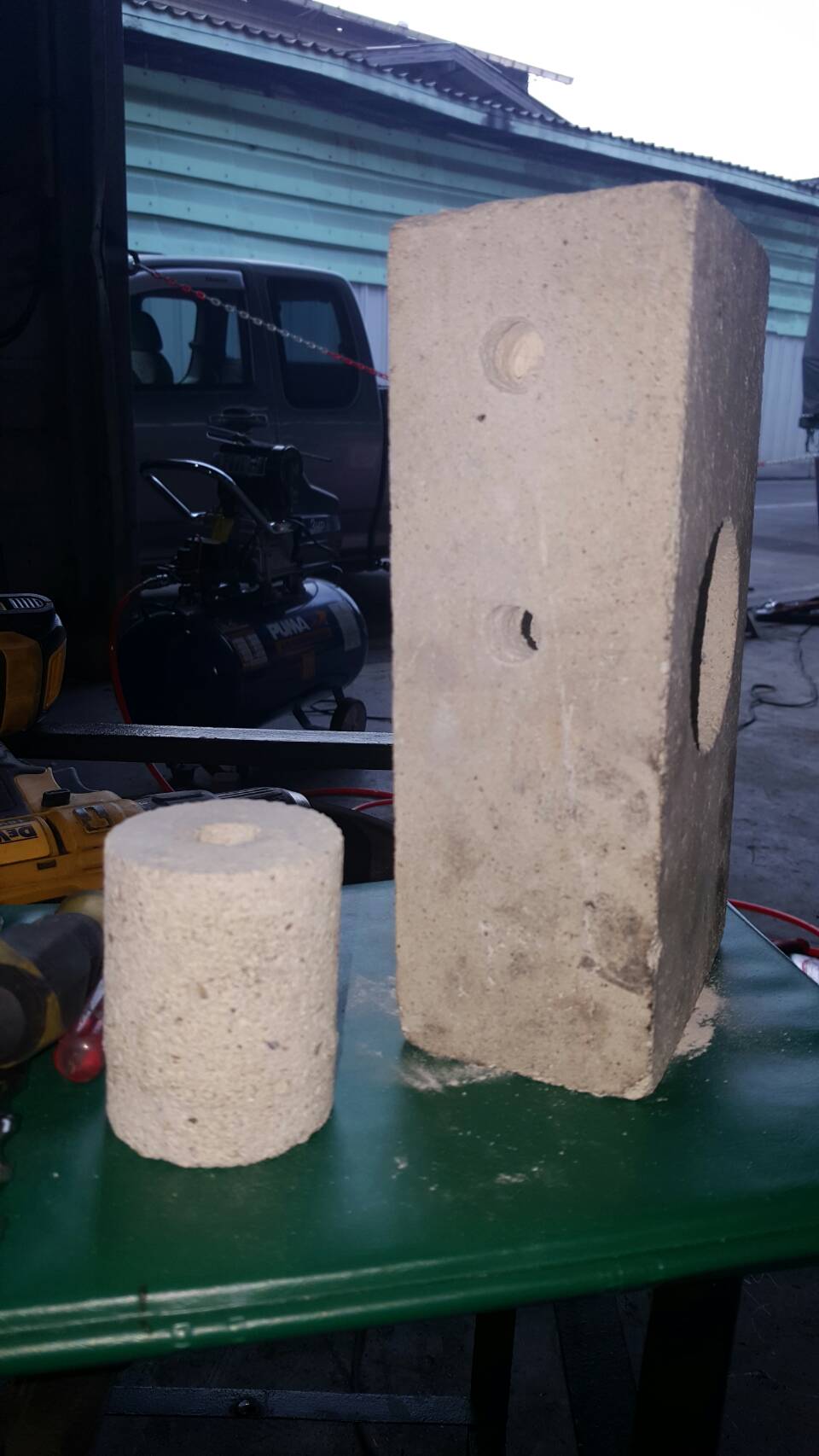

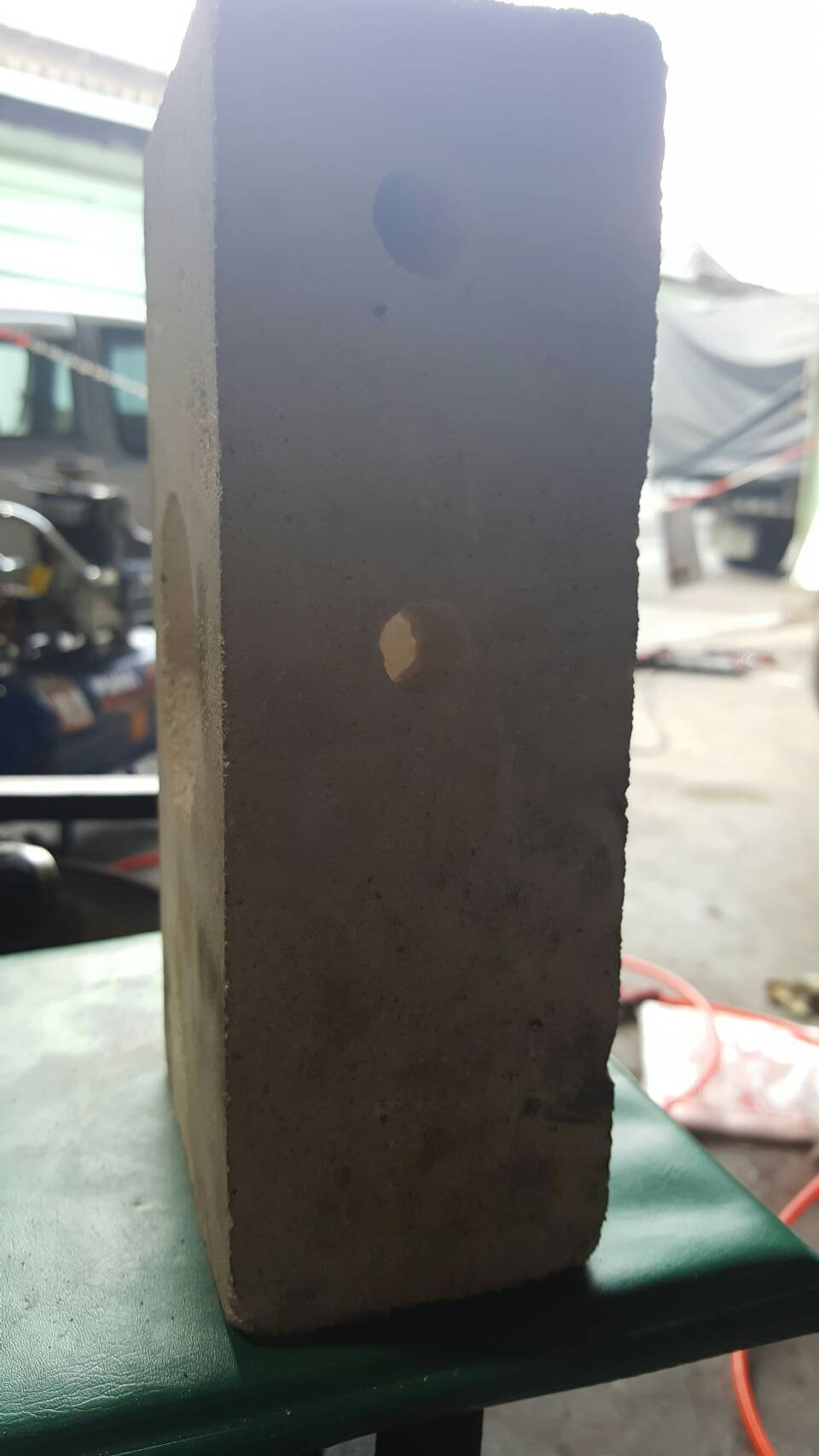

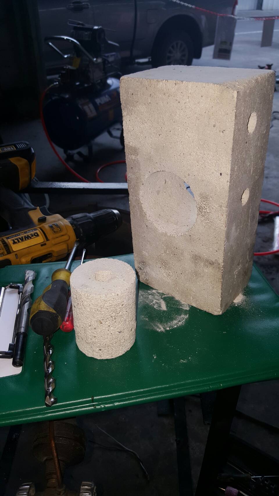

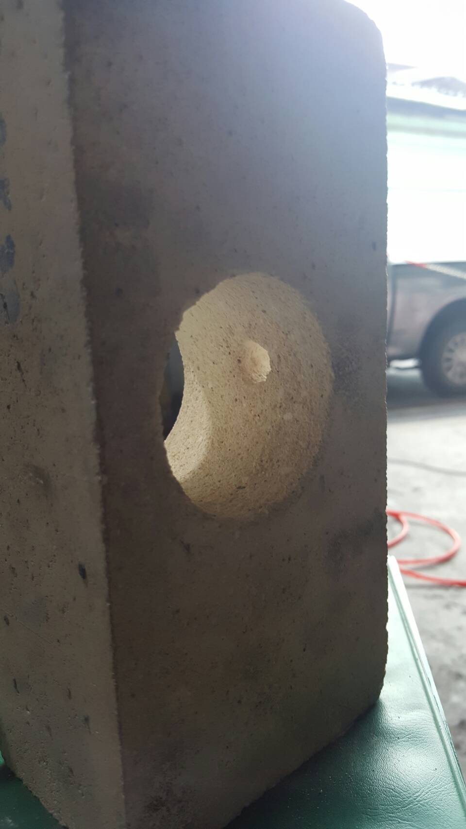

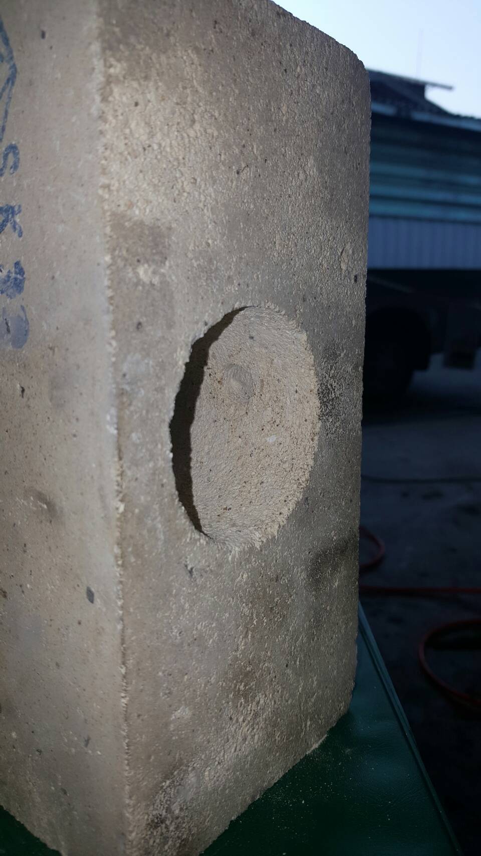

Kicking of with a new idea: using fire bricks to shape them into a nozzle ( using this idea for the large boiler gasifier )
Drilled a 2"1/2 and a few small ones…
No cracks during the drilling, tomorrow putting the block in the oven…
