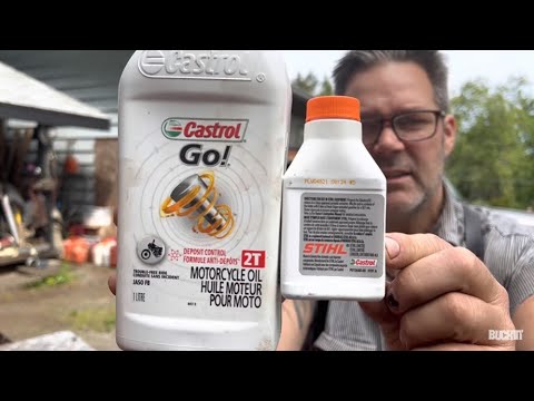

The Ironhorse view on mix oils. Interesting about the Stihl and Husky oils that I always use. I have a whole gallon of Yamalube oil for outboard engine mix that I always wondered if I could use. It’s 25 years old but I don’t think oil has a shelf life.

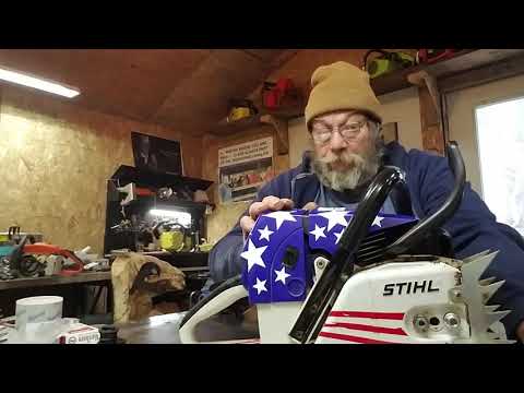

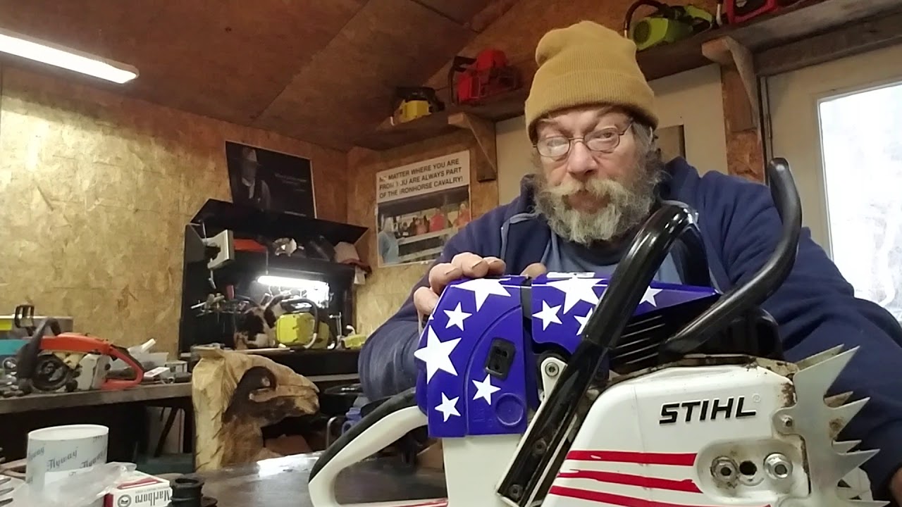

Yep. Gotta have a sence of humor about this stuff:
Yeah! Maybe I’ll go with a B.C. Canada opinion.

We always had best luck with Castrol Super 2 Stroke but Husky or Stihl should be fine as well as Motorcycle oil. Our dealer says that outboard oil isn’t great as it is formulated for a water cooled outboard engine as opposed to the hotter air cooled engines.
I’m a minor league compared to you Darrell. I cut 7 cord a year for my house and maybe 1 to 2 for the greenhouse and charcoal making. For years I took my chains to a 90 something year old guy that sharpened them for 4 bucks a loop and better than new. When he passed on I started sharpening my own but to this day cannot get them even close to factory for some reason. When I was using the Husky a lot I just bought new chains because I get a miniature thrill out of how well they cut compared to my file jobs. I have a benchtop sharpener but only use it if the filed angles get to wonky. Now I’m all confused about using the Yamalube outboard oil I have.
Yes, special outboard oil shouldnt be used in air-cooled engines, it’s made to burn clean in lower temperatures, because outboard engines often run cool due to the unlimited amount of cooling fluid :smiley:
I’ve seen some examples of clearing saws and chainsaws scoured on exhaust side probably due to this.
We also have to take in acount two-stroke oil for outboard engines engines are made to burn much cleaner “disapear” due to water environment protection rules.

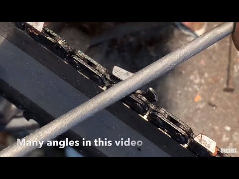

Here TomH.
For you:
I will be changing my own self-learned techniques now having seen this.
I have been able to get better than new chain performance hand filing for about ten years. But maybe too aggressive? I need to refile after every tank of fuel. I will be ditching out of the simple Stilh file clamp guides and try gong free-hand, larger files like he shows.
I hope @Wallace see this one for the many, many McColloch’s this guy shows revering at 3:20. Then performance cutting showing off.
Great video Steve, I learned a lot of good tips.
Boy he is definitely an enthusiastic character all right! Thanks for the video Steve.
That is how I file mostly but rarely have a vice in the field so pick a flat stump and get behind the saw and lean on it. It takes a bit getting used to filing right and left hand but it works really well. In my experience most hand fallers are not great at filing because they carry spare chains and machine grind them at the end of the day.
A tight chain helps prevent the tooth rocking around. Generally he has a nice long straight stroke which is what you want to aim for. I don’t agree with his rocking the file up and down, I use about 10 degrees down with a 7/32 file on 3/8 chain and 1/4 file for .404.
His chain was pretty dinged. You don’t want to file lots on the really bad teeth and leave the others alone.The dull tooth is back from the rest and not cutting anyways so you have to bring the rest back to it. I would take 12 or 16 light steady strokes off each tooth and cut for a bit then take probably 8 strokes and then 2 or three after each fuel up to keep it sharp. You want each tooth to be identical to the next and everybody pulling their weight. It is tough if you just dull one side, then the saw wants to " draw" or not cut straight down and binds badly too. In that case you have to really file down the sharp side to even things out. He only touched on it but a sharp file is essential for a sharp chain. I too run into the problem of one or two really hard rakers or even teeth on an occasional chain. Sometimes it will clear up once you file through the hard spot but usually wrecks the file. I usually tap the file on the bar after every tooth to clear the filings if it is wet out and they are sticking.
Sorry for the long post but that is my two cents.
No reason to apologize Darrell. We all have to use saws to cut wood. May as well be as efficient as possible with them. The voice of experience is priceless and I’m not paying a penny for it.
